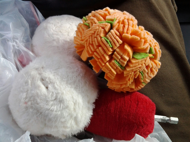

After you drum sand those ribs on the covers, you may need to wetsand with 400, 600, 800,1000 and like 1200. Then you get some Mother's Mag & Alum polish and chuck one of these polishers below in a drill or your drill press and polish away. Same with the ribs on your wheels. You wetsand thru the grits, and after polishing they'll shine like glass. You can spend like 3-4hours per wheel, but its well worth the effort.

I've done some motorcycle wheels that way. 220, 400, 800, 1200, 1500 grit till your fingers fall off.
But due to the limited space on those wheels I use 2" cloth buffing wheels on a die grinder using jeweler's rouge. I'll investigate those buffers you reference. Thanks

Sounds a lot like a knife makers typical day LOL!
Look for a sewn muslin wheel or even a sisal to start with the rouge. They will get in small areas and "get with it"!
