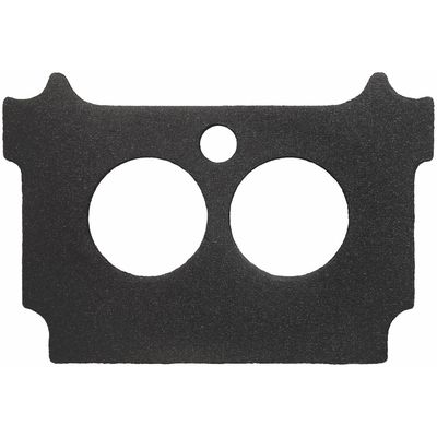

Carburetor gaskets are on dry - they are in this order.
[Carburetor]
[Paper Gasket] ->
[Spacer] (Firm rubber/cork-like material with SOME play)->
[Insulator] (Hard plastic)->
[Paper Gasket] ->
[Intake Manifold]
When I said I used RTV, I was referring to the intake manifold gasket itself, not the carb gaskets. There is a spacer and this insulator (as seen above) and the little bowl on my carb would hit the intake manifold without it being on there. So there should be ample space between the manifold and the carb.
