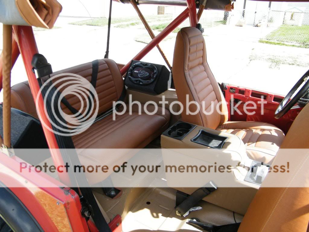

Here's a pic of mine using the RAPTOR liner. I got the clear and mixed it with an original 84 color. "champagne metallic" if I remember correctly. Easy to spray on and it's held up great for 3 years now.

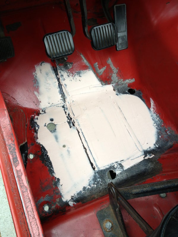

Here are some pictures of the progress I've made on the floorboard. Putting on the last layer of bondo and sanding down this afternoon. I'm not sure how well I'll be able to match the grooves with my dremel.

From past experience: If you use bondo, make sure you treat the metal underneath with a rust inhibitor like Metal Ready or other Phosphor Etching stuff. Otherwise rust will thrive under it and your bondo will peel and crack faster.

@kastraelie Thanks. I did spray some rust stopper on the rusted areas before spreading the bondo.

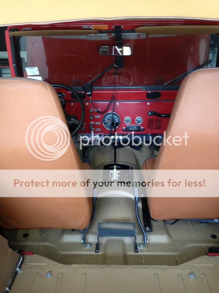

Shooting the Raptor. IMO, a lot better then the roll on liner for the ease of application/looks.
Well since 2009 in the sun there is no fading. Good stuff.
First coat shot and out in the sun to bake
Having fun
Touch up out in the sun so I could see better
Finished, removing tape
