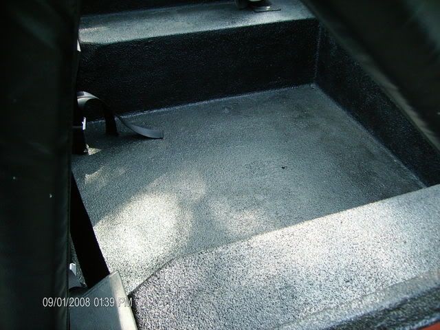

Originally Posted by metal123123 View Post
full exterior U-Pol. Great product imo.
Got any clean close-ups of that? It looks good as is, but how good does it look clean?
Thanks
I've been married so long I don't bother looking
both ways before crossing the road.
(Trial + error)*Upgrades) - $ = (mac-n-cheese/hot dogs)+experience
turpehar is offline
post #103 of 352 Old 11-03-2008, 12:14 PM
metal123123
Location: winnipeg
Posts: 293
Clean
Close ups of texture. I wanted a thicker texture, just my taste
metal123123 is offline
