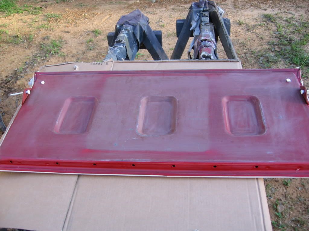

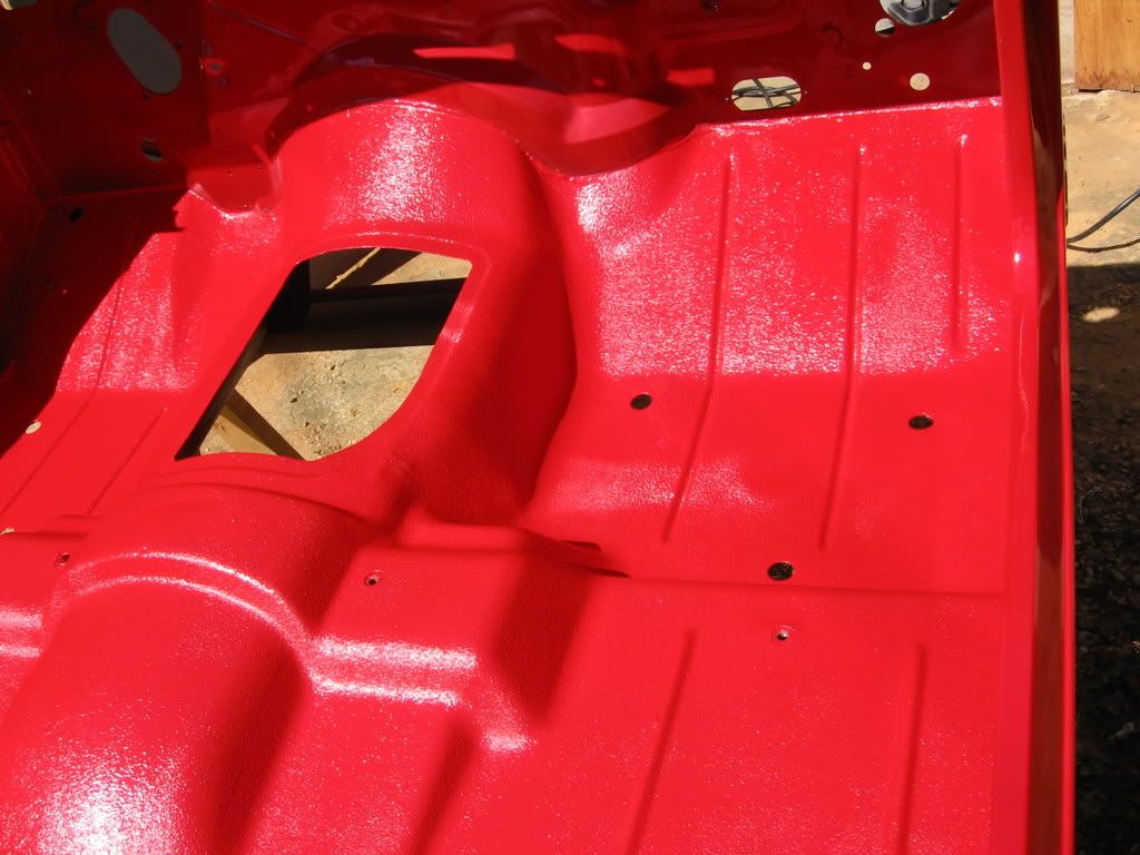

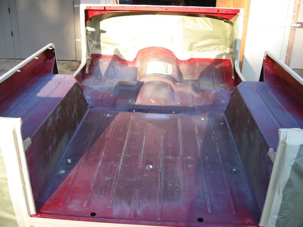

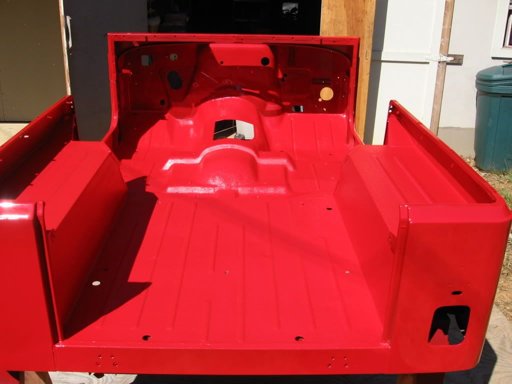

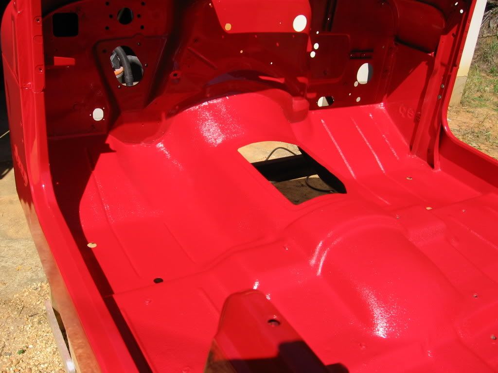

You need to post those pic's here cause that's a great example of how a pro job looks. What kind/type/brand paint did you mix in, and at what ratio?

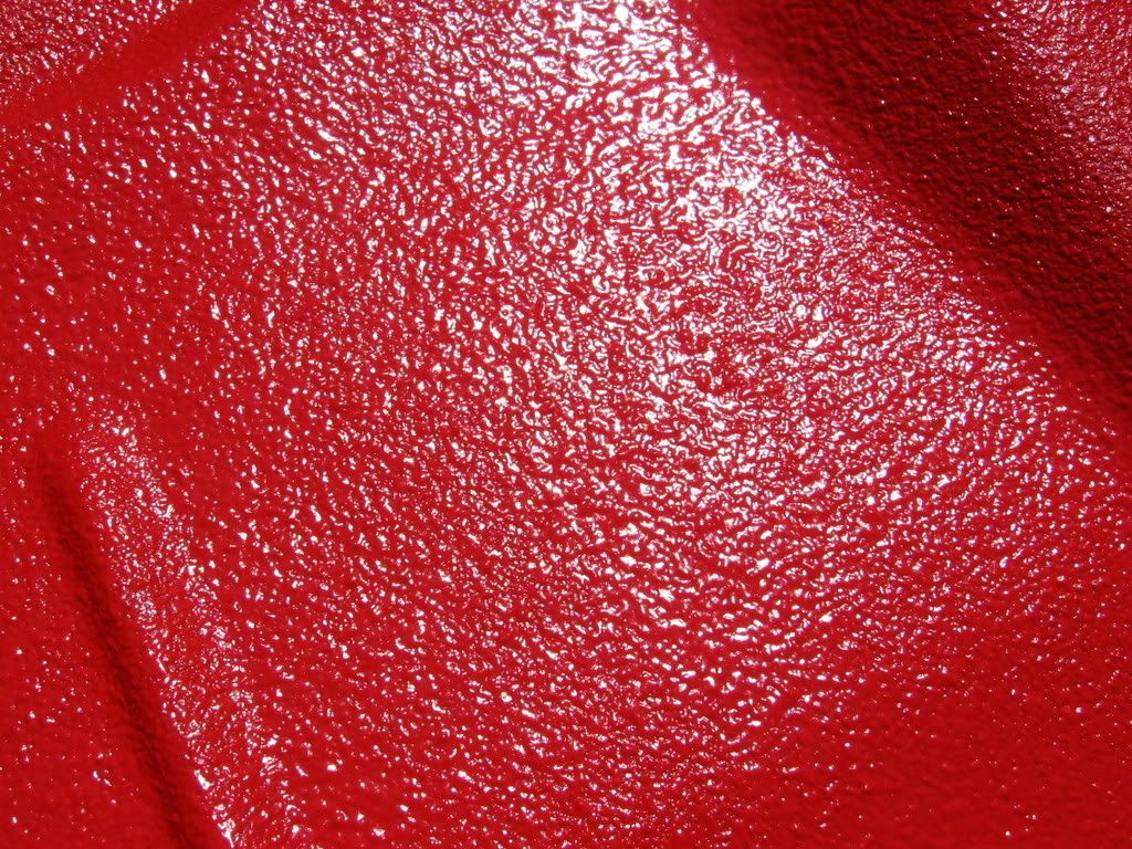

turpehar, Thanks for the compliments. I went into some detail in post #72 I think it was but to answer your ? It is the cheaper omnie automotive paint ith no clear and no binder. The ratio is 4.1.1 that is 4 of the gray bedliner material 1 paint and one activator. I did three pretty heavy coats with half a gallon. Oh one more thing I thought you were going to post them for my lazy ARSE. I'll have to work on it. JC

Turpehar, thanks for the post up. Neat to see my tub on ciber space. When I get it put back together I'll post some picures of the process. This stuff is super easy to shoot. If you want to practice go buy some under coating an a schulz gun and spray the fender wells of your jeep. The SEMs is very forgiving and drys pretty fast. I sprayed it right where you see it and bugs weren't a problem. The color actually matches better than the pics show. The texture makes it look alittle different. I would recommend this to anyone wanting to color match the exterior and wanted a medium grade of protection from the elements. It will scratch if your try hard enough but it fit my bill perfectly. Thanks again jc
