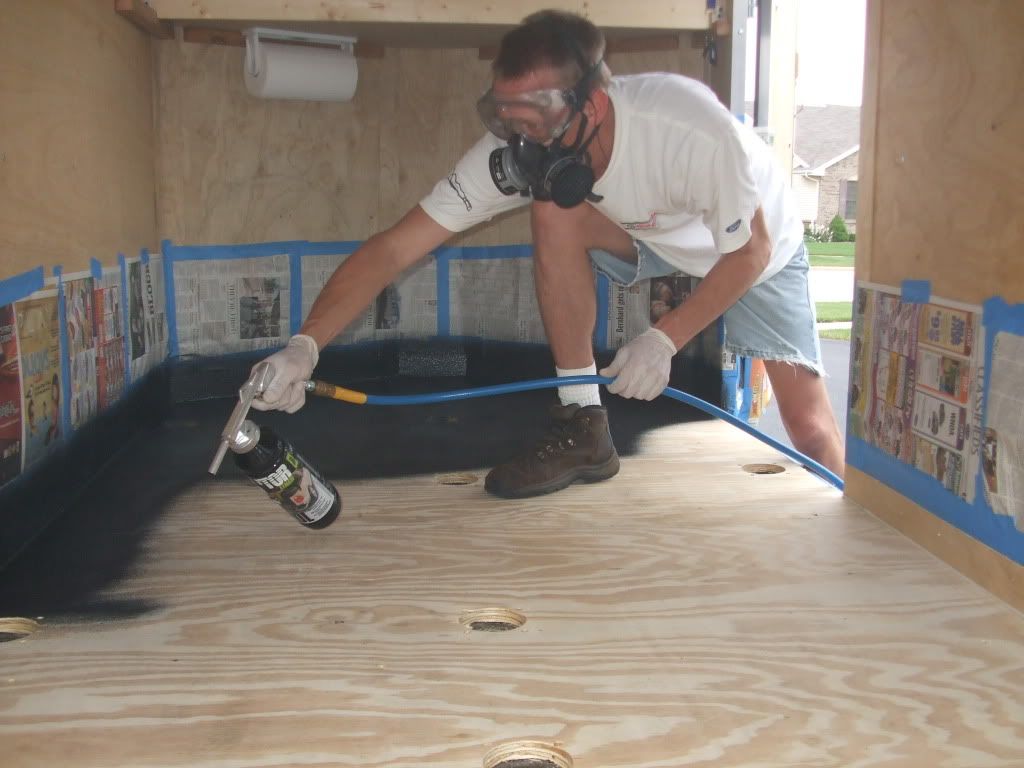

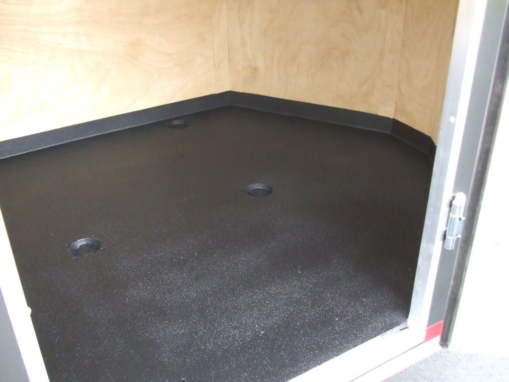

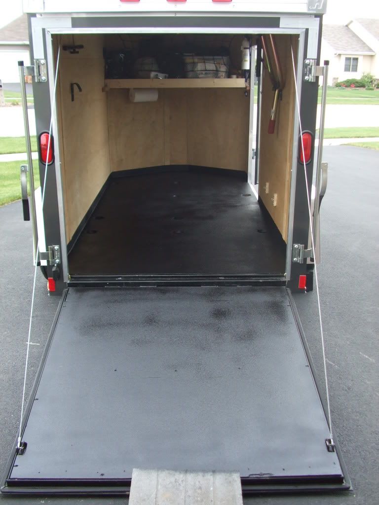

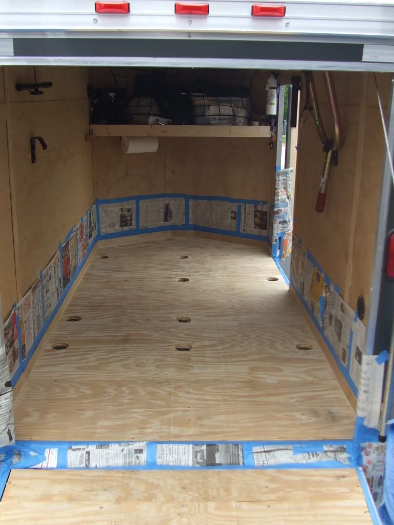

I know it's not a Jeep but figured I would post it up anyway. I talked my friend into using the U-Pol as a floor liner in his trailer. This gave me the chance to see how it is applied and get a little practice with it before I apply it to my Jeep. We took everything out of the trailer that was mounted to the floor and gave it a quick once over with a 150 grit pad sander then blew it out with compressed air. We just taped off the lines with blue painters tape and applied one row of newspaper to catch over spray.
Laying down the first coat.
We ended up using 5 total bottles of material which gave us two pretty good coats. In hind sight we should have went just a bit thicker and used 6 bottles but either way the end result looks really good.
After the first coat you could still pick out a little bit of the wood grain under the Raptor but after the second coat it had complete coverage and looked really good.
In all the Raptor is very easy to apply and had minimal amounts of over spray. Now I have a better understanding of the product and what to expect when it comes time to apply to the Jeep.
