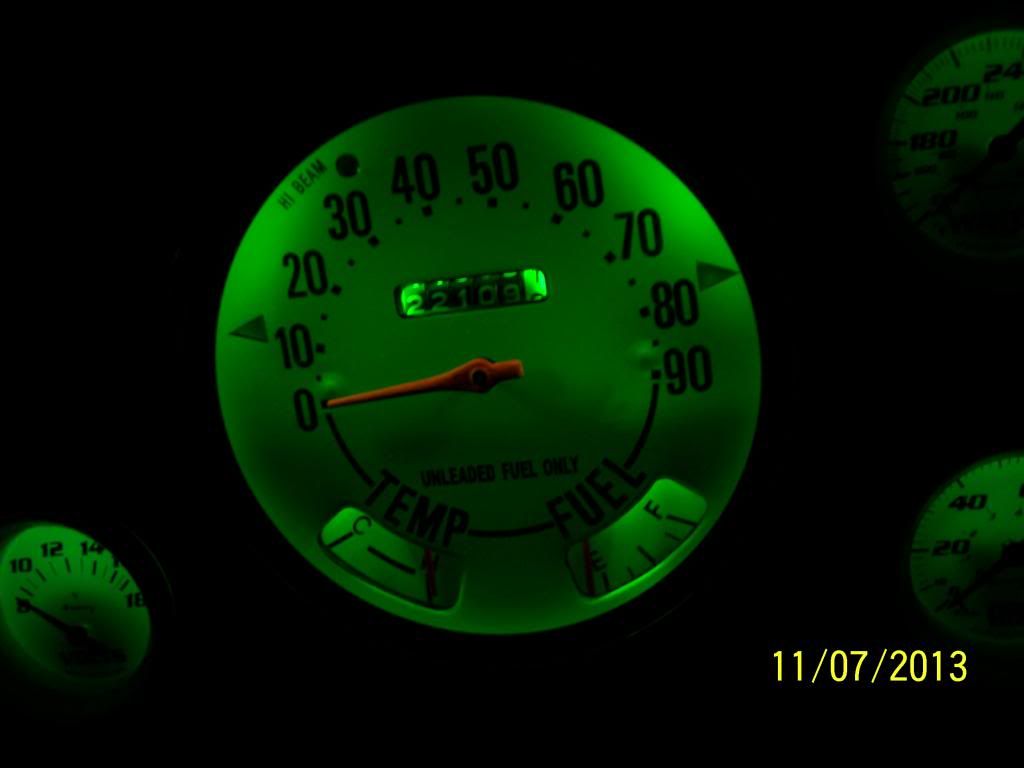

Got a picture of my white face speedometer lite up. Not a great picture, but my camera didn't want to take a picture in the dark! I had to get right up on it to get it to take.

Looks fricin awesome. I talked to white gauges.net. They are gonna make me a custom one.
