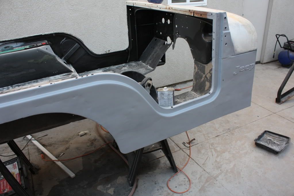

OK, I've decided I hate body work... but things are getting closer... I think I'm going to leave well enough alone on the passenger side... I plan on covering the rockers up with rocker guards anyway, just wanted to smooth things out a little. I have been using some metal based filler and have been thinking maybe if I get some bondo, maybe it will be easier to work with... I don't know... my boss was in body work a long time ago and he gave me some pointers so maybe the drivers side will go better.

Bill you've got that tub looking better every time you work on it! If a few imperfections don't bother you I wouldn't worry about it. Glad you didn't fill in the gas filler recess. Keeps some of the original look to the tub. Great Job

Don't get discouraged, the worse that can happen at this point is you sand it back off. so play with it, have some fun, and see what process works best for you. Remember with body work theres a hundred different ways to get the same result, what worked for someone else may not be the best way for you. Enjoy it and don't think of it as work, and your patience will get you allot farther. Doing good so far, keep it up.
I think you are almost there and a good skim coat on the entire side and block sanding with an 18" block will smooth out most if not all the dents.
You might consider lightweight filler. I used Everocoat's basic lightweight filler for the first time on my daughters truck and it is much more forgiving than the old Bondo brand filler I used back in the early 80's.
It is looking great

After walking the kindergarteners to the fire department then back to school, I got to work...
I went to the Auto Paint store and explained what Dave said I needed, and I ended up with
and
by the way, I started with this:
OK, This is killing me... 2 steps forward and 3 steps back, but I think I am on the right track. Here is the passenger side after reworking it a bit today.
Here is the drivers side with the first coat of the base and a coat of the self etching primer.
You guys are way too kind, thanks for the encouragement!!!!
