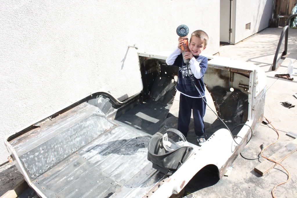

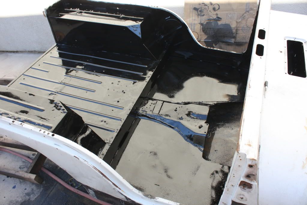

Project for today...
Got a little help from the sick one, I guess he is ready to go back to school...
time for lunch and nap, so I gotta stay quiet... here is what I got so far. It has been going good... that black stuff seams dryer on the inside so it has been coming off easier...
... I guess I'm gonna have to fix that too…….

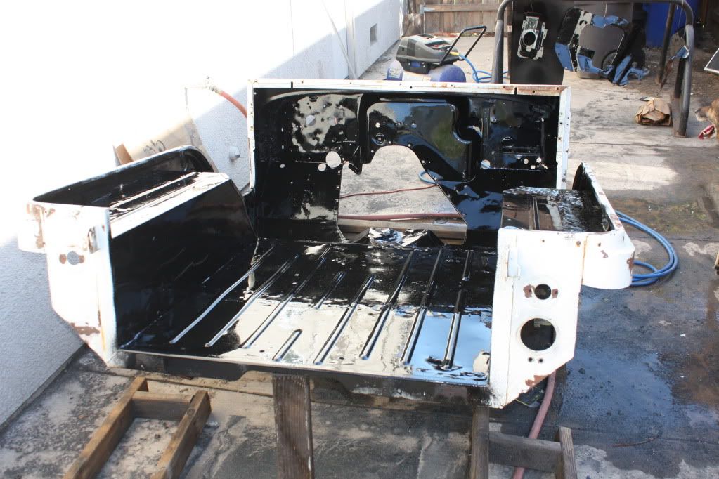

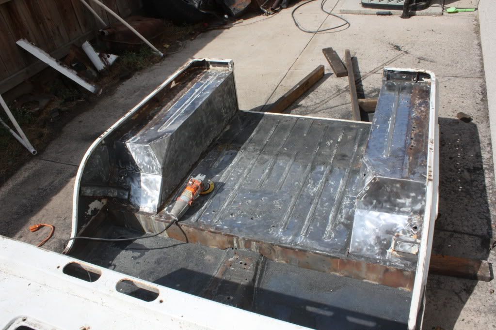

OK, done with this body... for now anyway...
This coat went better than the underside... I think I figured out how to use the stuff!!! Once it dries, or most likely, next week I'll put the body on the frame and start putting things back together... then Upol Raptor...

Wow, the bottom of the tub came out great! Did you put a topcoat on the POR or plan to leave it? Between the POR and the Raptor inside the tub, you'll never have to worry about rust again. Looking forward to the finished product.

Thanks!!! I'm not gonna topcoat the underside. It should be fine. I might use flat black in the engine bay and wheel wells... not too keen on the shiny black look.

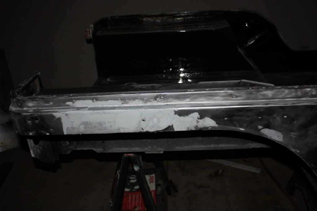

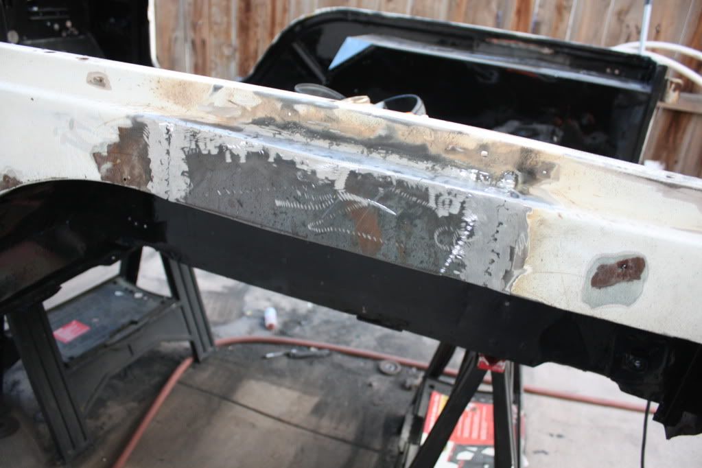

OK, so I haven't had much time... now the wife is sick, and the other kid is sick, plus more OT, but today while the boys were at school I did a little body work... this is the only before pic I had but you get the idea...
After... not great, but I will end up using some filler... what??? The PO used it like it was going out of style!!!
I was going to flange my insert, but I forgot in my haste (was excited, haven't melted metal in a while), so I burnt that little half circle on the lower left edge... screw it... more filler!!! Will flange the other side.

Sorry your wife and other child are sick. That looks like a pretty good patch Bill. Little filler and you'll have it. Hey you can fix that burn through at the bottom pretty easy. Get a piece of copper and clamp on the back and you could fill that in without much trouble, might be more apt to hold than bondo. Keep up the good work man and hope the family feels better soon!!

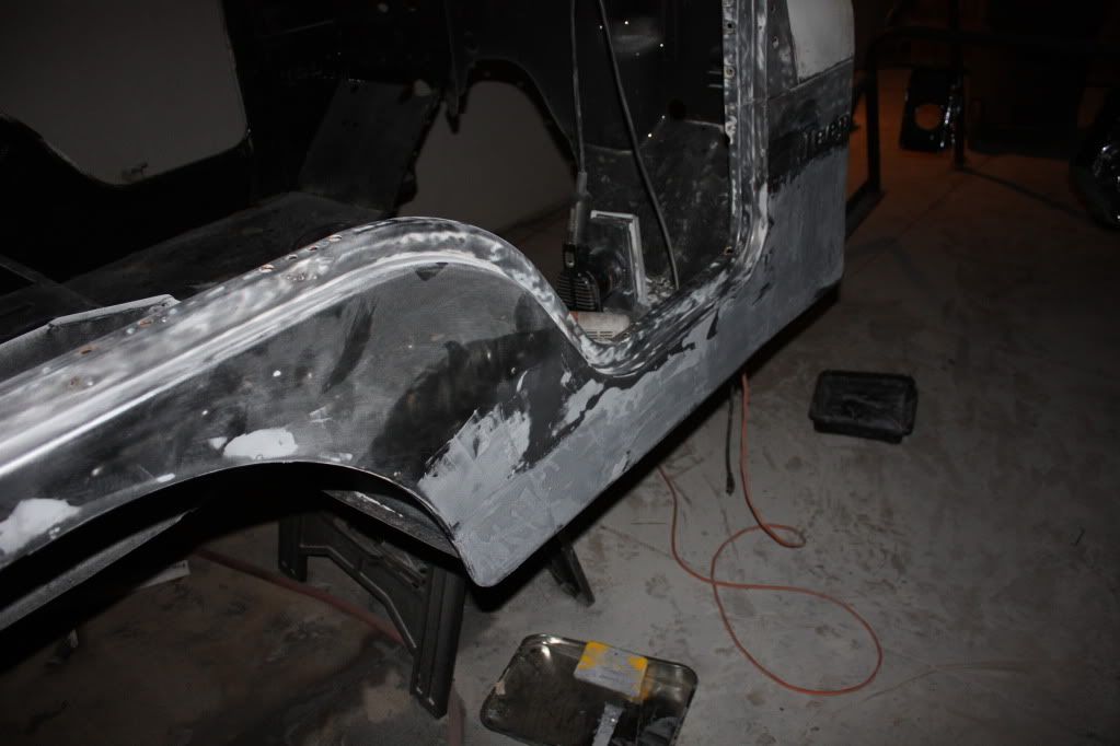

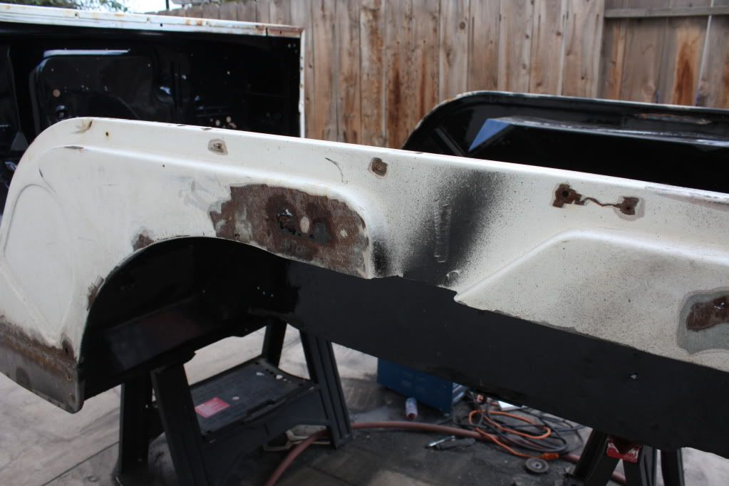

AAAAaaaaannnnnddd the other side....
This time there is a before:
And an after:

Jim, thanks for the idea with the copper!!! I'll try that next week, wish I would have seen that earlier!!! I flanged the pieces this time, but I couldn't get it in... so I started to try and bend it in the middle to slide the sides in... I bent it all right... the picture doesn't show it, but there is a little bulge in the middle of the piece on the side.
I'm half tempted to cover the tank indentation... although it will test my welding and fab skills!!!! What do you think???

You're welcome Bill. I'd say you're up to filling the tank indentation. Go for it. If the first try doesn't suit you you can always cut it out and go again. Since you've thought of doing it you might as well.
