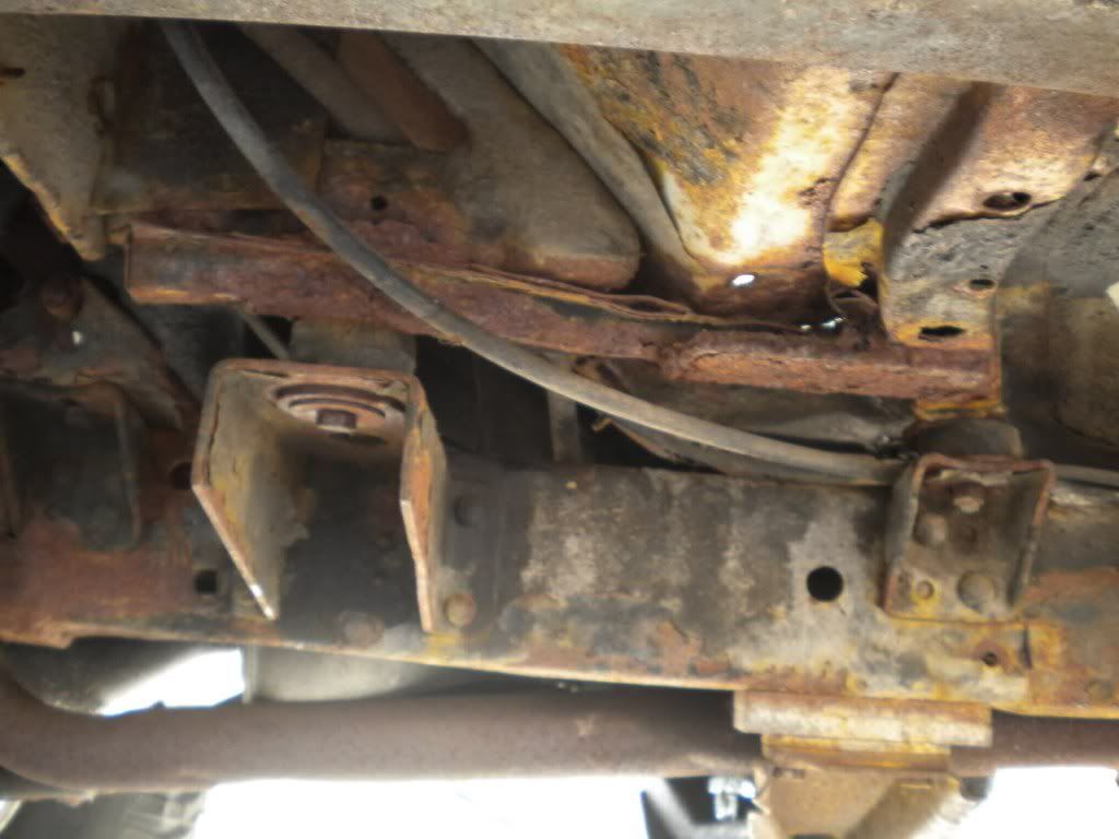

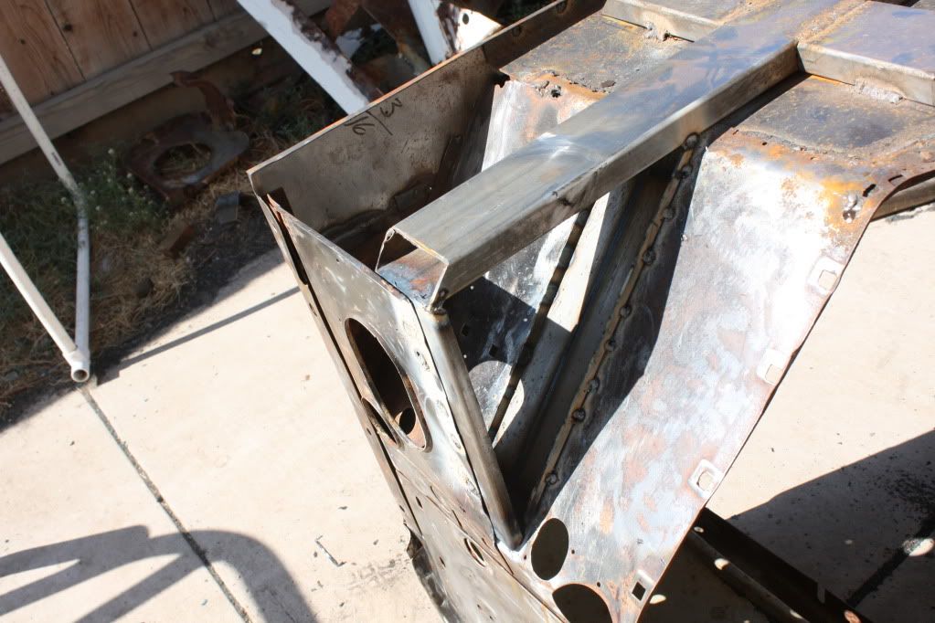

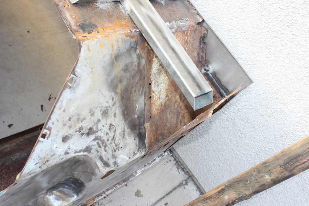

looks good so far. Please tell us about the frame you welded to the bottom.
cjdogtoy is offline
post #32 of 585 Old 10-03-2010, 08:27 AM Thread Starter
SonicR1
Location: CenCal
Posts: 1,513
CJDOGTOY, If you look at the pics on my photobucket, you will see that the channels under the jeep were rotted away pretty good. I tried to salvage them but in the end, it was just easier to get new ones. Somewhere between being cheap, and trying to reinvent the wheel, I decided to use 1x3 rectangular tubing. I figured it would be stronger than the OE channel, and I got 2 4'x4' sheets of 16 guage sheet metal and 20 feet of the tubing for $80 (all the OE style channels and floor would have been somewhere around $300), plus I needed to do something about the triangle supports at the firewall... I also used the tubing for the frame support in the bed, since the bolts busted in the captive nuts of the channel and that channel was mostly rust too!!! Looking at the other supports in the bed, I was thinking about replacing them too, but I'm at the point that I see what I am doing to the body is a temporary fix until I decide to get another tub... you know, putting lipstick on a turd.

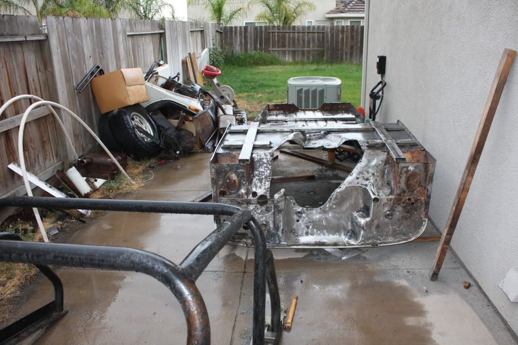

While at work, it started raining... i was thinking craaaaap, I wish I would have POR'd yesterday and I left a bunch of tools out. I ran home and my wife had already put my tools in the garage... I've got an awesome wife!!!

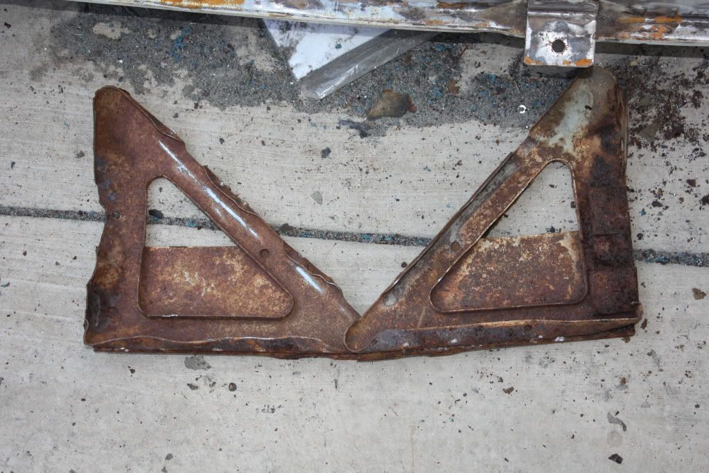

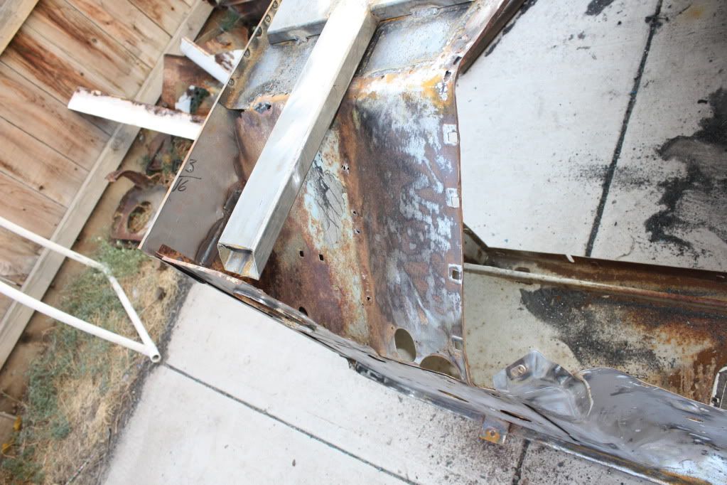

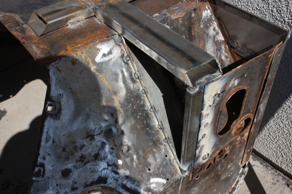

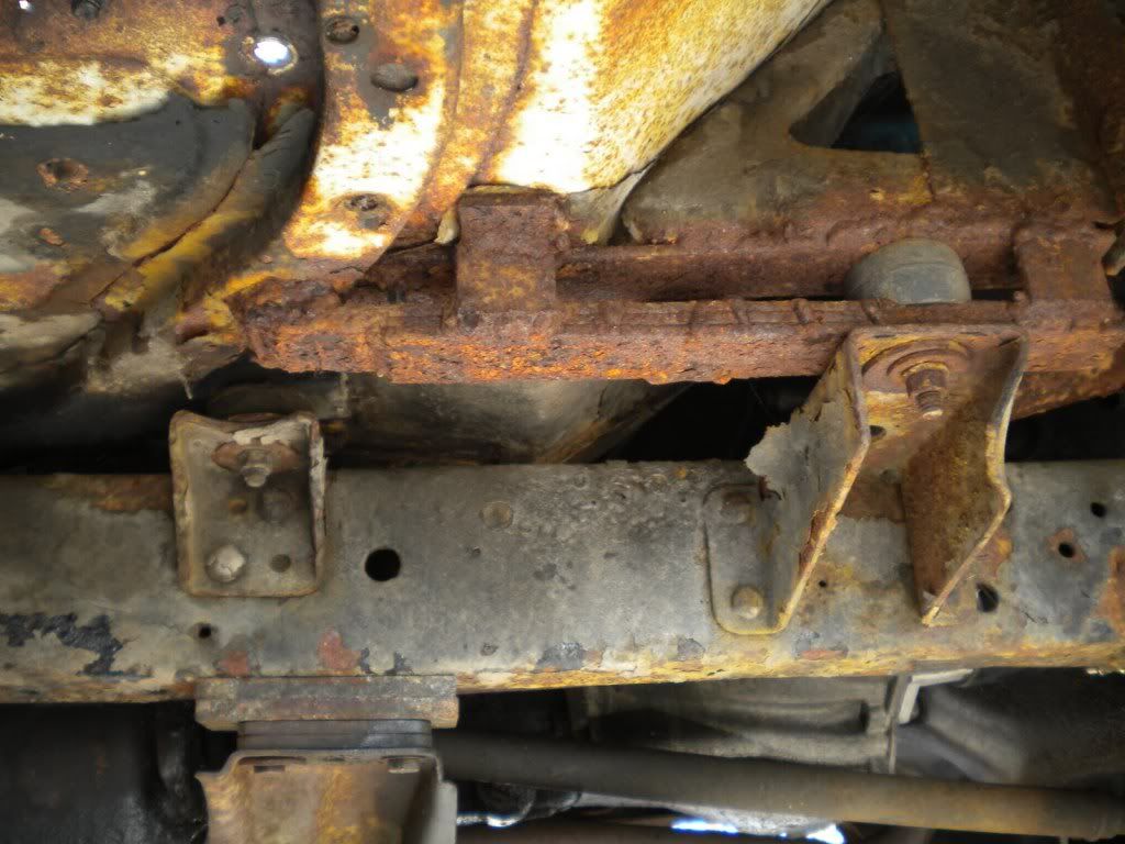

Had about an hour tonight so I decided to try to fix something that has been bugging me... This is how the PO fixed whatever issue he had...
I decided to get rid of them, and I will use the 1x3 I have left to brace that area...
Is that a spring pack he turned into a body brace?
I can't believe you decided to save that tub. Wow.
That is like 1/4" weldable steel, probably from OSH... I can't figure out why he would put the bushing in there!?!?!?! That thing was freakin solid!!!
I was close to trashing the tub and buying a fiberglass one, but I thought I'd give this a shot... but it's also why I just started cutting stuff off!!!

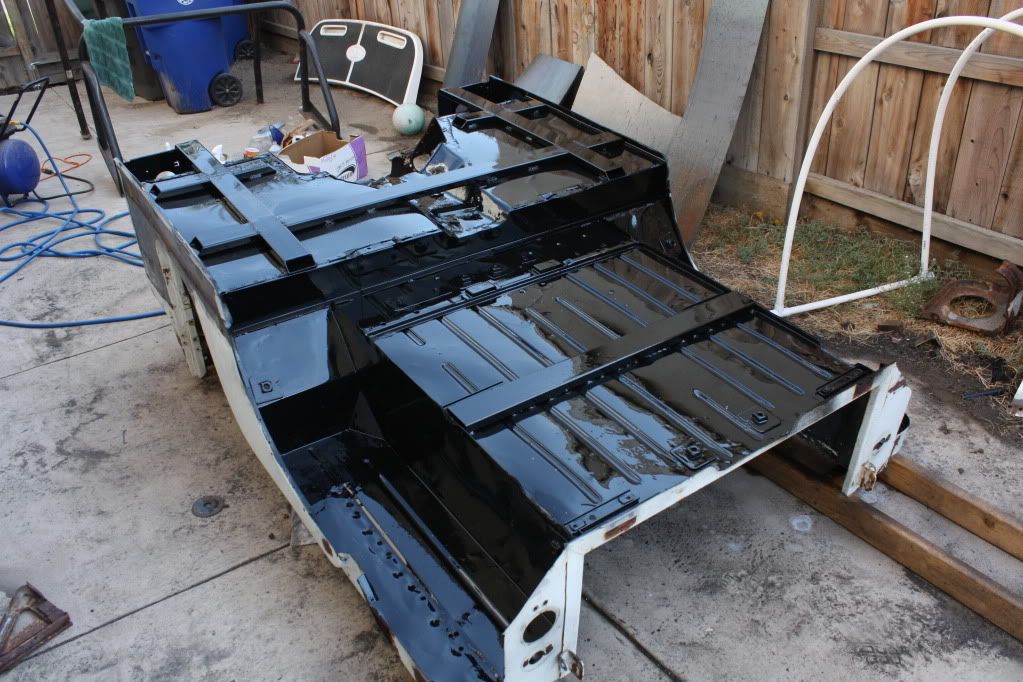

OK, here it is... I think I rushed it, and I'm not too happy with the results... I think I will spray it one more time, maybe tomorrow, we will see...

It never ceases to amaze me what a nice new coat of paint can do.

Welllllllll, ummmmmmm yeaaaaahhhh, it just started raining... The body is still outside, and I'm not home to do anything about it!!!!!!!!!
