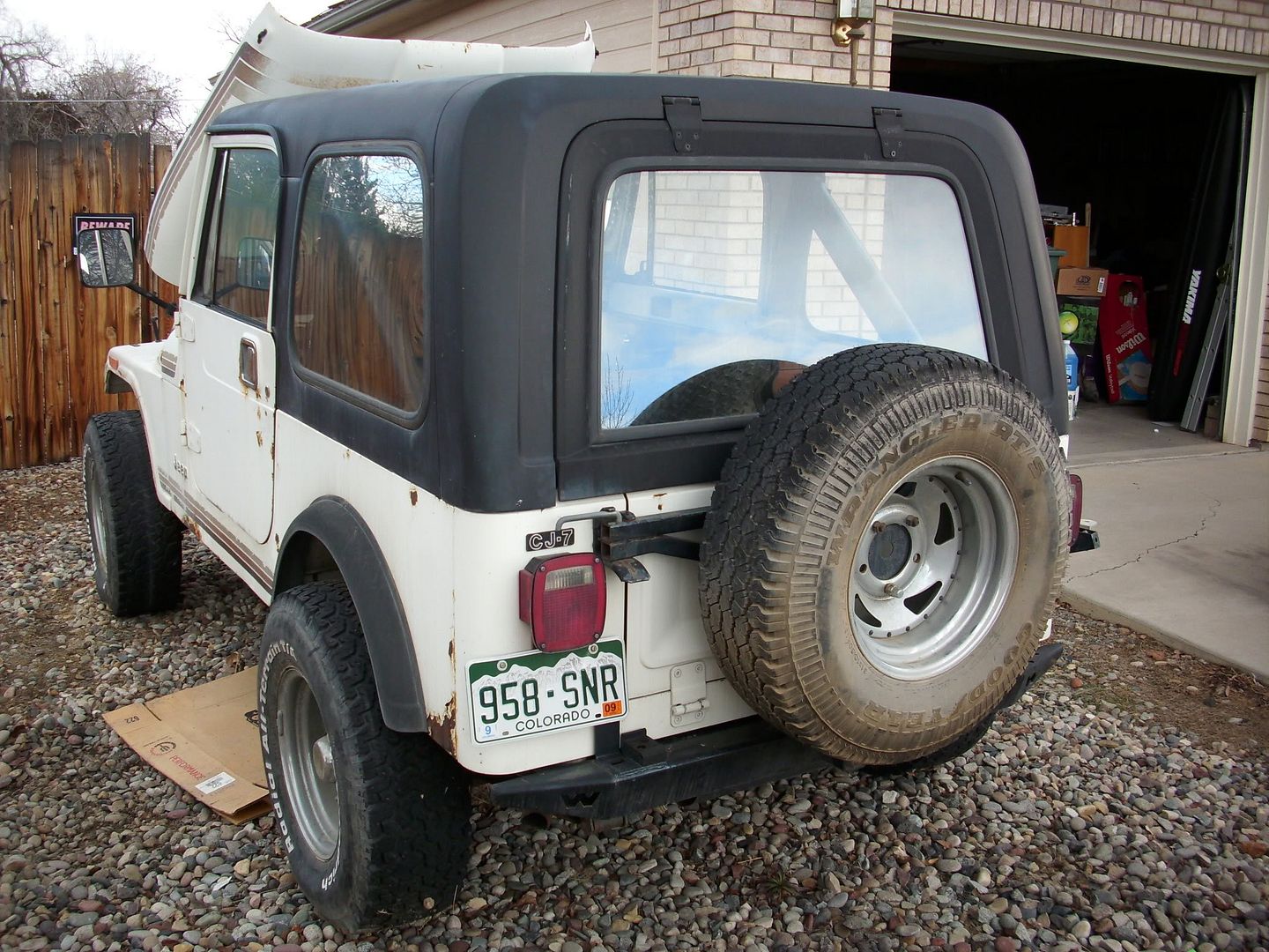

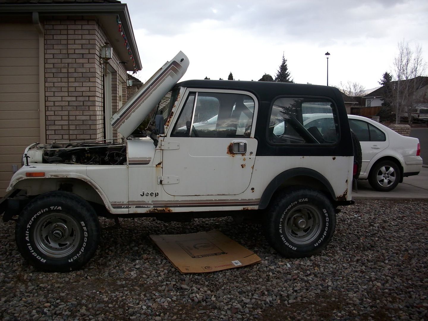

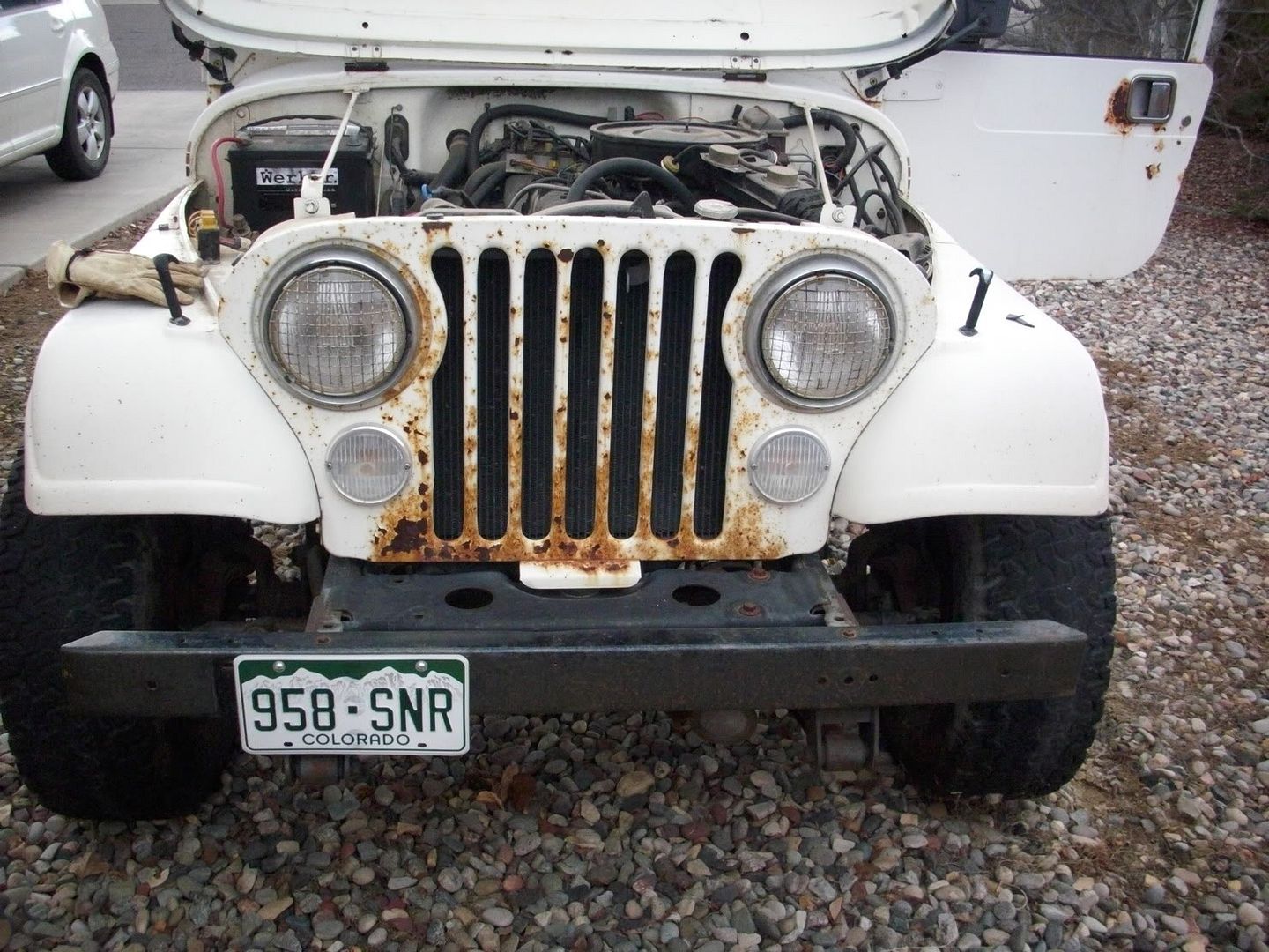

Here's what it looked like when I first started working on it:

Initially I ground out some of the surface rust, and then used some walmart primer and krylon paint to cover em' a year later the primer is falling off and the rust is back. lesson learned.

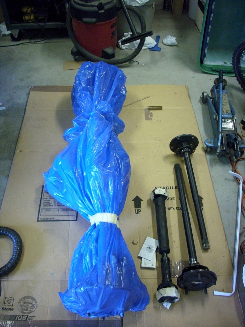

picked up all the stuff today from our buddy... "giftwrapped" for my birthday... well, maybe not
AMC20, sleeved with 1/4" thick tube, trussed, disc brakes, moser alloy shafts, and a detroit... spare set of alloy usa shafts, and a heavy duty driveshaft
didn't get the spacers though... oh well
