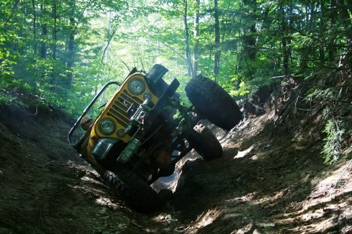

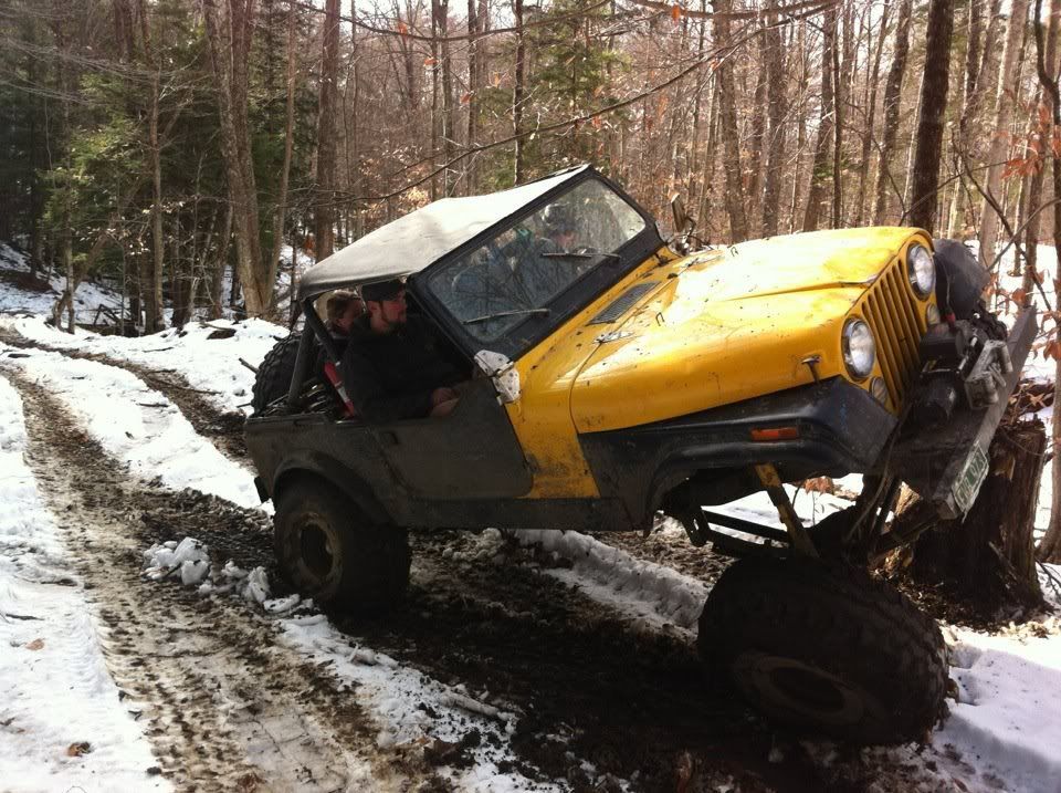

Low COG is good but I wheel with a buddy thats got a yota on 36's with only trimming done and axle upgrades and it doesnt compare articulation wise to my cj in that pic. On some really steep side hills I get some body roll but it takes a good amount more then that to flop. Overall I feel very stable wheeling with it setup like that. I would NEVER trade my setup now to go back to spring under. Again all my opinion tho. No right or wrong. I bet I would have flopped being spring under here.
Or here

You have 36's. Right? Like I said 36's and bigger go SOA. Under 36's go SUA. I also think its pointless to do SOA in a stock axle. They are too small especially for 36's. Also if you look in your picture your spring is bending majorly negative. Stock spring will not last long going that negative. Thats why most people go with RE 1.5in SOA springs. They dont go negative. For comparison I have seen people with 5 inches of lift on a CJ or YJ running 40's. Less lift === lower COG === More stable.
Good looking flex
