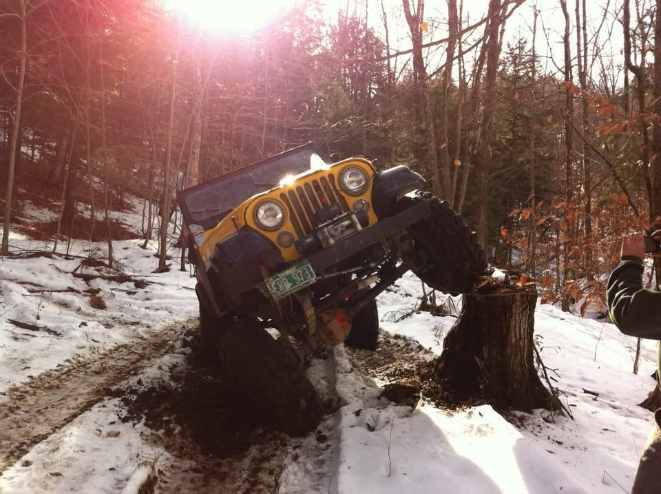

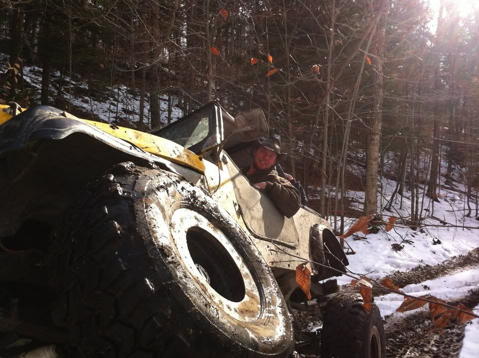

79jeepincj7
1979 CJ7
Location: Burlington
Posts: 935
If you are really gonna wheel the crap out of it spring over is the way to go. My setup is almost identical to Tec's but I'm stretched with the xj springs, scout 44 in the rear and 4.88's. If your going to just drive it the sua is a little more stable and roadable but I still drive mine down the interstate on different tires at 70-75 mph.
