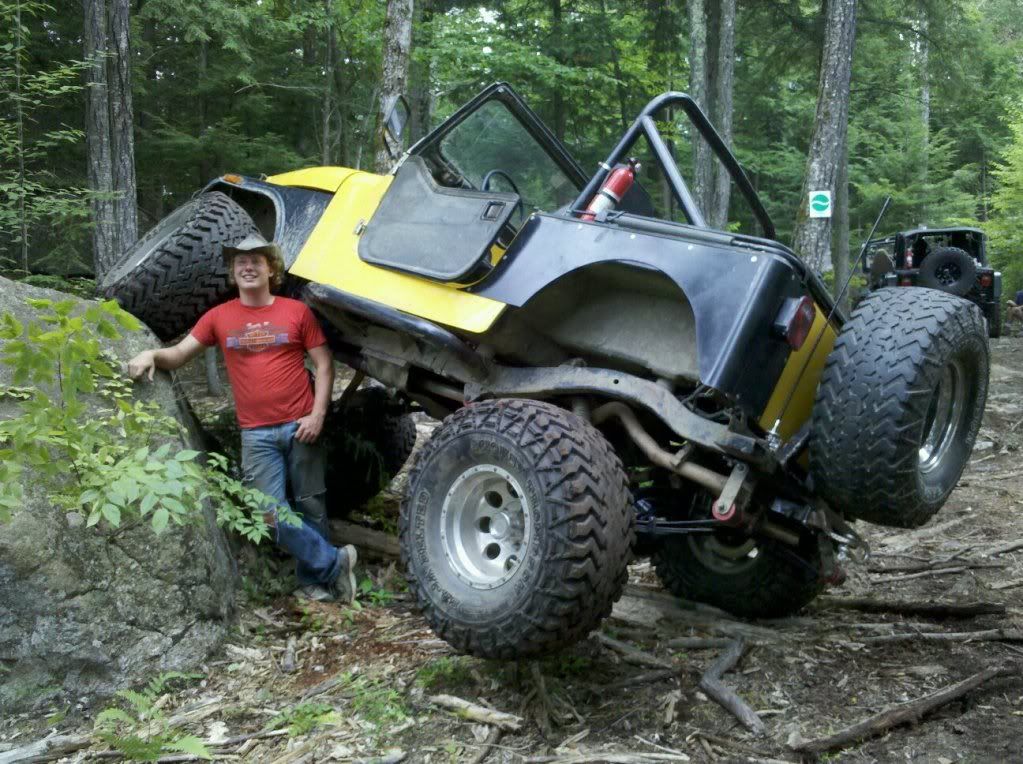

"SOA is the only way." my main reason was the axles I was swapping to. If I had the stock wide tracks still I would have kept it SUA to keep my steering geometry correct. Since the new front axle is stock setup soa and I prefer that now you can see how well the steering is tucked up. Using wrangler springs and it is very soft. only down fall is that big 14 bolt in the rear that needs shaved.

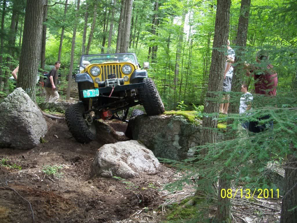

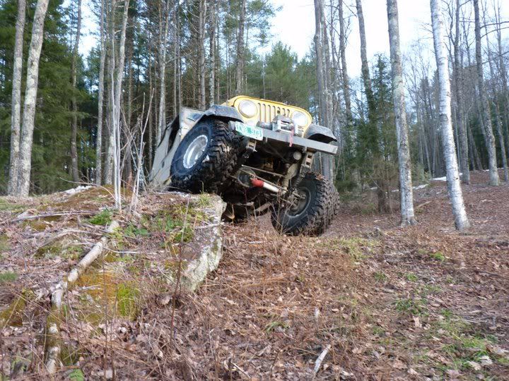

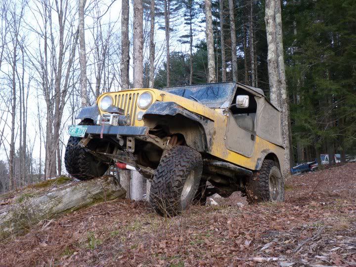

I have some pics of both.
Before: 4" superlift and this was about all she had with a narrow track 30 and 44
After: RE 1.5" springs in the front XJ 2.5 OME springs reversed (stretched wheelbase) in the rear both sprung over with dana 44's, shackle reversal, outboarded, highsteer, front axle moved forward 1.25" etc.
Wheel - Wreck - Wrench - Repeat!
The VIN says its a 79 CJ
79jeepincj7 is offline

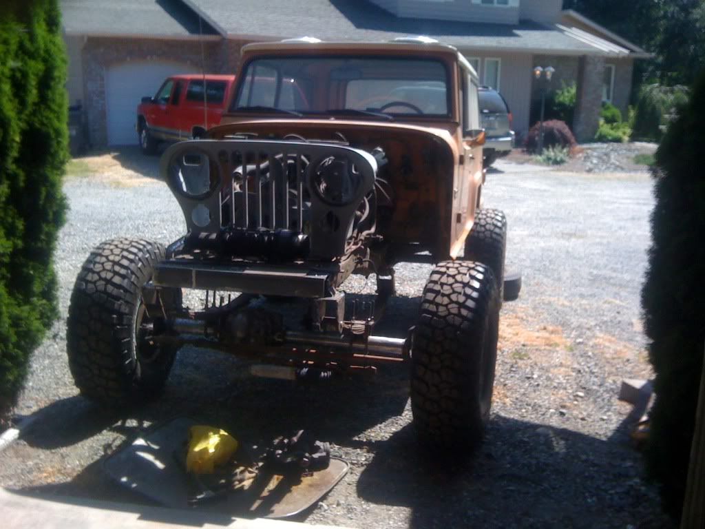

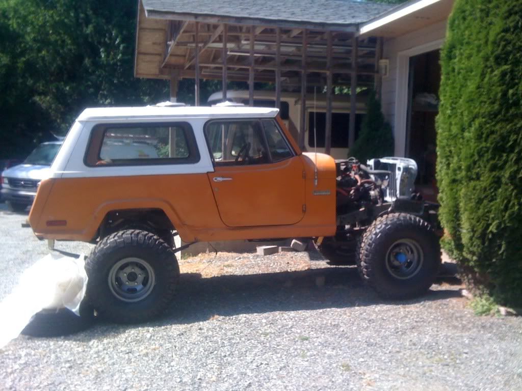

Im running SOA W/ waggy springs with an add a leaf in the rear and a 1" lift yj shackle. Stock rear early 90's s-10 springs in the front with a yj 1" lift shackle and shackle reversal.
Where I wheel its better to have it set up a little taller ( IMO ) and I love the way it looks, as far as the ride I have no idea yet. Stock it rode terrible, with my shackle angle in the front it should ride like a cadilac.
For stiring I bought a stock xj cherokee pitman arm and it makes the drag link angle much much better.
