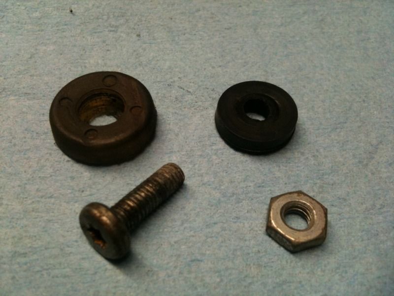

I don't know HOW I missed this thread as I had issues many years ago when mine were crushed and splitting. I ended up using the bumpstops found at the end of the vertical braces that hold up sliding shower doors. The wellnuts were destroyed upon removal or would just spin. I retained the fine threaded OEM torx bolt, and cut down the shower bumper to the correct height. The bolt fits snug fit and there is a small amount under the bolt to hold it, just no thin inside washer. Another plumbing washer underneath with a stainless nut has worked well for many years. Only the diehard CJ nuts (like us) can tell the difference.
I removed one tonight, snapped a bad cell phone pic and reinstalled.
Ed
