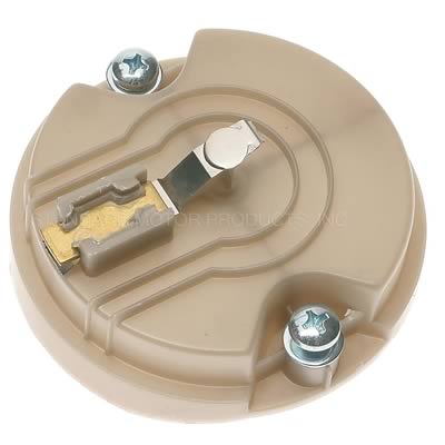

The distributor cap is VERY important, and this will help you make up your mind about what will work best for YOUR application....
As you can tell, I use what works best for these applications, and for my money, NOTHING beats MSD distributor caps for a number of reasons.
NOSTALGIA LOOK...
BUT... With good plug terminals!
MSD p/n 84333, about $32 at Summit Racing.
Link:http://www.summitracing.com/parts/MSD-84333/?rtype=10
Standard Rotor Only, MSD p/n 8467, around $9
Link: http://www.summitracing.com/parts/MSD-8467/
I STRONGLY SUGGEST you buy a blow through proof, Phasable Rotor if you are running fuel injection!

Cap & Standard Rotor, MSD p/n 84335, about $30 at Summit Racing.
Link: http://www.summitracing.com/parts/MSD-84335/
Rotor Only, MSD p/n 8467, Around $9,
MSD p/n 84211, $32 at Summit Racing.
Link: http://www.summitracing.com/parts/MSD-84211/?rtype=10
ABSOLUTE SPARK ENERGY CONTROL...
[size=2MSD part number 8420, around $50 with phasable, blow proof rotor,
Cap center terminal is replaceable,
Rotor nose is replaceable,
The adapter will allow you to use common Ford V-8 caps in a pinch...
(and for Rotor Phasing when you have to cut a hole in a distributor cap, you REALLY don't want to cut up the MSD unit, so a discount store cap will fit right on...)
Spaces the terminals out further and uses a rotor that high energy ignitions can't blow though, making your spark energy getting the plug wires a slam dunk,
This cap also allows you to phase the cap, and the rotor,
And for Fuel Injection Systems that have timing control in the computer/module, this is a HUGE DEAL since 100% of spark advance shows up in rotor phasing with the spark plug terminals at the cap...
Where only Vacuum Advance shows up at the rotor with mechanical spark timing control![/size]
It's what I'm running right now...
MSD Cap-A-Dapt, Ford Style Large Cap, MSD Phasable Rotor.
I wanted something I could pull a cap off the shelf if needed,
But the cap has replaceable center terminal, and it's over 10 Years old with no issues what so ever.
I have extra rotor noses,
The 'Cap-A-Dapt' is a one time buy, doesn't need to be replaced.
Phasable Rotor In Place,
Cap-A-Dapt Collar In Place To Mount The Larger Ford Style Cap...
(will accept off the shelf Ford V-8 Caps also)
MSD Verions Of Larger 'Ford' Style Cap In Place,
Another View Of Completed Cap Arrangement,
With the older style plug wire retainer on top,
The plug Wire Retainer attachment is built into the MSD caps now.

ROTOR PHASING...
Here are some links to an old MSD service bulletin on rotor phasing,
Now, remember, with a mechanical advance distributor, only the VACUUM ADVANCE shows up at the rotor to plug terminal.
Link to page 1. http://www.civilianjeep.info/Ignitio...Dphasing01.gif
Link to page 2. http://www.civilianjeep.info/Ignitio...Dphasing01.gif
The SMALLER DIAMETER the distributor cap you choose, the more likely you are to have Rotor Phasing issues...
So just be aware of this,
Here is a link to MSD's latest version of Rotor Phasing information, .pdf format.
Click On This Line For Link.
ROTOR PHASING IN PROCESS...
There is more than one way to do this, but since I won't let an ignition out of here without Phasing the rotor correctly, this is some of my test gear for checking Rotor Phasing...
MAKE SURE YOUR 'DIVOT' ALIGNS WITH THE ROTOR NOSE!
There are 13 teeth on your AMC distributor gear, that means no 'Center', there IS a 'Front' and a 'Back' to the gear!
Get the gear back on in the correct position!
Now, to get you started...
Install distributor into engine with rotor pointing in the correct direction for #1...
THE 'SPIDER', test cap, test rotor, testing plug wires for any V-8 running a 'Ford' distributor cap.
Notice the Firing Order for various engines is written on the cap, along with rotation for each engine,
And the plug wires are a mess (8 Spider Legs) but long enough to reach every cylinder on any V-8 engine...
The distributor cap I cut the "Window" into so I can watch the rotor in action while the ignition advances and retards during operation...
CHEAP CAP since you are going to cut a giant hole in it!
I put a stripe of NON-Conductive paint on the rotor center line so I can see exact center line better with the timing light...
This is pretty typical for 'Vacuum Advance' misalignment.
With CORRECTED Rotor Phasing, you will wind up with something like this...
Now, most people don't think the increased cap diameter is a big deal...
Here are two things to consider,
1. Distance between terminals.
The smaller the cap, the closer the terminals.
Much larger chance for spark energy to go the wrong way, ESPECIALLY if the Rotor Phasing is off and the Rotor is closer to the WRONG terminal when the ignition fires...
2. The small diameter caps use a SMALL ROTOR NOSE at the plug terminals.
The 'HEI' and 'Ford' large caps use a WIDE rotor nose, to keep the rotor firing the Correct terminal,
See the width of this rotor nose at the Plug Terminals?
Now, have a look at the width of the Rotor Nose on the small cap Rotor...
With a 'Small Cap' you have to be MUCH more precise with Spark Energy Control or you WILL fire the wrong cylinder!
So Rotor Phasing is a MUST to keep the Spark Energy from firing the wrong cylinder!
