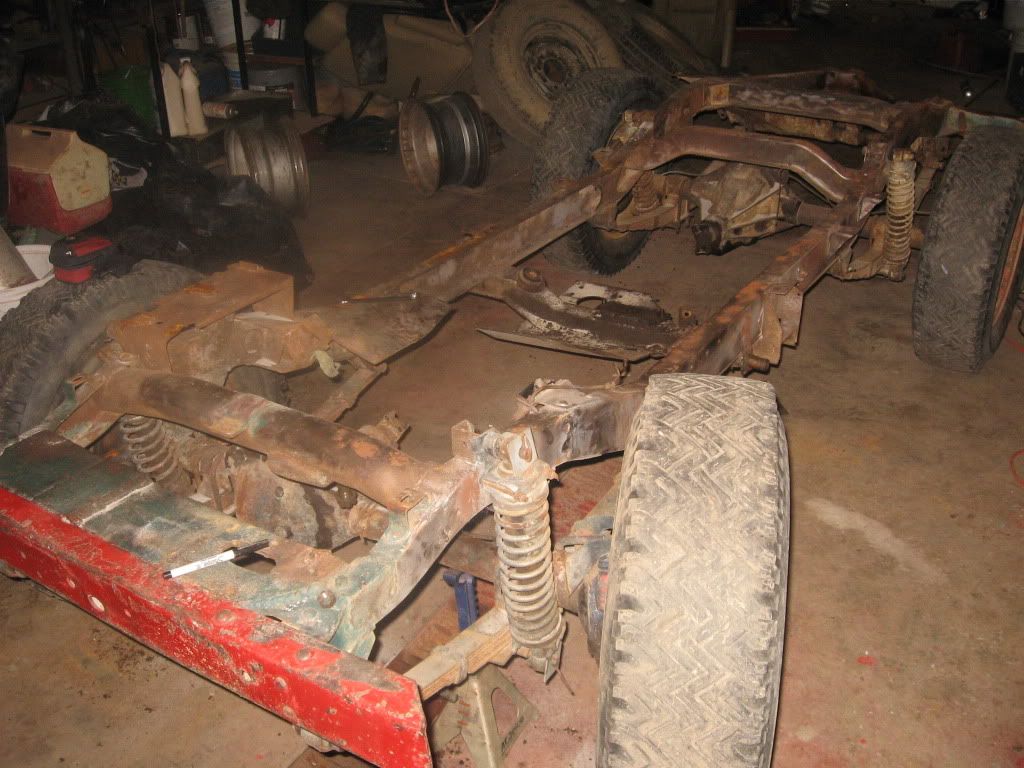

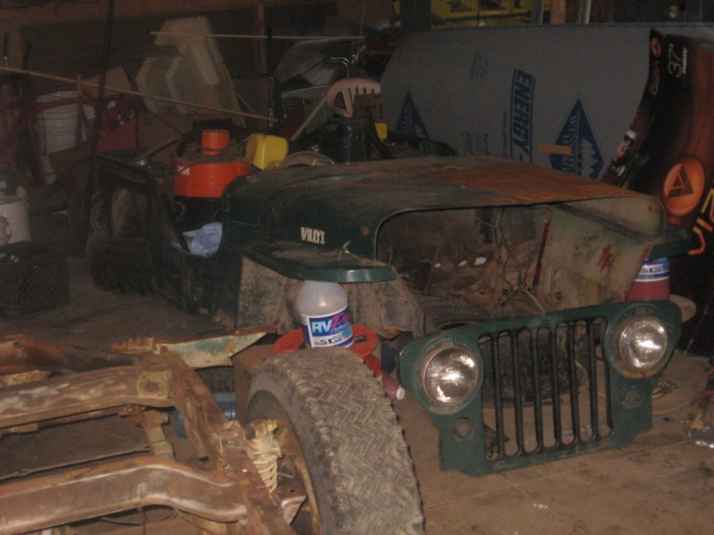

alright finally got pictures. its in my dads garage which is an absolute mess. but here it is.
here's the body that is filled with all my dads junk cause its been sitting for a few months now.
empty frame sitting there waiting to be taken care of.

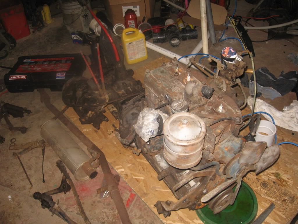

engine tranny transfer case sitting on the floor.

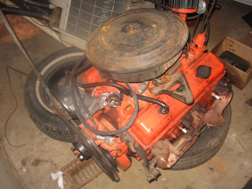

and here's the 350 i was gonna use but then decided to trade it for a 304 and another 300 dollors for an entire cj5.
ill get pictures of the other jeep when i get more time and when it gets down to the garage.
