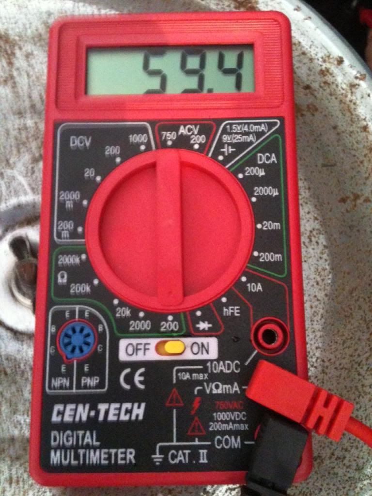

Ok. I just checked it again with the meter switched to 200 instead of 200k. Cranked and ran the motor for around 3 minutes which allowed the gauge to peg out to the H. Here is what it read on the meter.
So if I am reading things right, this means that my engine temp reading of 59.4 ohms is between "cold @ 73 ohms" and "beginning of band @ 36 ohms" which is listed on the page by John Strenk.

So it would seem that it is not overheating like the gauge says after all. (Unless the gauge is bad, but I tested that already.) And since it wasnt getting up near 195, thats why I wasnt seeing any flow since the stat was closed. So now what? Is my gauge bad? Is my temp sending unit bad? What do you guys think?

Well, if your gauge is reading "H" while the sender is at 60 Ohms, then either the gauge is bad, or the wiring between the sender and the gauge is bad/damaged. 1st thing to check is how well your speedometer is grounded. The Temp gauge grounds through the speedo housing. See the "Good Grief, Grounds" section of Mr. Strenk's troubleshooting page for more details.
http://home.roadrunner.com/~john.str...for_cj_gau.htm
As for the sending unit, you really need to know the actual coolant temp to make any definite determination. However, based on the ~3 min running time, I'd say it's probably pretty close.

I think we finally got it. I did some more testing using the John Strenk page.
It states: "As long as we are under there you can check the Temp gauge. Only one test. From "A" to "S" on the Temp meter. It should read 12-21 ohms. Same as the Fuel meter from "S" to "A" ."
My temp gauge read 30ohms so something is off.
THEN I also pulled off the thermostat and housing and cranked it up. Coolant blew out everywhere!!!
YAY! Its not the water pump! And the radiator might be ok too!
I then went ahead and threw the new 195 degree stat in a pot of water and it opens as it should. Now I need to buy a third t stat gasket and sealant and figure out what to do about the gauges.
