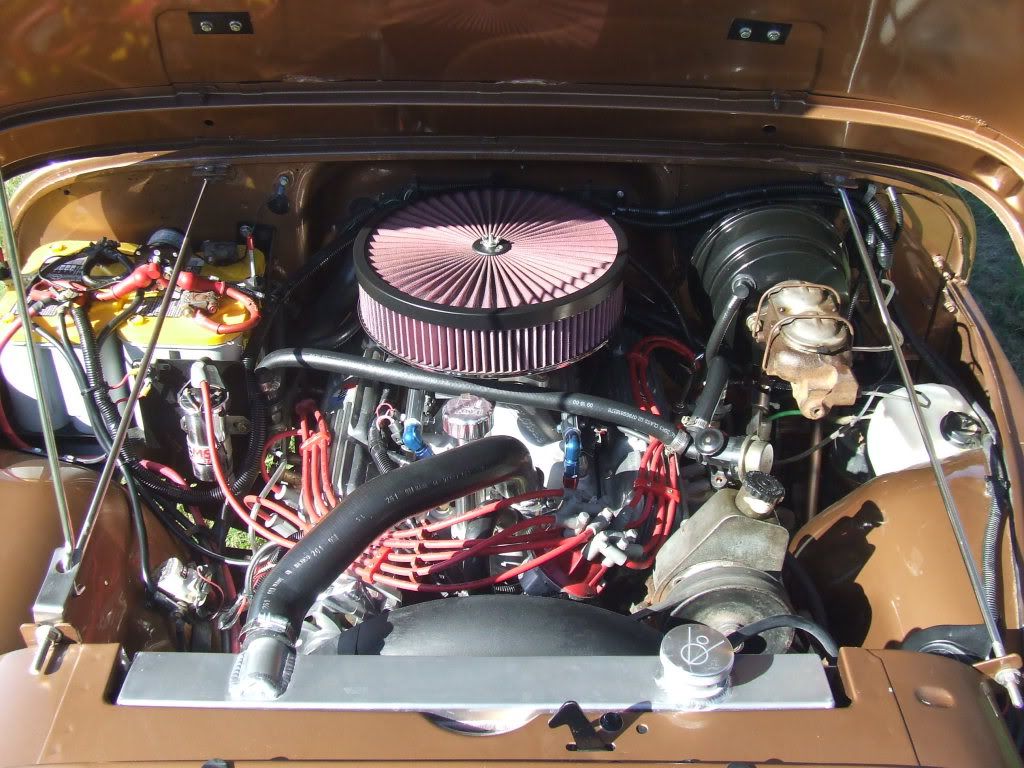

I will try and get out in the garage and take some engine pictures this weekend.
I went from a quadrajet (mounted backwards-hillbilly fuel injection) that worked pretty good but I wanted it more reliable at different elevations. I used a TBI that was basically a GM system that had a burned chip. It had 2 injectors. I could not get them big enough and if you do the math it is not possible. I thought of going to the 4 injector setup but was tired of having chips burned. I thought software would work better.
I can honestly say that I have been really happy with MFI. I just jump in, fire it up and off I go. Since I did mine (7-8 years ago) alot of new stuff is out there and some claim to self tune by just driving. I have not looked into any of this since mine works fine.
The only downside is if anything goes wrong in the ECM. It is not like you can get out and "re-tune" it. I did have this happen once while it was in a shop having engine work done. I sent it back to DFI. They downloaded my mapping, repaired the firmware and uploaded my mapping again and I was good to go.
The only current picture I have is this.
I will try and get some close ones.
DonEBeasley is offline

Don, are you running just a throttle body or do you have a mass air flow sensor tucked up under that air cleaner?

1000 cfm throttle body. I would love to run a closed intake with MAS but cannot seem to find one for AMC
Ducted or Snorkel intake tract makes a good access point for a MAF sensor.
