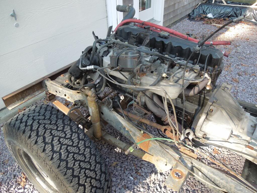

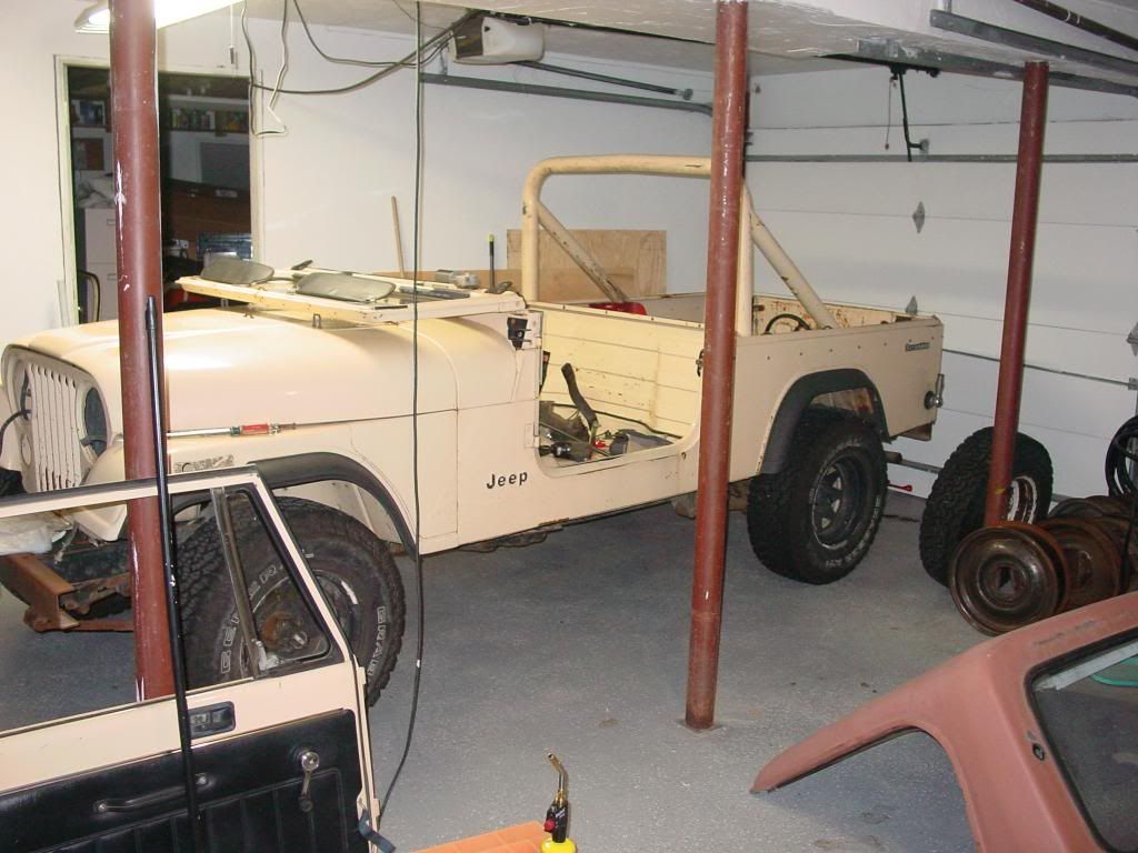

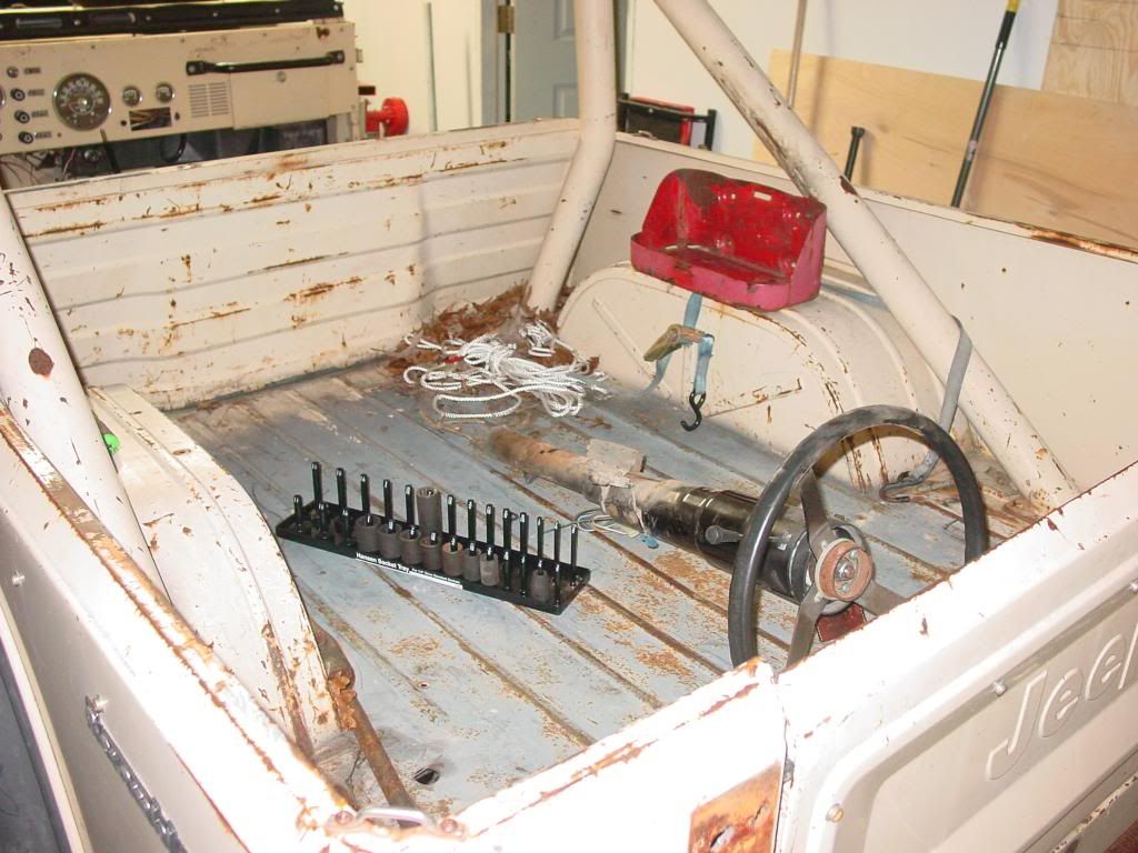

Alright folks, I bit the bullet and decided that it was time to protect the Scrambler from rust. This happened a couple weekends ago.
[URL=http://s448.photobucket.com/user/dkg4244/media/Scrambler%20Build/DSCN2453_zps22f15c49.jpg.html]

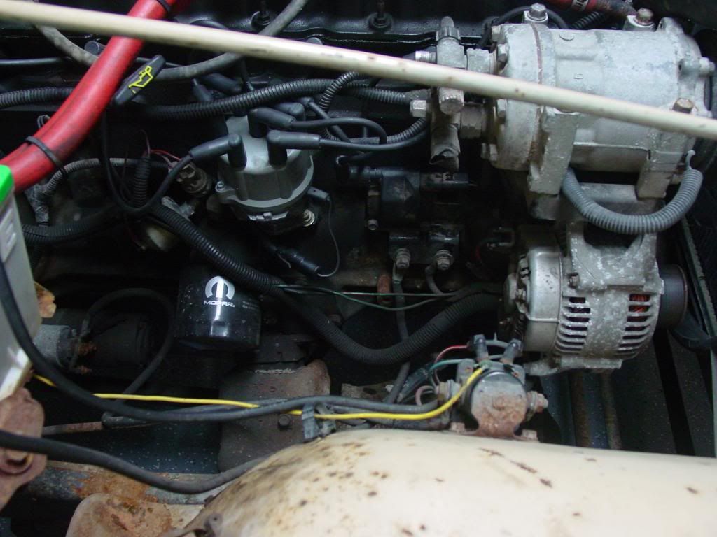

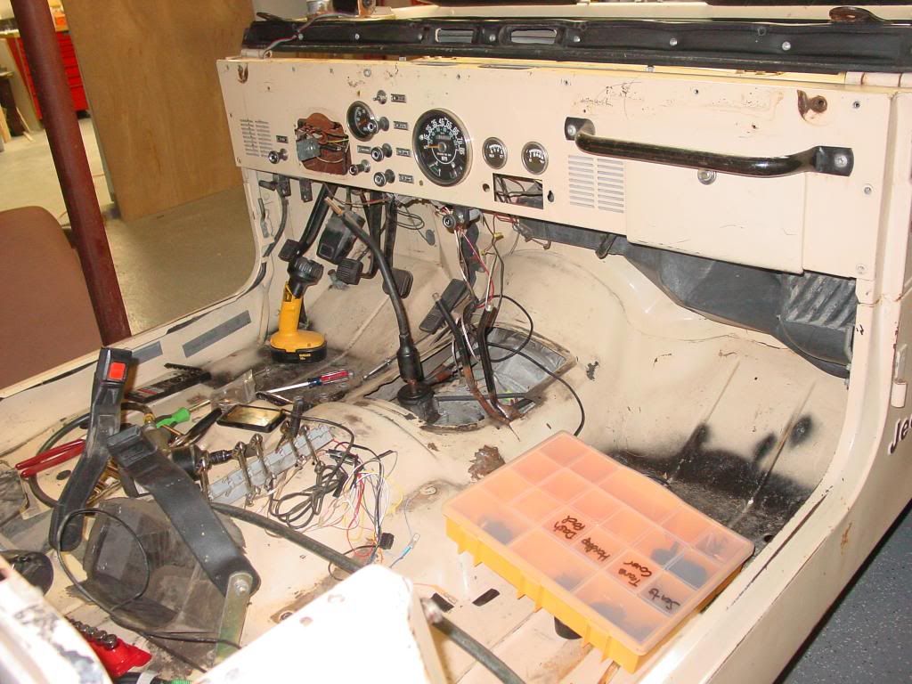

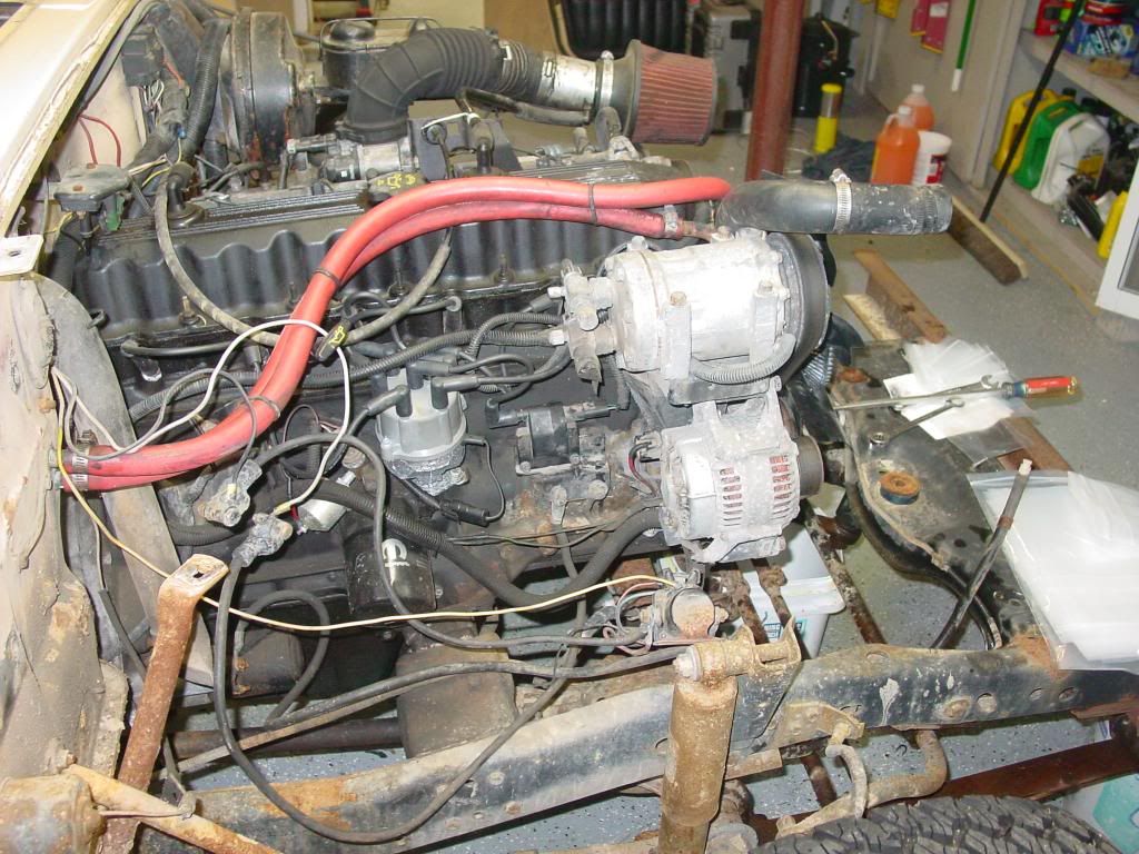

So I got some more work done yesterday and today. I pulled the engine and set it on my stand. No surprises and it went pretty smooth.
I pulled the valve cover and did a little inspection to see if anything was awry. Couldn't find anything wrong up top.
Overall, the engine was looking pretty good.
BUT, then I decided to dig a little deeper. I knew I had a knock of some sort that would be loud on startup and then would go away with oil pressure and then come back at certain RPMs. I suspected a rod bearing. My neighbor said no way it's gotta be a wrist pin or a lifter. Well I pulled the oil pan. Luckily I didn't see any big pieces of anything in there. Then I started to shake the connecting rods one at a time. #2 was a little sloppy so off came the bearing cap. Here is what I found.

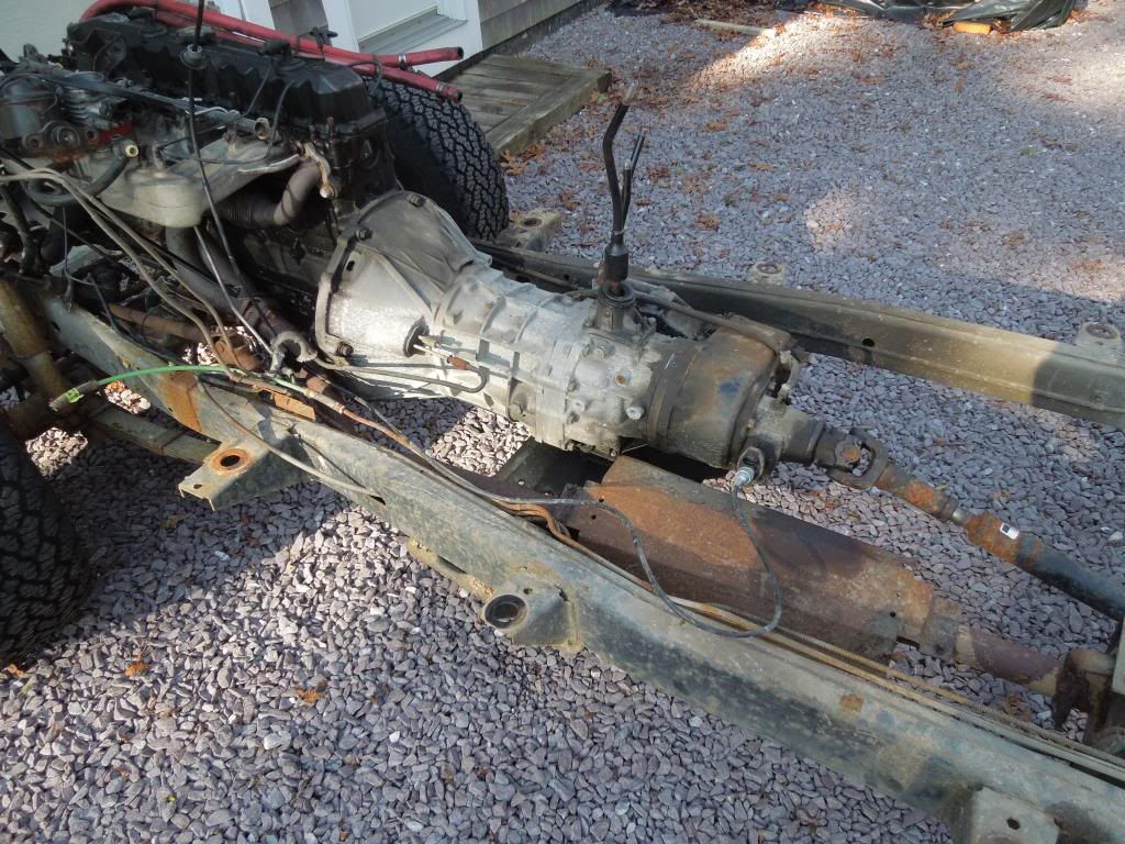

I found some cracks in the frame that needed attention.
This one's right by the engine mount.
Weld 'er up!
I decided to stitch weld the frame rails from the front end to about halfway back. The factory welds looked poor at best and were starting to fail along both rails in spots.
Up by the front crossmember.
Up by the crossmember on the passenger side. You can see a crack that runs all the way down the the lower part of the frame rail. I welded it up but haven't taken a picture of it yet.
By the shock mount.
Pass side engine mount.
Hopefully that will help with the cracking issues. I have to address a major stress crack issue up by the front pass. spring hanger but that's a job for tomorrow. Stay tuned....
