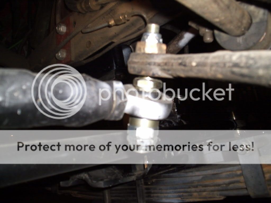

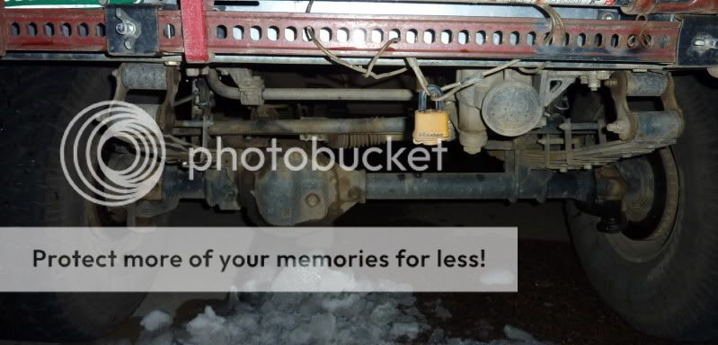

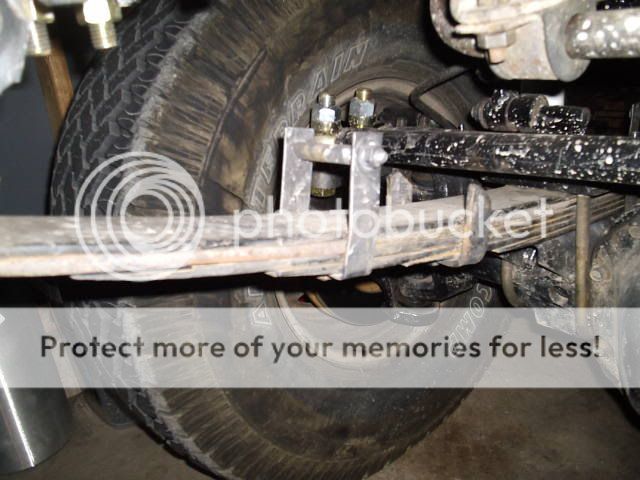

This is my crossover steering setup on a scout D44 axle. You can see that the drag link is almost horizontal. I went to a lot of effort to keep the leaf spring mounts very close to the axle tubes. This makes it easier for the tie rod and drag link to go over the springs without hitting them. The last picture is how I mounted the drag link to the pitman arm with a special aircraft grade steel bolt I got from Speedway Motors. That bolt has a 5/8" bolt on one side and a tie rod taper on the other side.
