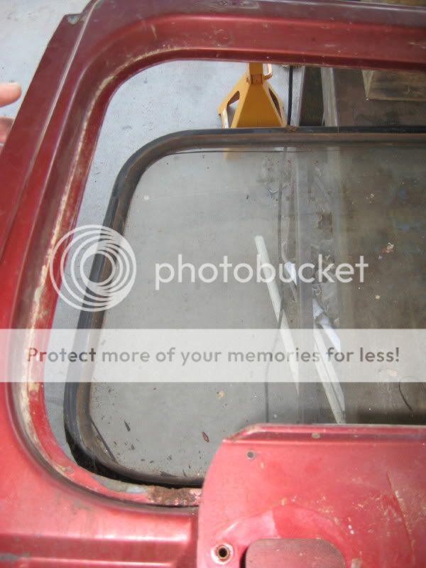

But then I noticed these little suspicious spots, and I knew I couldn't leave the glass in the frame.

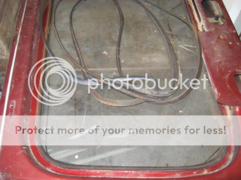

So with my heart in my throat, hoping for good times, I removed the glass. I could have kept the rubber seal, but my last seal fit well, and they're only $20, soooooooooo...

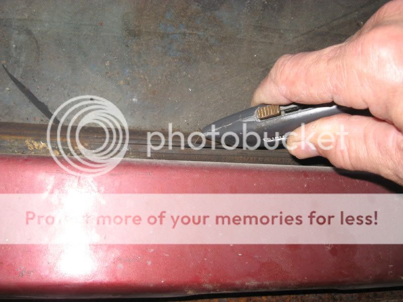

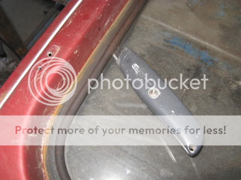

First, I undercut the rubber.
Then I cut right down the middle.
This is what it looks like after cutting and removing the seal.
Pops right out...
See...
So here is the first ugly spot, right under the wiper motor bracket. Gonna have to remove that too.
