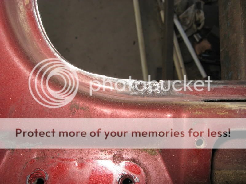

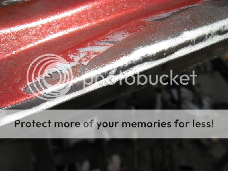

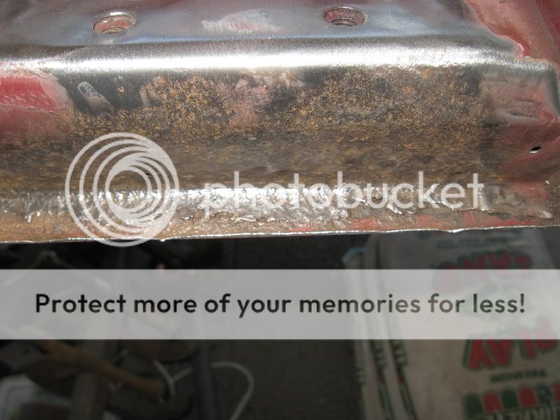

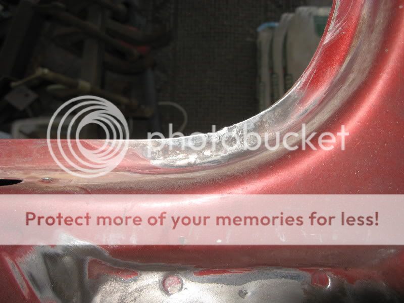

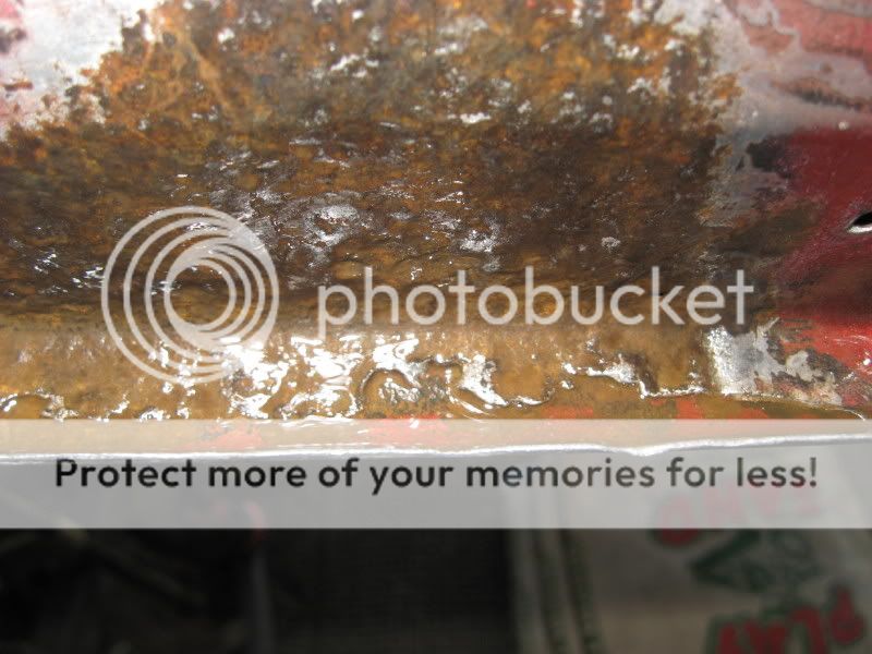

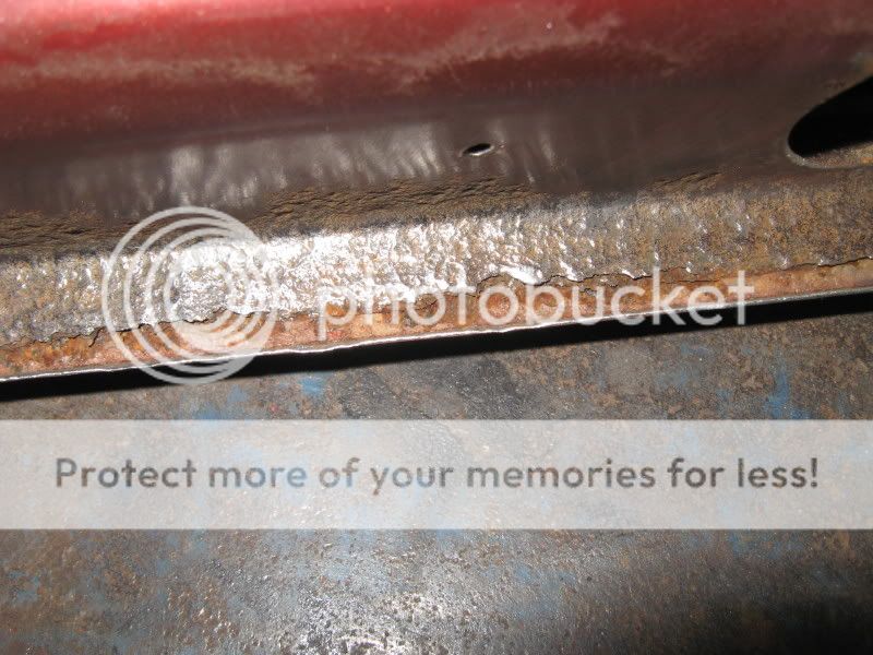

My computer gets totally freaked out when I have more than one browser open, and it overloads. Thought it was gonna BLOW! Here's the last pics of this sequence...
The rust is deep down in the grooves and cracks. I need a different wheel to attack this. Wifey is on the way home from Church, so she will stop and get me one. In the meantime, I used a wire brush by hand.
Hand brushed.
Other ugly spots cleaned up.

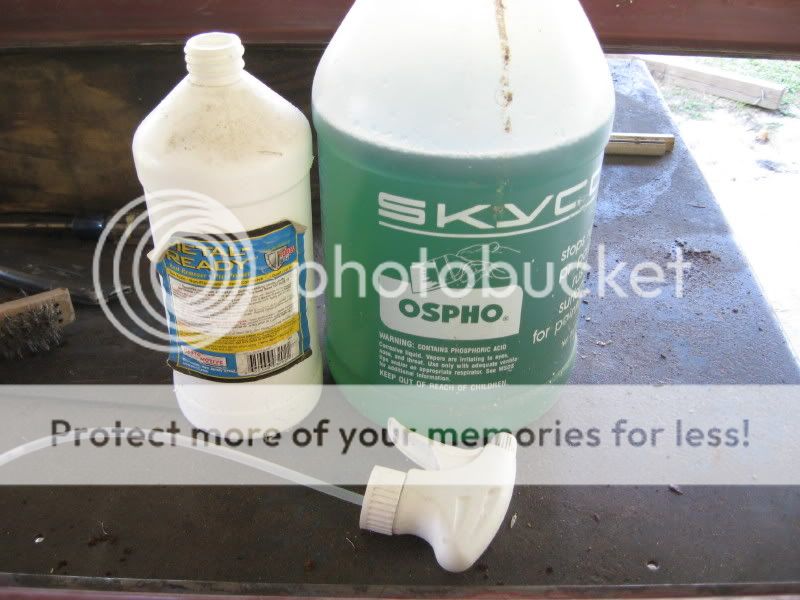

These are both very good products. I bought the Metal Ready as part of a "kit" when I bought the POR15. It's all gone, but I'm using the bottle. I'm pouring Ospho into the bottle.

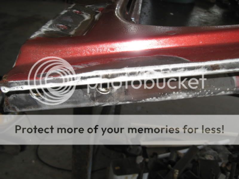

Notice the immediate reaction to the bare metal! It foams up as it etches.
And this is the worst spot on the frame. It has Ospho on it. There is where we're at... waiting for it to cure. Probably done for the day.
I'm going to have to address the entire frame. I had hoped to avoid that, but no way around it.
