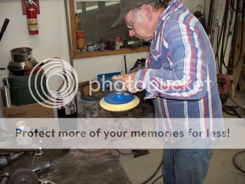

Here are some pics of AJ working on the old master before we learned that we couldn't rebuild it, and some more pics of bench bleeding the new reman unit.
This is JR. He's as good a mechanic as his dad, AJ. Sitting next to JR is the old master cylinder disassembled.
To disassemble the master you have to remove the snap ring where the piston rod goes into the body. Then you carefully pull everything out. There are two plungers. The second one will be inside the body of the master. We used air pressure to force it out.
AJ buffing the lip so the lid will make a good seal.
Cleaned up and ready for the lid.

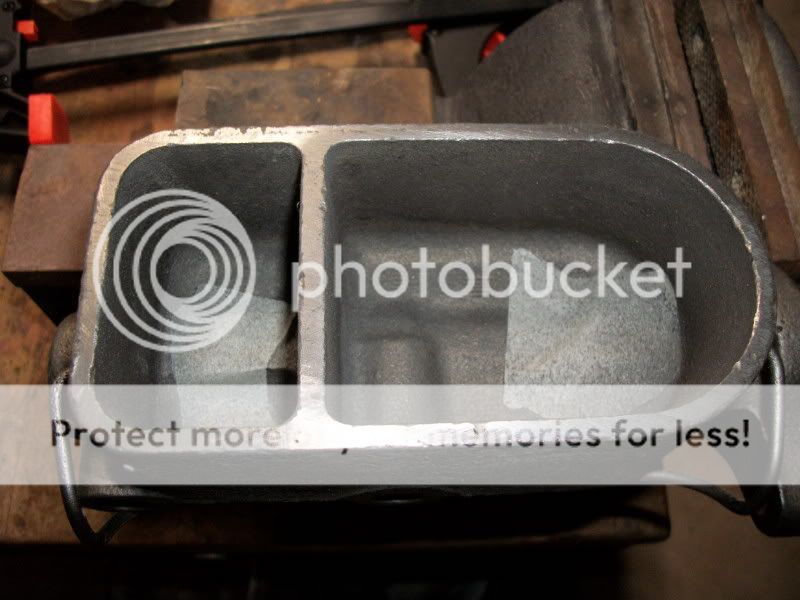

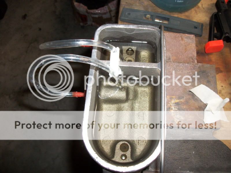

Here is the new reman master. I stuck it in my vise to prepare it for bench bleeding. I want to polish the lip so the lid will seal well. I used a metal file to do this. Keep it flat at all times. Protect the inlets from dust and trash.
Lots of filings.
Blow it out and level it in the vise.

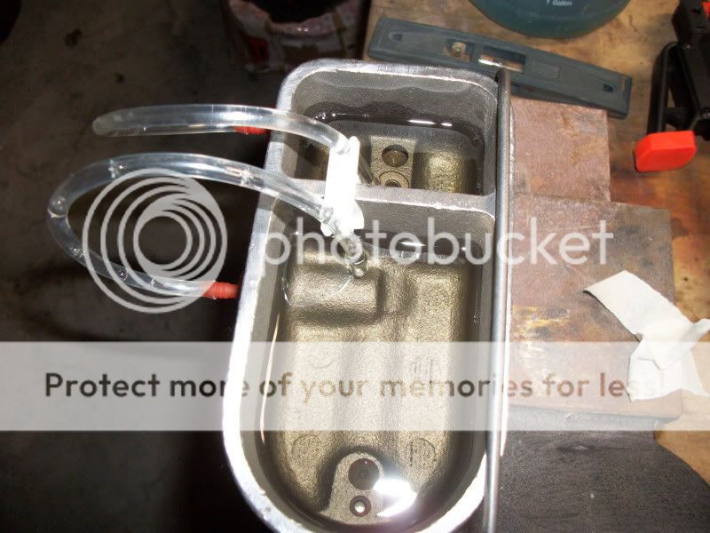

Attach the bleeder nipples and tubes as described in the directions. Keep the ends of the tubes away from the inlets inside the reservoirs. You don't want to keep recirculating the air that will pump through the tubes.

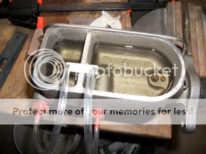

Add clean fluid to the reservoirs, making sure the ends of the tubes are covered. Add fluid as needed to keep the tubes covered.
Push in slowly on the piston to begin the bleeding process. This will take you around a half-hour, more or less. Go slow. The directions say to use short strokes.
Bubbles!
Once all the air is removed top off the reservoirs, remove the tubes, and cap the nipples. You are ready to install.

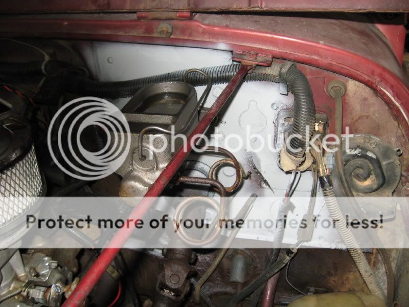

I woke up this morning with the anticipation of making my Jeep capable of stopping! Which is always a good thing... right? I mean, there are only so many big trees around at any given time, not to mention the detrimental affects of hitting even a small tree. So I had great hopes of working brakes after the new master cylinder was installed and bled. After coffee, I coaxed my wife to the shop and enlisted her help. She actually likes to work with me on the Jeep, but she also can't wait until Lizzie is road worthy!! Last night I bench bled the master, and it was ready for install. Following are some pics of the activity this morning.
The first thing you should address is the corrosion caused by a leaking master cylinder. This is what happens to your paint, and you can imagine, given enough time, what would happen to the metal on your firewall if you left this mess forever. I have to do something about it before mounting the new master.
So with a putty knife and wire brush and a can of carb cleaner, I cleaned up and degreased the area. This is a temporary fix until Lizzie goes under the knife.... which will happen when we finish the 5.
My wife is wire-wheeling the bolt threads before mounting the cylinder. She's a good helper.
Here is the area cleaned up and painted with primer, and the new master installed. I have to tell you, getting your hands under the dash and connecting the piston to the brake pedal was a major PITA! My wife actually did it, and she did it quickly!! I'm going to have to buy her something... maybe a new oil pressure gauge??

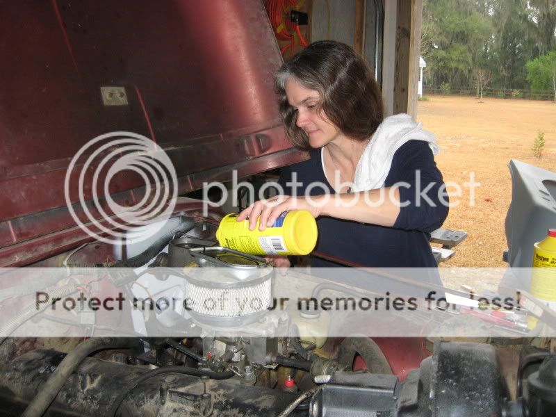

Now she is topping off the reservoirs as we get ready to bleed the brakes. At this point, we are gravity bleeding all four at once. This took about 10 minutes. Be sure and put something down, cardboard, etc, to control the mess. If you have tubing to attach to the bleeders you can catch all four wheels.
After gravity bleeding we went through the sequence of bleeding them by each wheel, starting with RR, then LR, RF and LF. The brakes pumped up nice, and that's the first time Lizzie has had any kind of stopping power since I got her. Keep in mind that although I have brakes, they are still manual, and MUCH, much different then what you are used to in a modern vehicle. Wifey ready to go!
