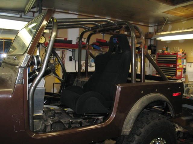

how I did mine
front hoop to frame
back to frame

the frame kit and front hoop and spreader bars I bought - the back bar i made out of 2 roll bars from a cj

the front hoop -spreader bars and frame tie in kit at a local 4x4 shop

There is nothing wrong with bolting the cage in like fuzz401 did his,,It is hundreds of times better than just bolting it to the body in my opinion like jeep does from the factory anyway..I will be doing mine along the same lines as he did his very soon..My factory roll bar is just bolted to the fiberglass body now by the previous owner (For looks I guess)..I need to find a shop in my area so I can get mine done as well as a friend of mine's CJ...
