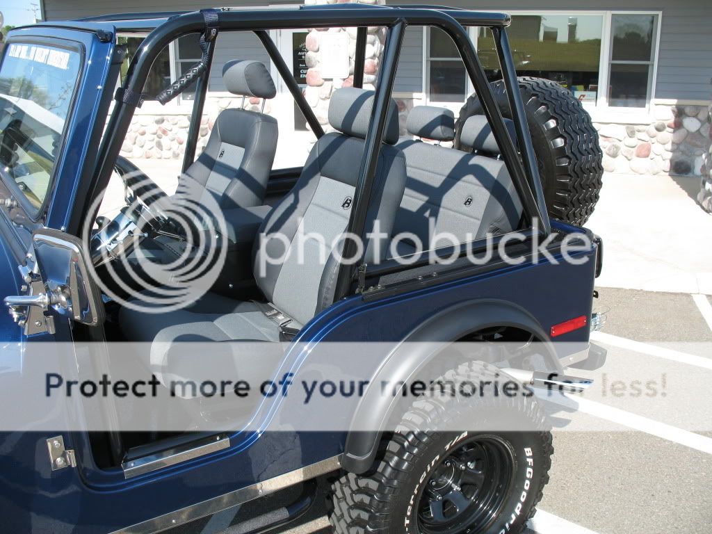

Here's a cage I built for a customer's 1979 CJ-5. I used 1 3/4" .120 wall DOM and tied it to the frame with bushings on the nerf bars and a support tube at the back of the frame. The factory soft top still fits and the seats and center counsel are attached to the cage.
