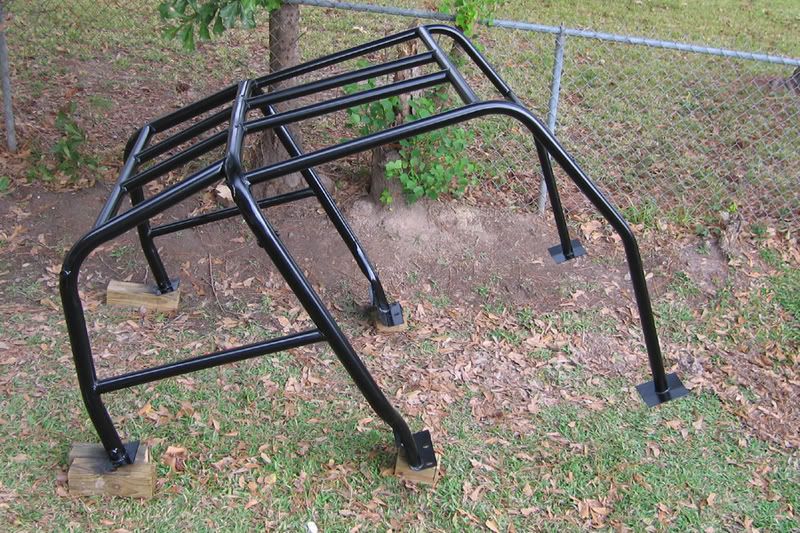

Location: Abbeville, LA
Posts: 250
Sparkplug
1978 Jeep CJ 7 258 6cyl Quadra-Trac with T400. Custom 3" body lift. Flatfendered. Custom bumpers. Full 6 point roll cage. 36" IROK's. 2 1/2 suspenion lift and 1/2 shackle lift. GM HEI, Superior 1-piece axles, 4.88 gears, Weber carb. Locked front and rear. Best of all, fours sons who LOVE TO RIDE!
Sprkplug is offline
post #14 of 33 Old 01-20-2009, 10:58 AM
SlikRic
Muddin Maniac
SlikRic's Avatar
1983 CJ7
Location: North Port, Florida
Posts: 3,125
Originally Posted by Sprkplug View Post
Sparkplug, I can't find one that looks like that on their site. Do you have a direct link to your's? By the way sweet jeep Oh also does it come welded together? Thanks.
