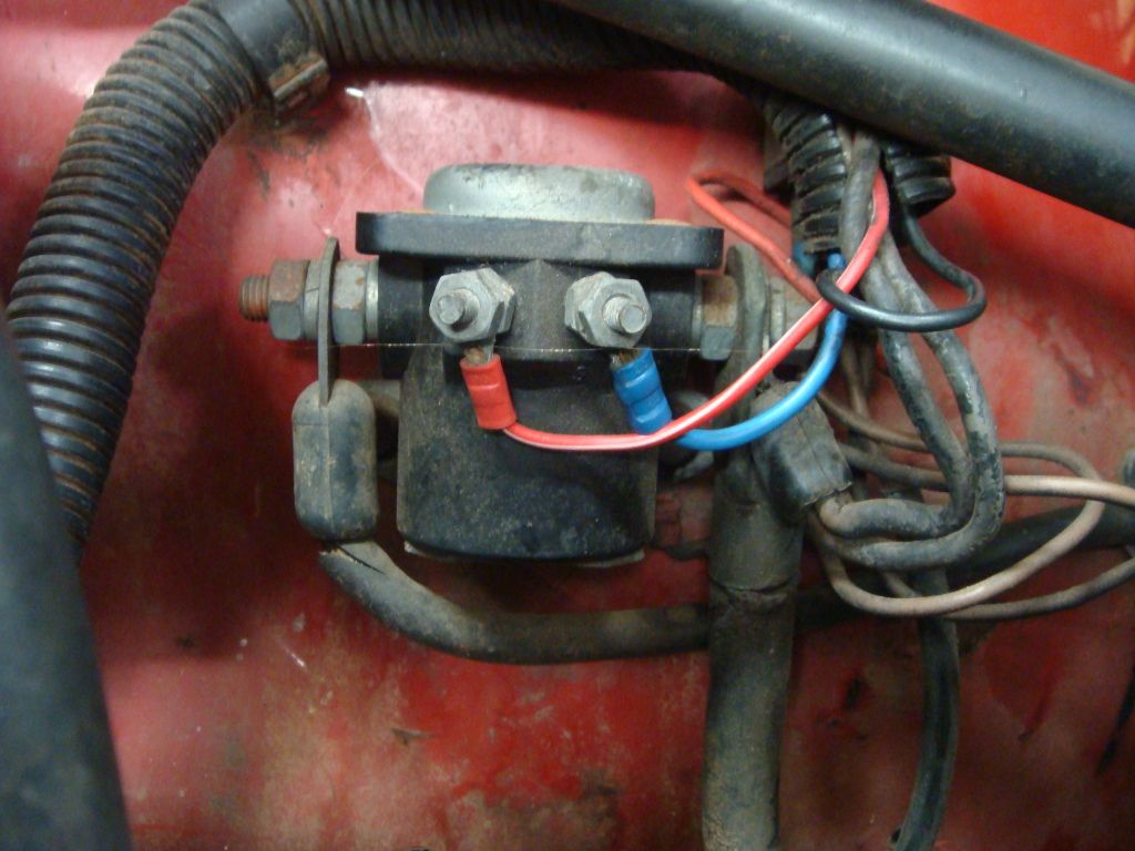

Can you possibly do me a BIG favor? I have the same engine in my RHD 84 CJ7 and I think the last owner wired up the external solenoid wrong and I am having some electrical issues. Can you take a picture of your solenoid for me? All the diagrams I see tell me they had it wrong but I would love to see what you're running.
This is mine.
It appears the alternator lead is on the wrong side. That is it on the left with the lead going directly to the starter just out of the picture.
ffrost3 is offline
This is mine.
No worries frosty, the latest addition to the family is completely stock and mostly unfiddled with. It's at my workshop so I'll take some pix tomorrow and post em up just in case anyone else needs that info too.

Here's the starter solenoid. Left comes from the battery and right goes to the starter although that doesn't matter as it's only a contactor. The other two are what you're after.
Whilst I was poking around in there I found this. I've never seen one of these before. All intact and complete, crazy for something 26 years old.

Everything that you are saying about your solenoid is exactly the opposite of what mine is doing. lol

Don't forget the orientation of the two solenoids are opposite each other in the pictures. Look for an "I" and the "S" terminals to verify the proper connections. Red to "I" "S" to start position of ignition switch.
Hard to say which one is mounted upside down, being on the other side of the planet and all that...
