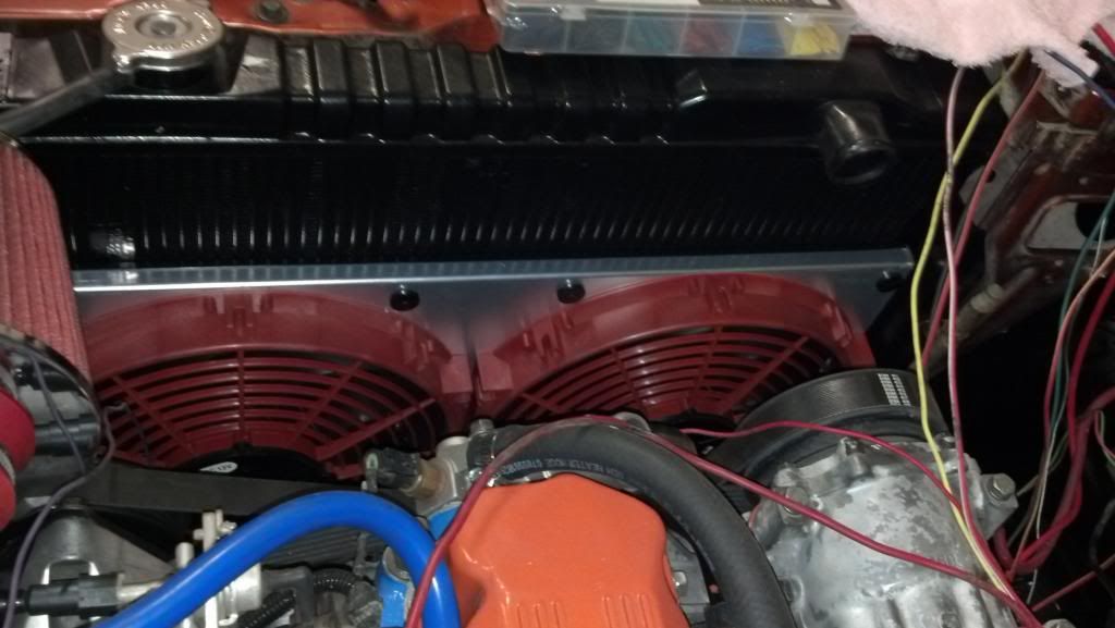

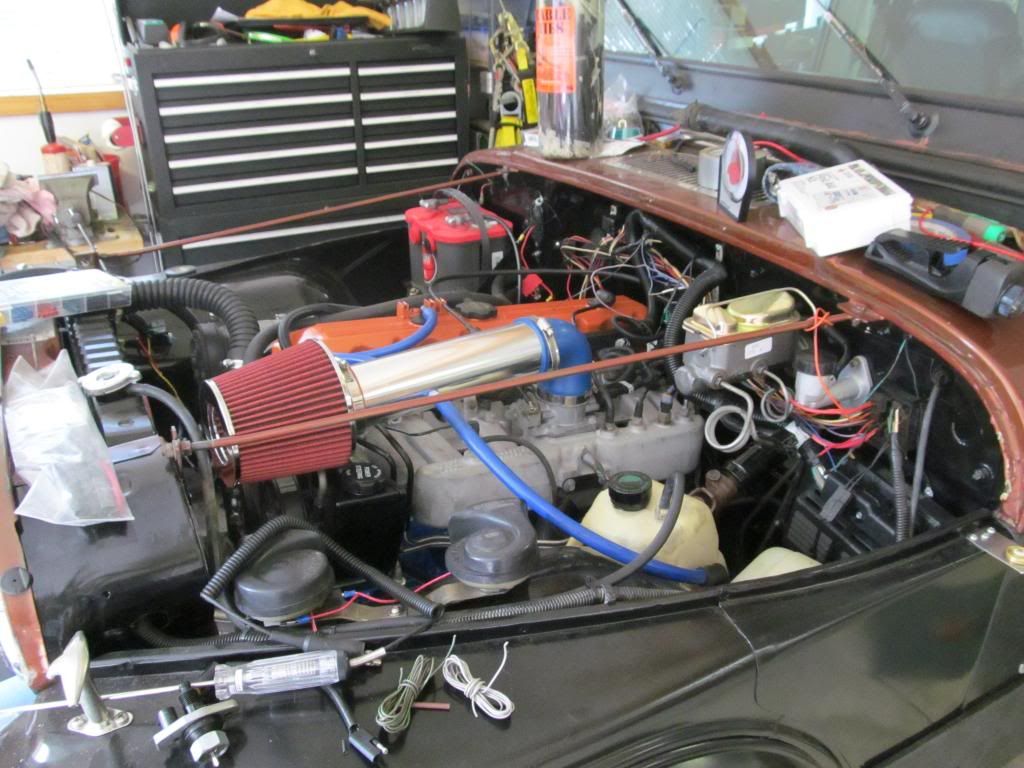

I know I have been horrid with updates, and the work has been slow due to the day job and some work related travel. Here is the latest:
Engine in place, front end back together, wiring in progress
Computer mounted under battery tray, Cherokee relay block on fender, most needed wiring run
New electric fans and radiator installed
Another look at the wiring and else in place
I hope to get the wiring needed to get it running finished this weekend and hook the fuel pump up to get her running. After that it will just be a matter of driveshafts and we will be back on the road
