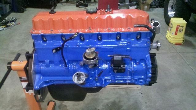

Well, after three months I'm back at it. Finished up the engine work - got all the accessories back together and installed, so here we are ready to go. I have a 4 day weekend ahead, so I hope to have the motor and tranny in by Tuesday so I can start on the fuel wiring and other small stuff the following weekend.
Here it is ready to start:
One last look at the old motor - it looks naked without the the winch!
Goodbye old cold blooded beast!

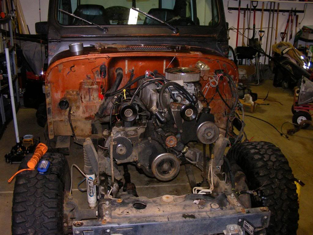

Well, day two got me to this point before my wife drug me away to exchange some Christmas presents

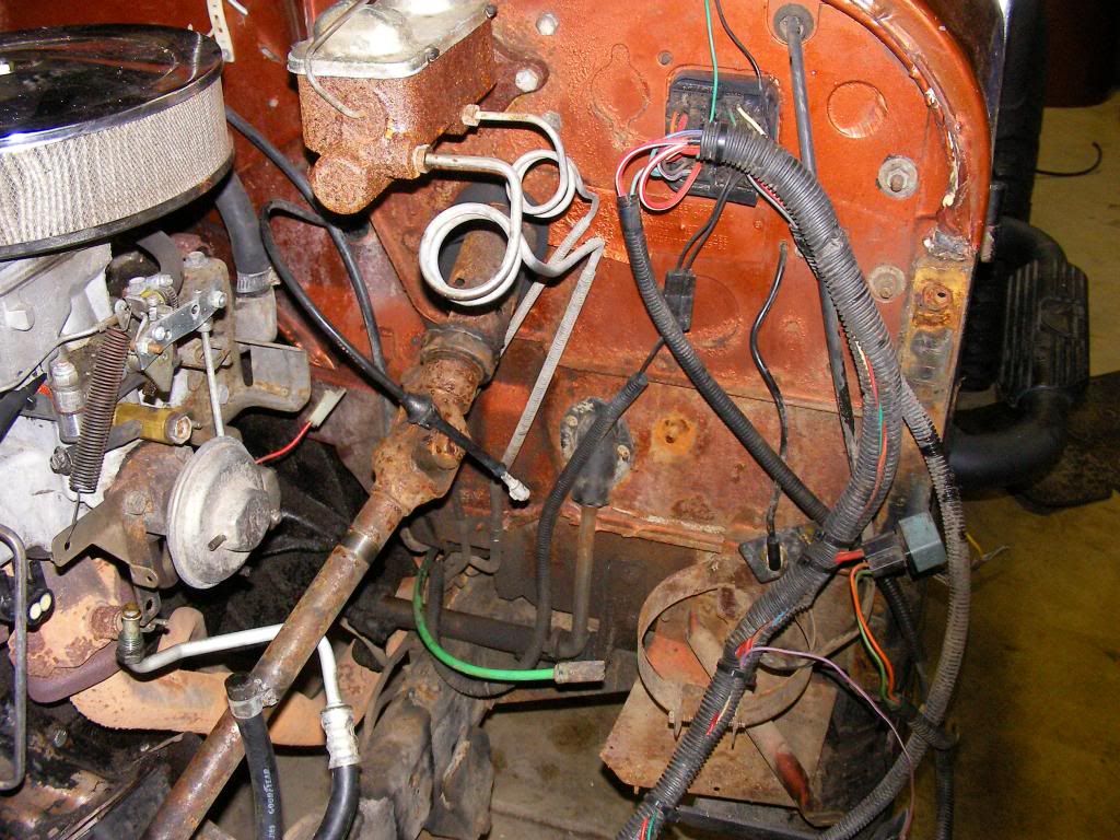

As with any jeep project, I found more work to do along the way. To pull the transmission tomorrow I'm going to have to pull the center console and seats so I can get the floor plate up. I would need to do that anyway since the new transmission is longer, so may as well do it now. If I have the seats and console out I may as well clean up the floor and put some liner paint on it to cut down on the noise and rust. If I'm going to have the seats out it will make it easier to replace the fan with the Blazer motor, so may as well do that. And I was surprised at the amount of rust on the master cylinder and firewall on the drivers side.
So I guess this means a good cleaning and paint for the firewall along with a replacement master cylinder.

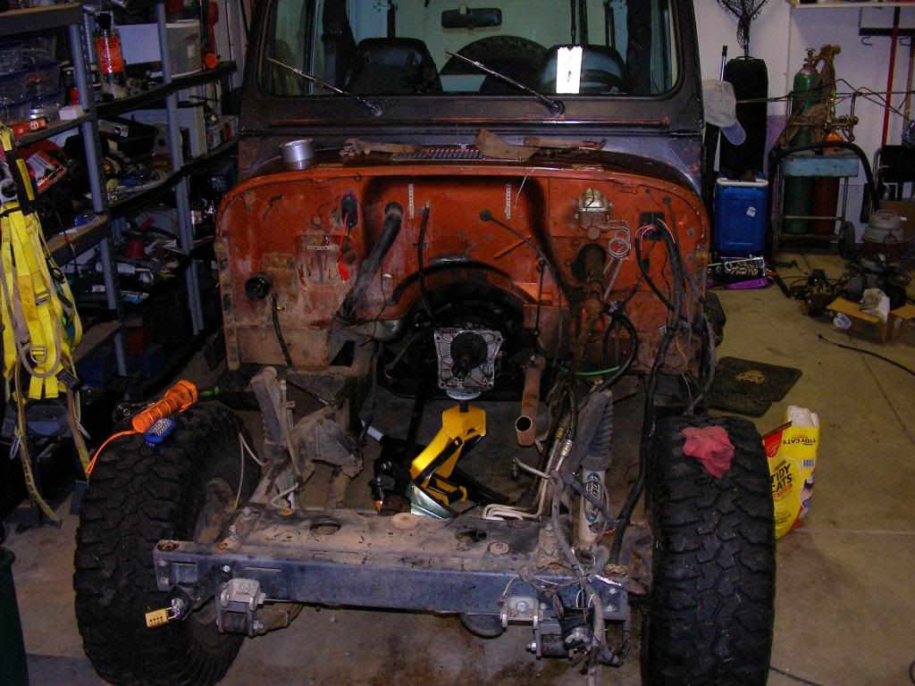

Houston, we have no motor...
Originally Posted by gunzmcghee View Post
Looking good so far. Goodbye V belts, hello serpentine
Odd thing is, this was one of the rare CJ's with serpentine belt instead of V belts.
Goodbye old 4.2!
Now to wire wheel and pain the firewall and pull the transmission and transfer case.

So guess what I found while I was digging out the transmission and transfer case? It appears the master cylinder had a small leak in the rear seal and had been leaking down the firewall. I now have a lovely rusted mess inside from the steering column down to the floor, so just that much more work to do.
After pulling out the seats and interior I have decided to go ahead and pull the dash and clean up all the wiring mess while I am at it.
