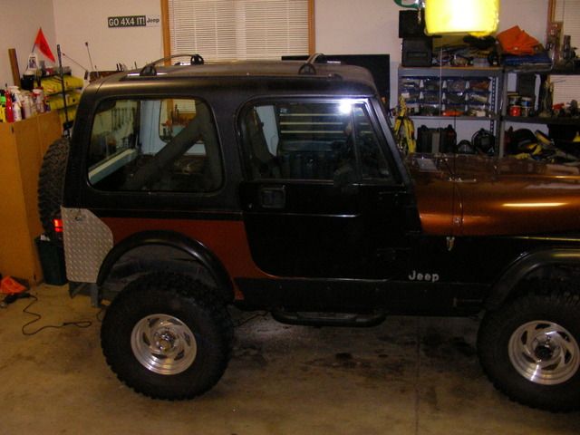

Fast forward through the usual brake and suspension work, throw an an old 8274, sliders, high jack and some goodies and you got this.
A decent trail Jeep, fun on the beach, but OH so underpowered with the 3.55's and 33's. Plus being open on both ends was no fun, so in go the 4.55's and lockers on both ends along with a 1 piece axle kit for the AMC 20 rear end and all new Spicer joints to limit the weak spots.

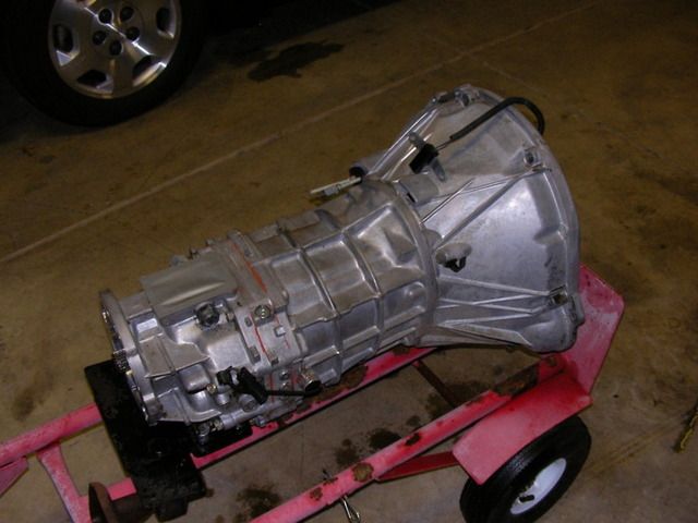

Transmission before:
Transmission after:
Amazing how fast rust starts on cast iron. Notice the water is not even dry and the flash rust has started:

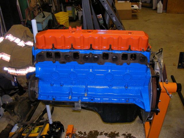

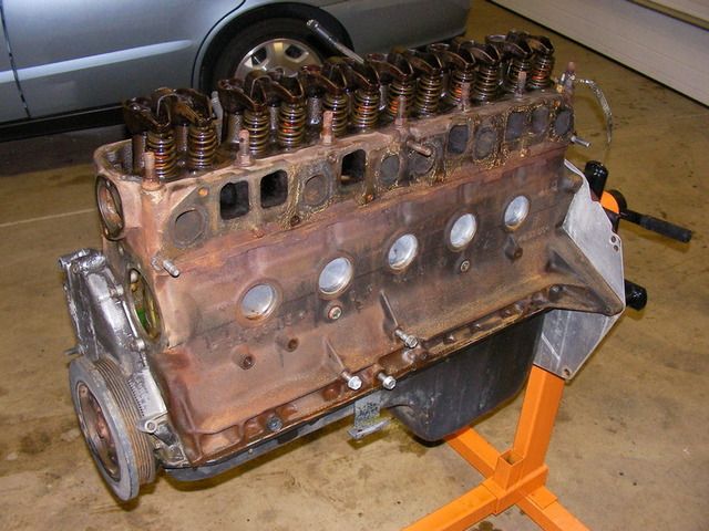

Progress has been made! Not a lot of spare time lately, but decided to pull the head off and check the lifters and interior condition while I had it out. Should have saved the time and head gasket, as it looked like any 120K mile 4.0 would with minor wear but nothing to get wound up over. Anyway, motor has gone from this when pulled
To this when decreased and power washed
To this
Which is Hemi Orange and near AMC Blue. I just had a wild hair when I did it but kind of like the contrast!

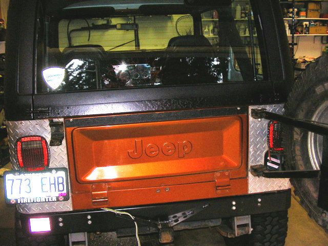

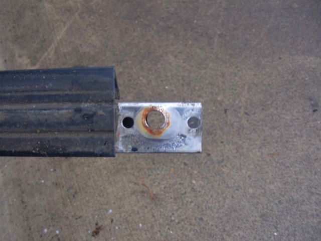

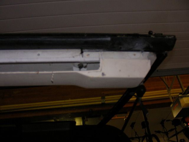

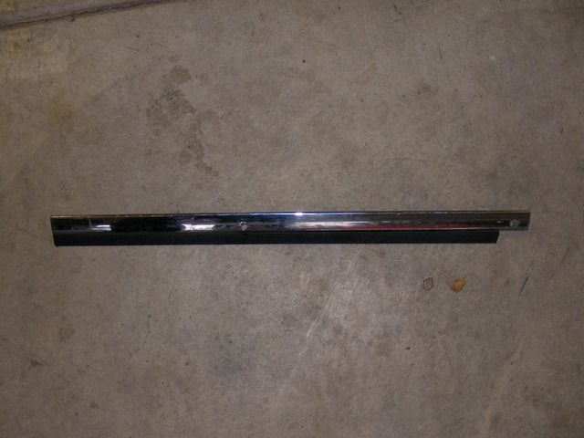

When I tore down the Cherokee, I saved the roof rack, thinking I might be able to use it for the Wrangler top I modified for the CJ. I cut 24 inches off the rails and re-drilled the ends for the end caps and mounting screws and bolted it on the top. Looks pretty good I think!
Here is what I cut off, and the end where the tips attach. I just copied the hole pattern on the new end where I had made the cut and popped the cap back on before mounting to the CJ

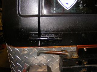

Folks ask how I modified the Wrangler top to work on the CJ7. I simply cut off the part that used to sit behind the Wrangler tailgate when it was closed and replaced it with a 1 1/2 x 3/8 thick steel stock and used standard gate latches to close it. They can be locked with a padlock if needed, but generally nothing worth stealing is left in the CJ anyway. A piece of canopy type adhesive backed foam keeps the back sealed and prevents rattles.
Hollow area is where I cut off the old tab that held the gate closed on the Wrangler
Metal bar pained to match with latches - most people don't even know it's not stock!
Close up of the high tech latch - almost looks like something AMC would have used in the day
