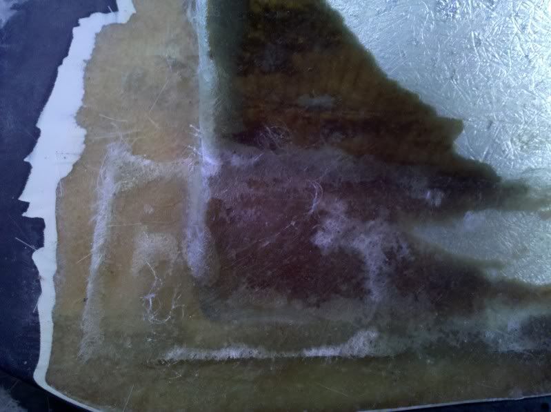

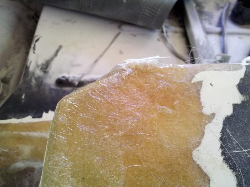

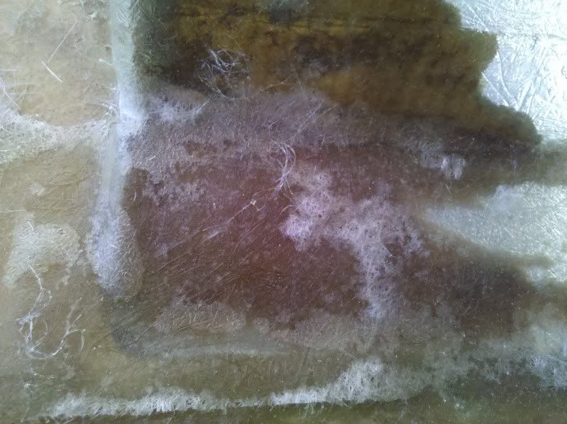

So, I went out before work today and tried to do the last of the 'glass layers. Didn't work out too well. The resin turned to a thick Jello consistency before I was half done with the first layer getting rolled on. I had gotten it in place by brushing the resin on first, laid the mat down, and started dabbing the resin on. I was getting some air bubbles, so I grabbed the roller and started working them out. I noticed that it was getting harder to get them out, then realized the resin was setting. I grabbed the "Helluva Good' sour cream and onion dip cup that I was using for the mixing cup, and the brush came out with half the resin on it like a Popsicle.. So I hurriedly cleaned it all up, saved the cup (the resin came out in one large molded shape) and cleaned all the stuff with Acetone.
Now, I have a layer on there, 90%covered in hard resin, and it is not perfectly in place. Can I just break the weak areas loos and glass over them, laying them back down the way they should be? I have a couple bubbles the size of a dime. Can I cut into it, add resin, and glue it down? I'd hat to have to sane on it, it is so thin yet with only the one layer in place, I know I'll go thru it.

Yes, you can break the weak areas loose, or you can finish applying the resin to the untreated areas, if I am understanding you right. Either way. Don't freak out or get in a panic. This is a perfect project to get a feel for how glass works. If you screw up, and you can't stand it, you just sand the bad off and do it again. Don't worry if it is not in the exact position you were wanting. Add pieces here or there, giving a couple of inches overlap in each case... that's for strength (better bond). Your mold (cardboard) is important too. Make sure it isn't going to move when applying pressure with the brush. I used sheet metal screws to hold the cardboard to the fiberglass fenders when laying down the first layer of glass. After it cured, I pulled them out. The second and third layers cover that right up.
Again, mix your ratios as accurately as you can. Buy the stuff you need to do so. 32 ounces resin to 10 CCs hardener will give you close to 30 minutes work time, depending on the heat and sun. For sure 20 minutes.
Let's see some pics...

Well, I don't have any pics of the screwed up layer yet. I was going to work on that part today, but my GF came over and dropped some goodies off (she's starting a diet to lose the lbs gained from quitting smoking), so we also hit Walmart for some other stuff she needed and that I forgot my last trip there. While I was out I bought new studs and stover nuts for the manifolds to be reinstalled. I got back home in enough time to put the studs in the head and the manifolds in place. Tomorrow I plan to have it running so I can move it in and out of the car port on its own power. That 2" step onto the cememnt pad from the gravel is just too much to push it up, and my Ranger just digs into the gravel when I used it to push the Jeep.

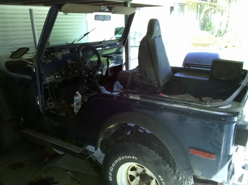

Picture time!
Looks so different without the roll bar!
Some pics of the dried-too-soon work..
