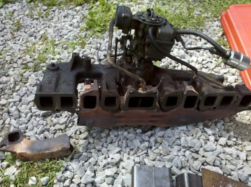

Well, today I tried to repair a stripped bolt that happened trying to repair an intake gasket leak a couple weeks ago. Drilled the hole on the head out, installed a Heli-coil, and put the stud I bought for it in place. This is the last hole for the exhaust manifold, the one at the rear of the head. during the installation of the manifolds, I did this:
I know the proper way is to separate the two manifolds, but the bolts and nuts were so rusted, I figured do it in one piece. I had done it before, when I replaced the gaskets the first time, so why not do it this time? Was about lined up, heard it pop like it went into place. Started putting the bolts in, since it all seemed in place. When I went to put in the one bolt, I noticed it didn't look right, and looked closer and found the crack.
Well, since we weren't busy today at work, I separated the manifolds, cleaned up the intake in the solvent tank, ran taps and dies over and into all the threads on the studs and bolt holes. It cleaned up well. I found some paint on it even - never knew it had paint on it under the oil and grime. If I had the kit with me, I'd have torn the carb down and cleaned it up, too. Oh well. maybe tomorrow...
Now I am in search of a new manifold. Guys at work are trying to convince me to just braze/weld this on, but we noticed a few cracks in the area that broke, like it was weak anyways..

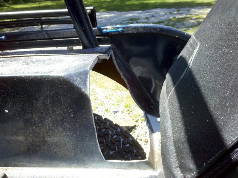

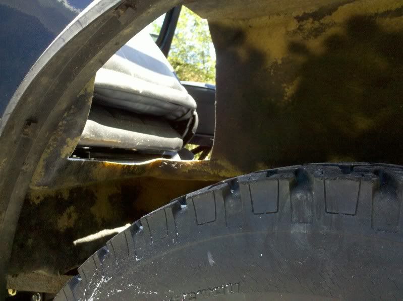

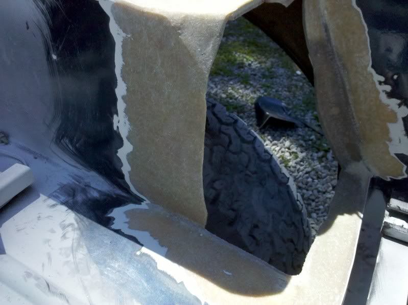

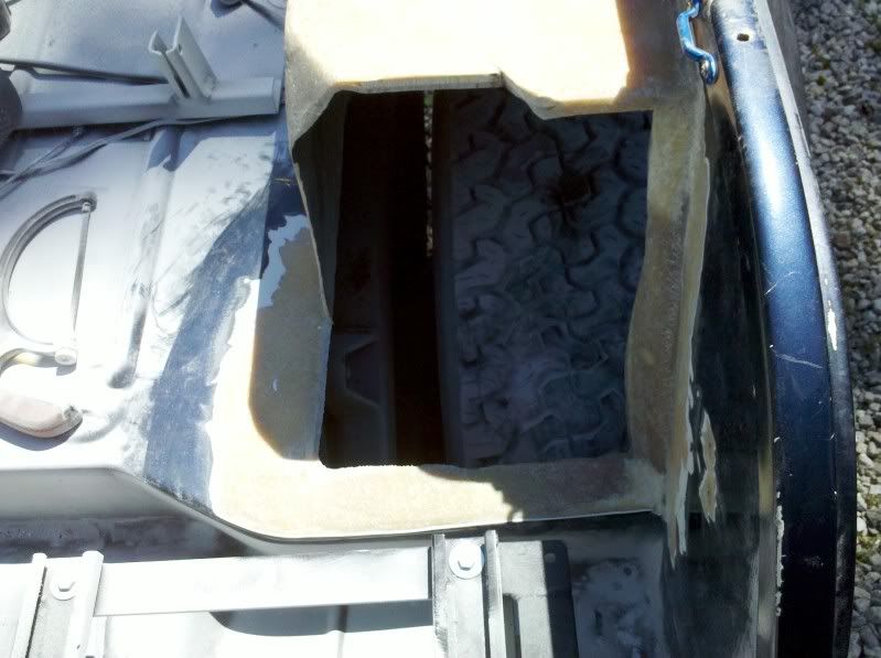

Well, I started my first ever attempt at fiberglass. Thanks to the help from SKerr and a few others from Clay's Build thread, I felt confident enough to start it.
Made my cut out after figuring how it would be best with the seat. Hope I''m not going to deep/large, to where the tire will hit. If it does, I guess I'll get more practice with the 'glass..
Sanded it back, using a 60 grit flap disk, since I had it left over from my Step build and bumpers..

The sanding and cutting looks great. I would make one suggestion, if it's not too late... smooth all your edges as much as you can. Your square corners will cause you to have air pockets (which you're going to have anyway, but you can reduce them). The red line in the pic is what I'm talking about. Otherwise, Rock and Roll, baby!

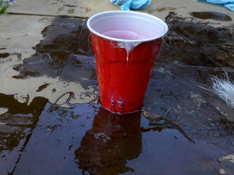

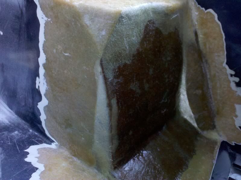

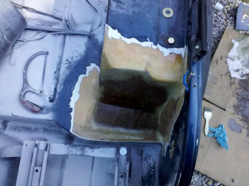

First layer in. I only did one layer this round, for 2 reasons. One was I wanted a solid base layer in to help keep the cardboard in place and to make sure it all comes out ok. Second reason you will see in pics below...
And the 2nd reason - resin melts Dixie cups!:
I had 2 layers worth cut, but the first one I did by the time I got the resin worked thru it, it had stretched too big, so I had to waste a piece of cloth. I think I'm going to get more anyways and do a few good layers on top of this base one, all at once.
And in case you are wondering, yes, there are air bubbles under the layer, but it is only between the cardboard and the resin-soaked glass matting, so it should hurt. I figure it'll make it easier for it to fall off eventually
