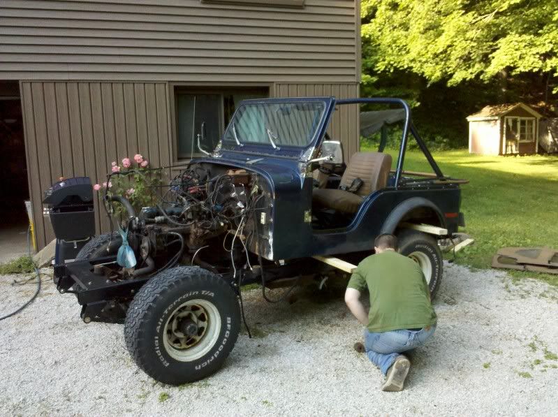

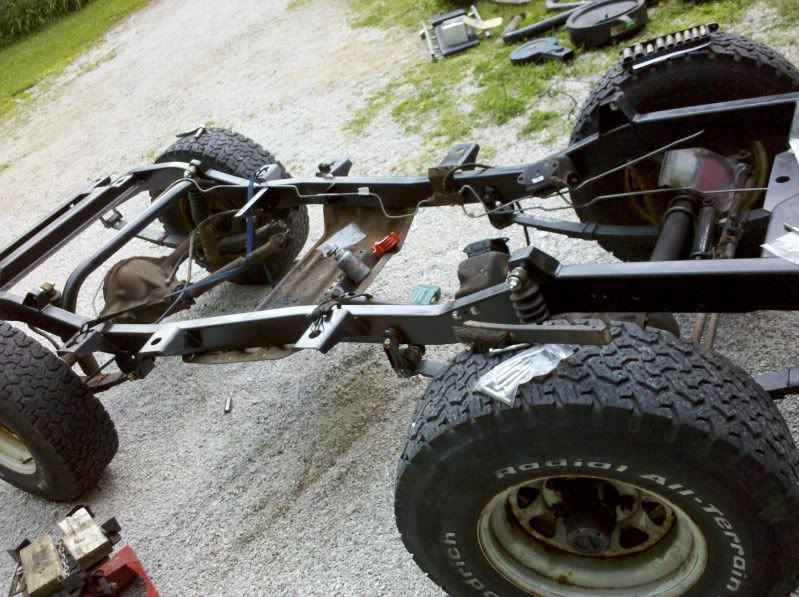

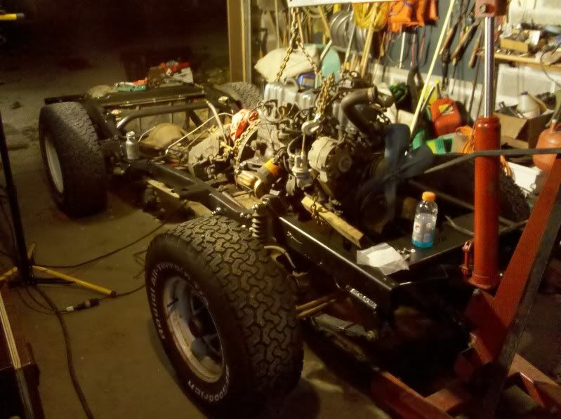

The 2nd day, I was on my own, except the little help Mom could do. She's still not able to do a lot of lifting from getting back to working after her surgeries last year from cancer, but she did what she could like help maneuver the rear axle around, move jack stands into place, and things like that.
Got the rear axle in:
Skid plate on:

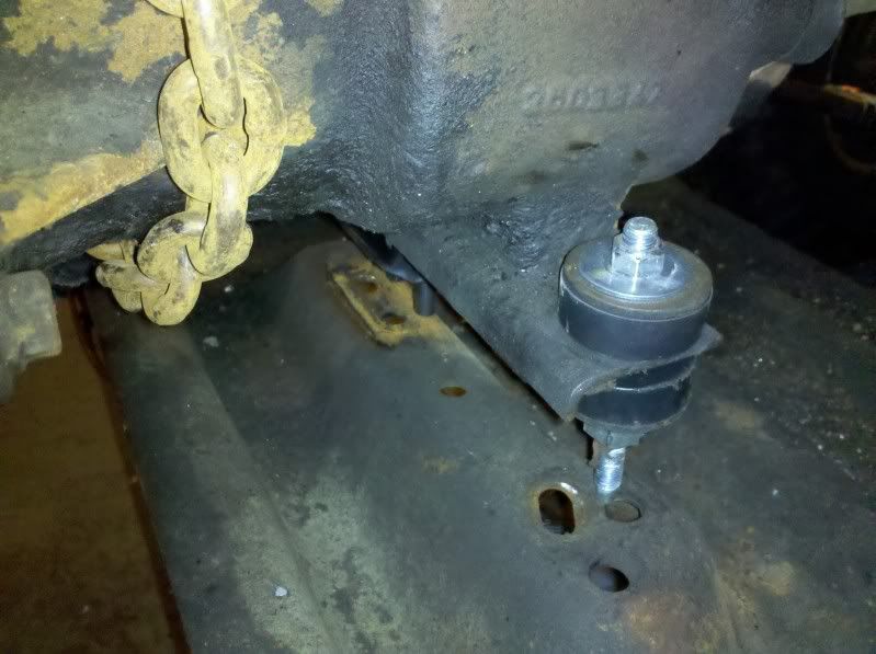

Set the engine in, but found my first major issue - trans mount wasn't going to line up:
Then after moving it around, looking it over, etc, I found that I had the motor mounts in the wrong holes on the frame part...
Then my 2nd issue. My Steering bracket when bolted to the bottom of the frame, wouldn't line up with the holes on the front crossmember. The scratches are where I needed the holes to be. Nothing a carbide burr in a die grinder didn't fix! A little paint to protect the metal in the holes, and it fit like it was meant to.
Powertrain in place:
Was expecting rain that night. It poured! Glad I had the top and had put it on, I was keeping some tools and parts in there:

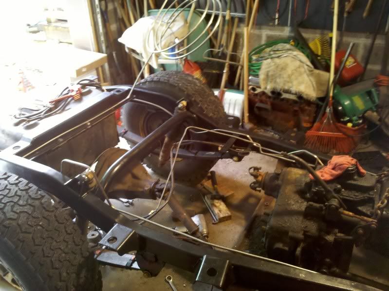

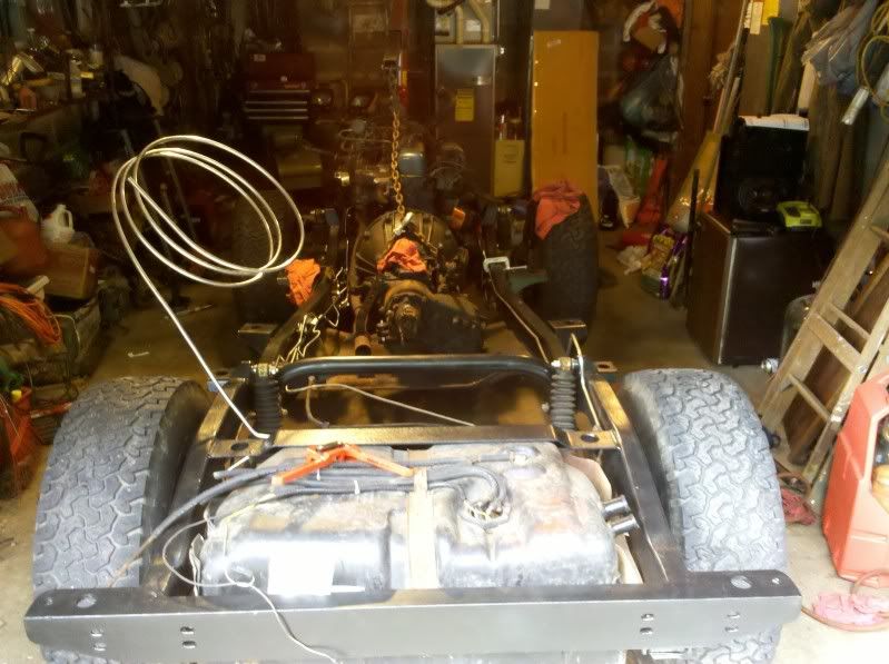

Brake lines roughed in, bending the main fuel line here. I used 5/16 and 3/8 for the fuel line and return, figuring if I ever decide to go with my EFI 302 plans, I'll want the larger lines. All brake lines were the pre-bent SS lines, and the fuel lines I had just bought the bulk SS line and bent them myself. I couldn't see paying almost $100 ber line for the fuel lines, and them not even being the size I wanted:

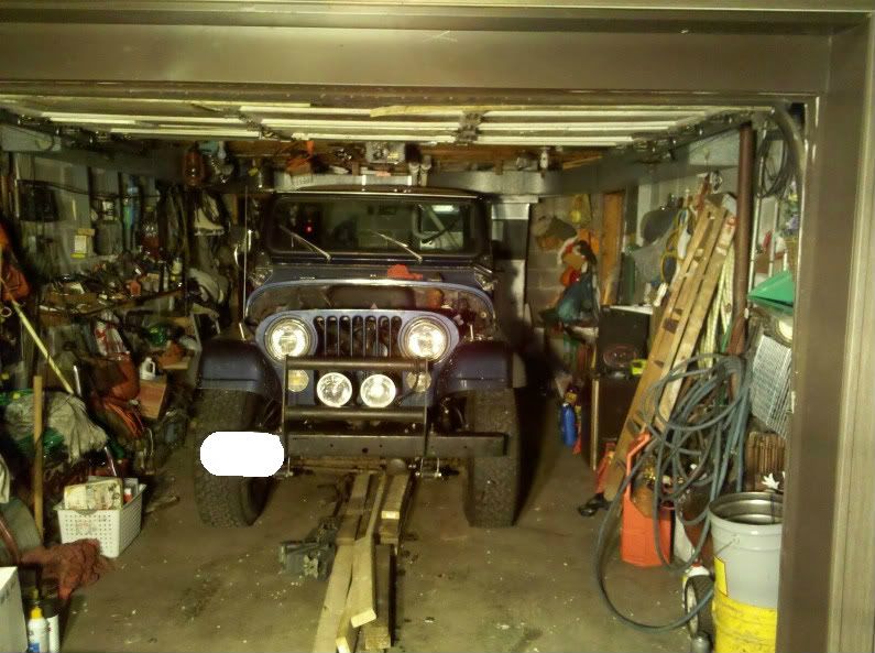

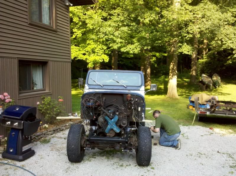

Thursday was pretty much spent doing all of the lines and some parts runs. Wednesday was the rear axle and other odds and ends. Friday my help came back with help. This is when the body and new chassis started coming together:
Wasn't many pictures I had taken here. I'll have to get the others from the camera Mom and my girlfriend was using later. They left around 8ish, so I put the grille and fenders on, fit the old bumper back on until I get the new one from the guy that is building it, and a couple little odds and ends. My GF and I pushed it into the garage for the night:

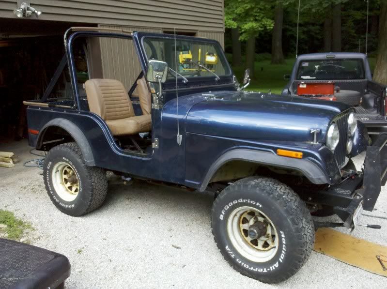

Saturday. By myself again. Took the bumper back off, drilled the bottom attachment holes out to 1/2 inch to match the top holes and also the holes in the frame. Got the hood on, radiator in, engine wiring hooked up, steering shaft back in. Bled the brakes, tightened a couple seeping brake lines, bled some more, tightened some more. Got the clutch linkage in and roughly adjusted. New e-brake cable from the pedal back to the equalizer bar, so I got it hooked up and roughly adjusted. Test drove it a mile or so, re-torqued the u-bolts. Tightened the brake lines again. test drove. Went over the u-bolts again. Adjusted the centering of the steering wheel after each test drive too.
Here's a picture I have from last summer, and then a picture of it the day I finished it:
It is now sitting level, at least an inch and a half higher from the new springs (compared to the original sagging ones). It rides so much smoother, the bumps are not teeth shattering. Even railroad tracks are not too bad to cross now. Once the weather is nice, I'll get another pic of it, only sitting in the same spot as the "before" pic, for a better comparison.
