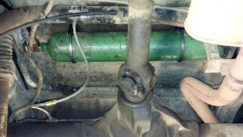

Was going to add some stuff here, and realized I never posted those pics of the tank mounted.
Here they are:
The fittings and check valve looking up from under the CJ. It all cleared the frame.
Plenty of room.
I need to add a drain to it some day. It is definitely thick enough that I feel comfortable welding a bung to it and putting a drain in the lowest point of the tank.
