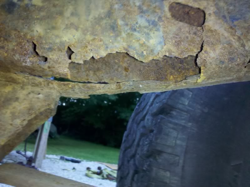

After daily driving it for the past couple years, the small rust holes in the frame have become gaping holes, some big enough to put my hand thru. The one behind the steering brackets went from a small crack to no more metal behind the box. I've tried taking pics, but they just don't really show up too well from the angles they were taken at. This rust issue prompted me to save for another frame. I was originally thinking of finding a used frame, replacing bad spots and restoring an old frame for swapping into the CJ, but I decided I'd rather go all new. I know my luck. All that work to repair a frame, and Ohio DOT would rust it out within a few years again with their salt on the roads.I bought a frame from TDK - galvanized, SRS, winch plate, and shipped to me, around $3400. 2 coats of POR15 and then 2 more of Chassis Black, I was able to put the new stock height springs on last week. FYI - if you go with a TDK frame, for the SRS they use YJ front frame bushings for the shackles. The CJ ones fit right thru the tube in the frame..

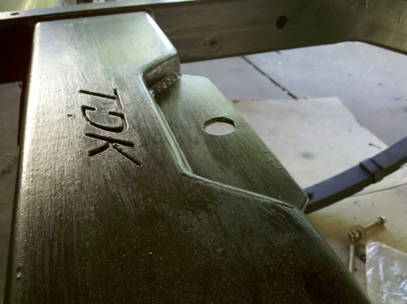

Ok, here's the pic of the front body mount under the grille I am wondering about. Is that metal piece welded to the front part under the rubber bushing an add-on? If so, am I going to have to have one made, or is it available as part of a kit i can maybe order from a kit manufacturer?
And then this is the front part of my new frame, no metal spacer piece..

Notice the steering box bracket in this next pic. The Top rear bolt was MIA, the top front bolt was rusted solid, and not tight. The bottom front bolt's washer had broken in half, and the half that was there was just snug. The bottom rear bolt hole as you can see if broken off, and the half of bracket there is getting chewed thinner from the box moving. Then the rust in the frame just to the rear of the steering mount area is a good example of what was behind the box too:

The brake lines and fuel lines, as we were tearing it apart, were just crumbling and breaking. I was so glad I was able to get this done when I did, and this is also why I didn't do anything too extreme in my CJ. I was afraid it would break in half, or worse yet - the steering box fall out on the highway!
