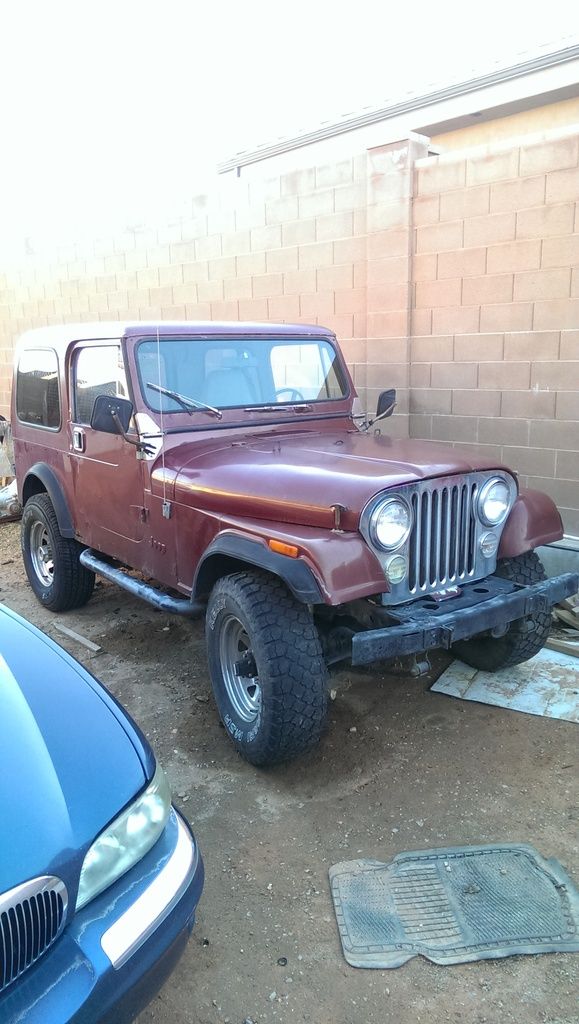

So a few things first this project is my dads jeep, I'm gonna be helping him restore it mostly because its something that he really wants to do with me that interests actually interests me to and secondly he doesn't know what hes doing when i comes to mechanical things. Also My dad is also the Jeep person and I like Chevy's hence the reason I'm new here, I have never restored anything before and since this is my dad's jeep once I want to do it once and do it right, and if he treats it like his first one it should make it another 398,000 miles.
So I'm gonna go through this probably scanning the forums but that the same time I'm posting here for help since I really don't know anything about jeeps other than after popping the hood on my dads it may as well have been made of legos it doesn't appear there is much too it, it actually makes my s10 look overly complicated. but I'm hoping more for advice on on certain niche things with a jeep that I'm probably not gonna have to worry about say on my Sonoma.
So far my short plan list:
-Keep it stock as possible, not lifting it, it must keep its inline six. must stay manual.
-get rid of rust everywhere, painting the frame possibly rihno lining it, replacing doors and tub also going with a fiberglass tub.This one possibly if anyone has had experience with the company.

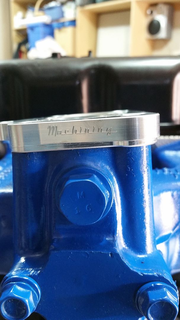

-converting it to EFI with megasquirt I've got access to some mills so I may just modify the carburated intake for injectors keep it simple as possible.
-possibly rebuild the engine depends I'm gonna try and start it and I'm gonna take the head off see if it really has the 60k miles the previous owner claimed.
Anyways that what I've got so far that I know for sure of i'll get pictures up soon but I'm gonna try and get it started. also where is a good place to get good parts for these things, I'm not concerned about cheap but as long as its good my dad doesn't mind paying a little extra for them. also all advice is appreciated.

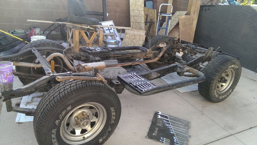

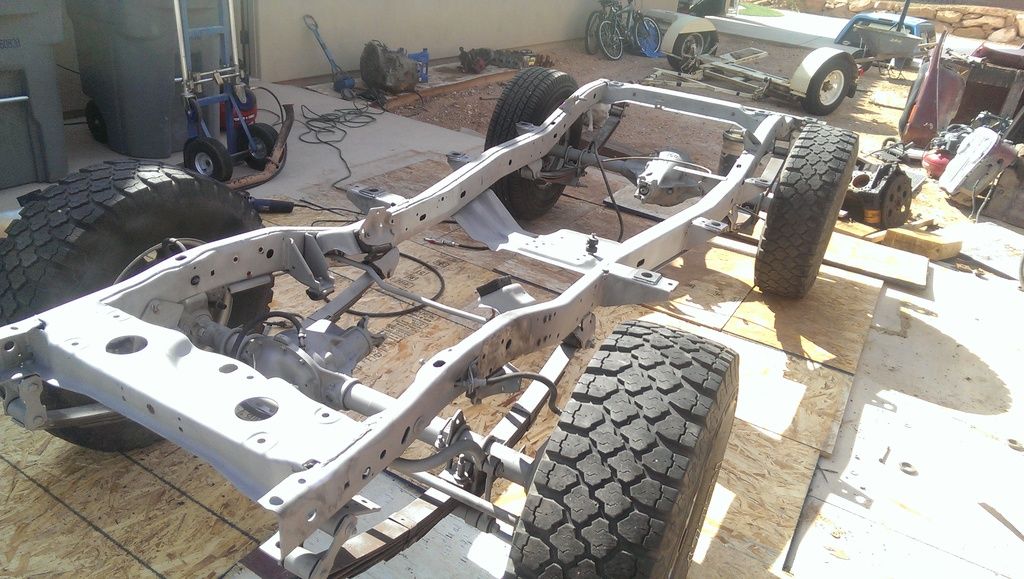

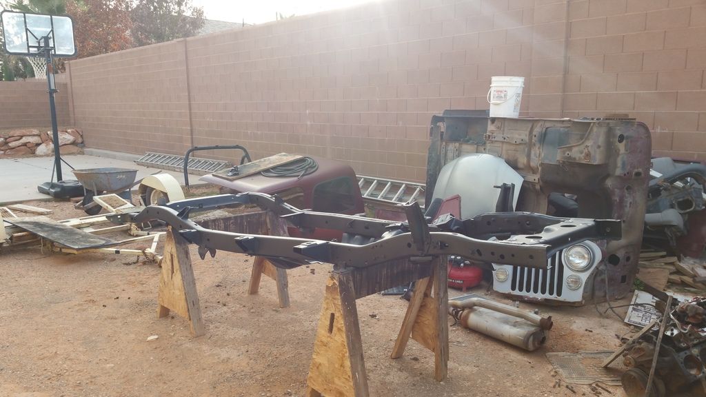

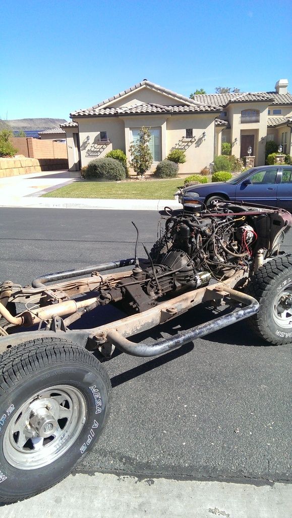

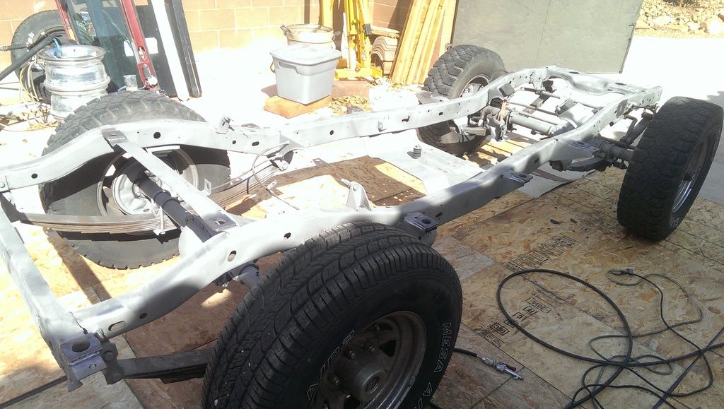

We pretty much have the jeep completely stripped down we just had it sandblasted, the rusted body mounts fixed and we've primed the frame. I'm looking for parts tonight so we can start building the thing from the ground up. Also a few things have changed from the previous list of things we were planning on doing. Since Febuary I have picked up a chevy TBI and I still need to get the wiring harness and computer from a manual 4.3 s10 or fullsize considering the jeep motor is a 4.2 I should easily be able to get away with out tuning it for a little while. I have a friend that has a cnc mill so I have a way to get an adapter for it. still need research and stuff for getting the computer to read the jeep distributor or something aftermarket I just need to look it up really, I'm sure its out there. I also think I have my dad talk into some headers I found on summit, that stock manifold is dreadful looking. I also have the engine pulled apart the engine that the previous owner claimed was rebuilt 60,000 miles ago. which is quite likely but who ever did it messed up because there was a snapped head bolt and the motor had antifreeze in the oil, but the pistons look clean on the sides the top says it was running rich but the carbon brushes right off. anyways thats what I can think of on the top of my head. anyways pictures I forgot about those.

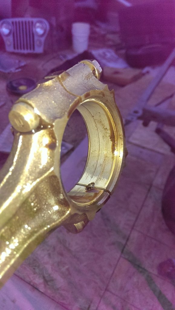

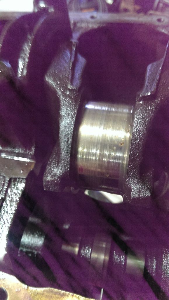

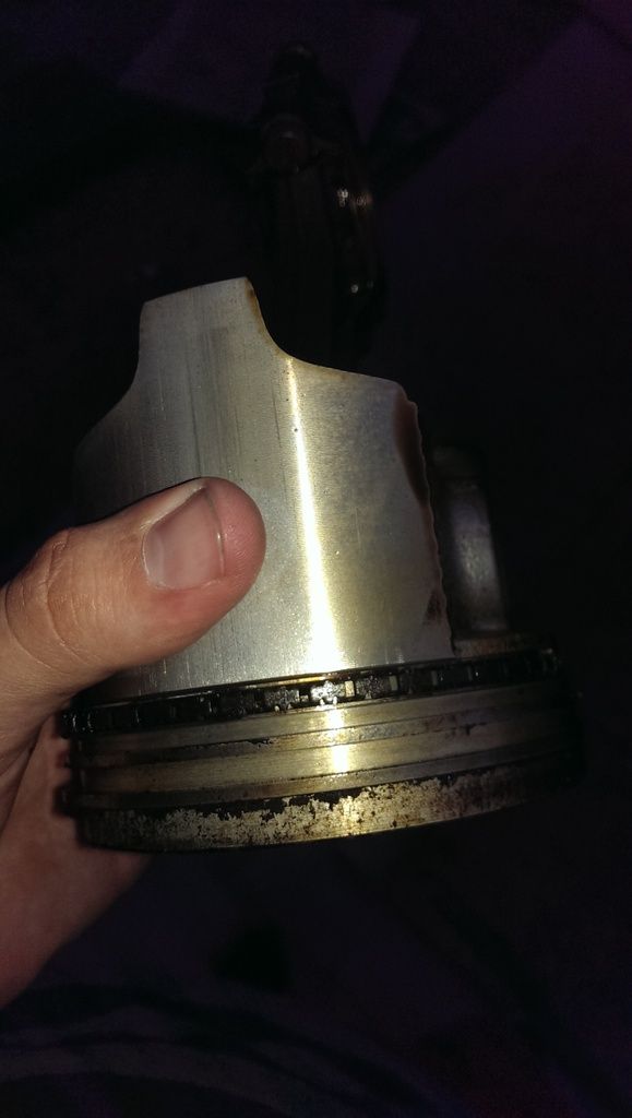

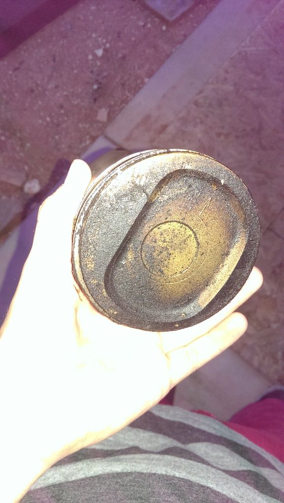

also any advice for avoiding whatever happened to the motor would be awesome because I would love for this motor to last as long as his first jeeps did. which was about 330,000 miles.

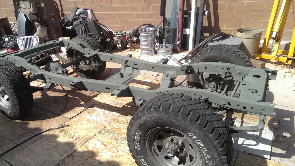

So working 70 hours a week doesn't provide time needed for a jeep, so I quit one and now i'm down to 20 hours a week and have time for the jeep. I'm also moving in like a month so I've got 4 weeks to bring this pile of steel to life. I will have it running by January although I will not have it street worthy sadly but it'll be ready for a tub and body parts which are 6 weeks out. and I know my dad can handle installing that without me. I'm gonna try to update this daily except for saturday and sunday those are my days to fix annoying s10 problems before i move to idaho.
anyways heres the few things I've got done since last post.

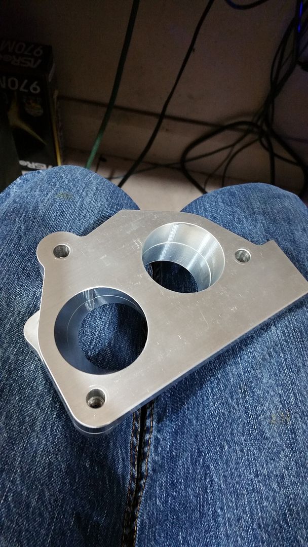

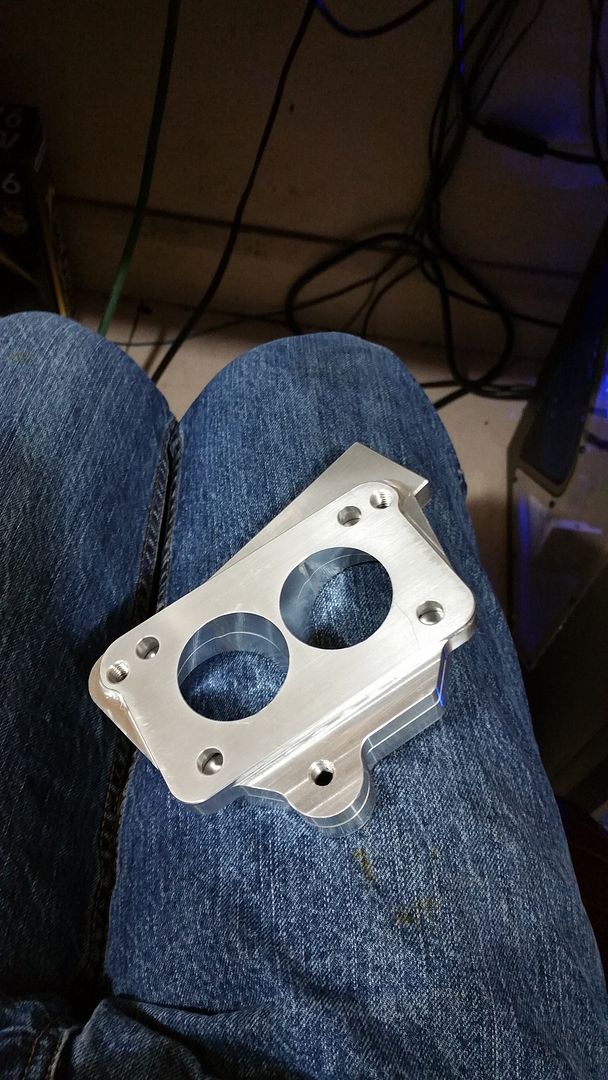

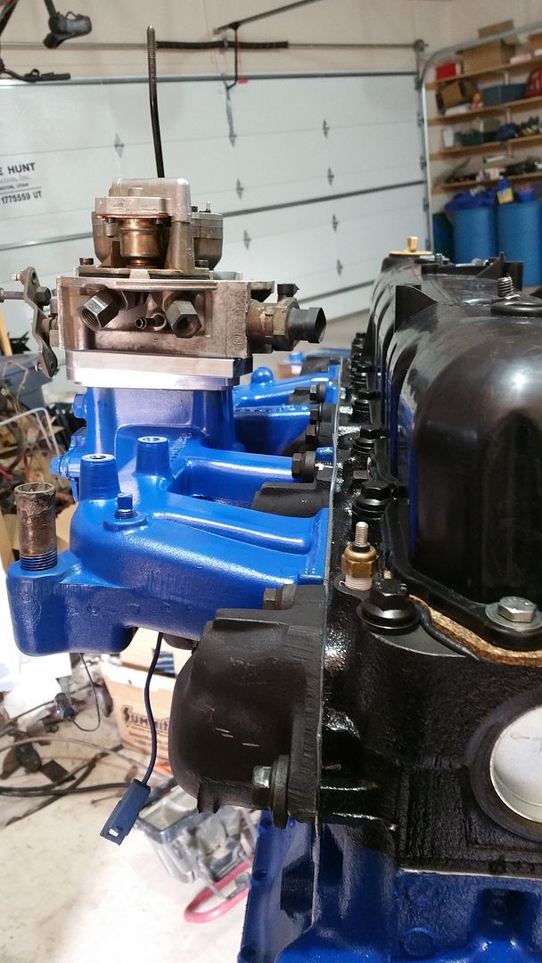

my friend helped me make a adapter plate for the jeep intake to GM TBI.

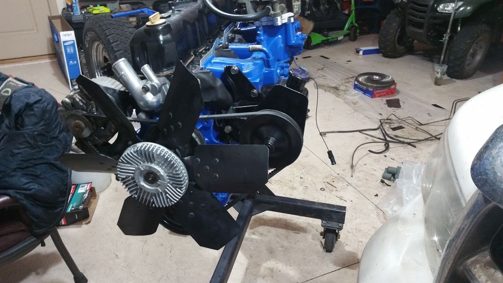

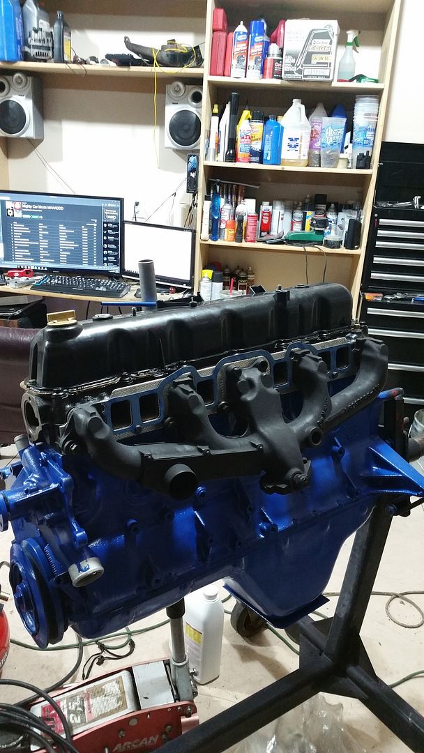

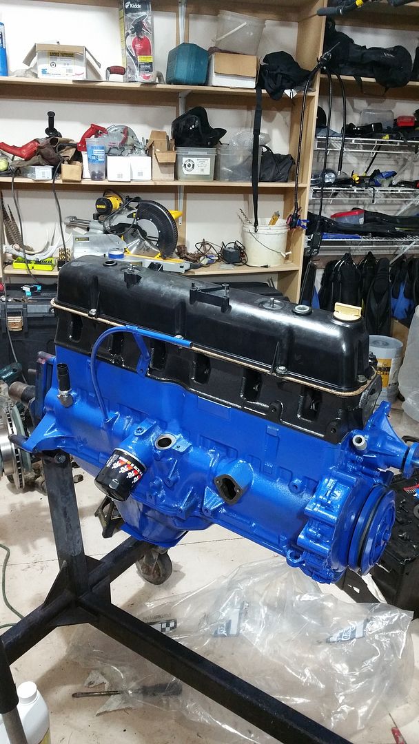

I got the parts back for the motor and reassembled it most of the way, I'm hoping to have that done tomorrow.

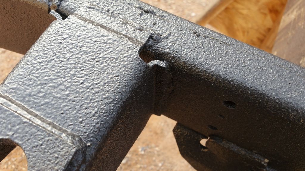

I sprayed the frame down with bed liner(pictures on broken phone)

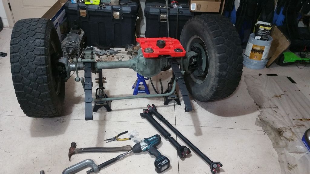

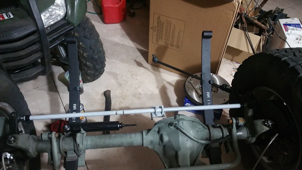

reassembled the front axle with new bearings, seals, spindles, rotors, u-joints, and fresh grease.

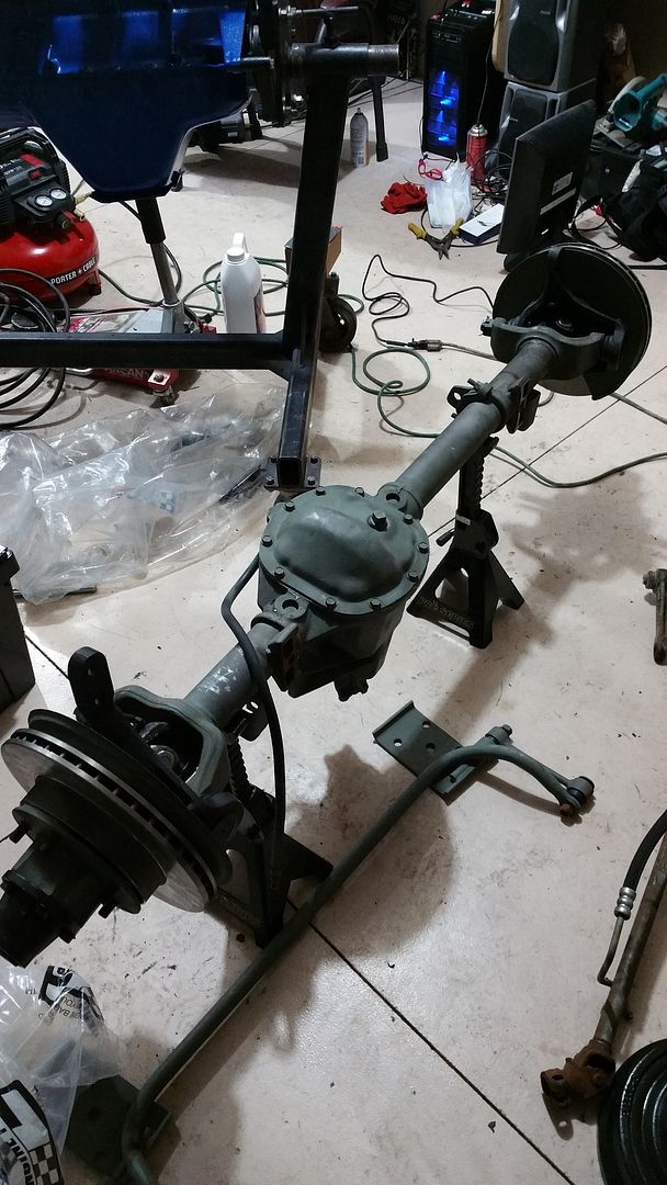

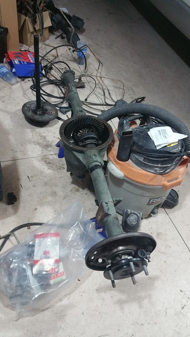

I rebuilt the trac lok in the rear end, but installing the 1-piece axles was becoming a headache and my dad offered to pay someone else to do it so i figure whats the easiest way to do something and that would be get someone else to do it.

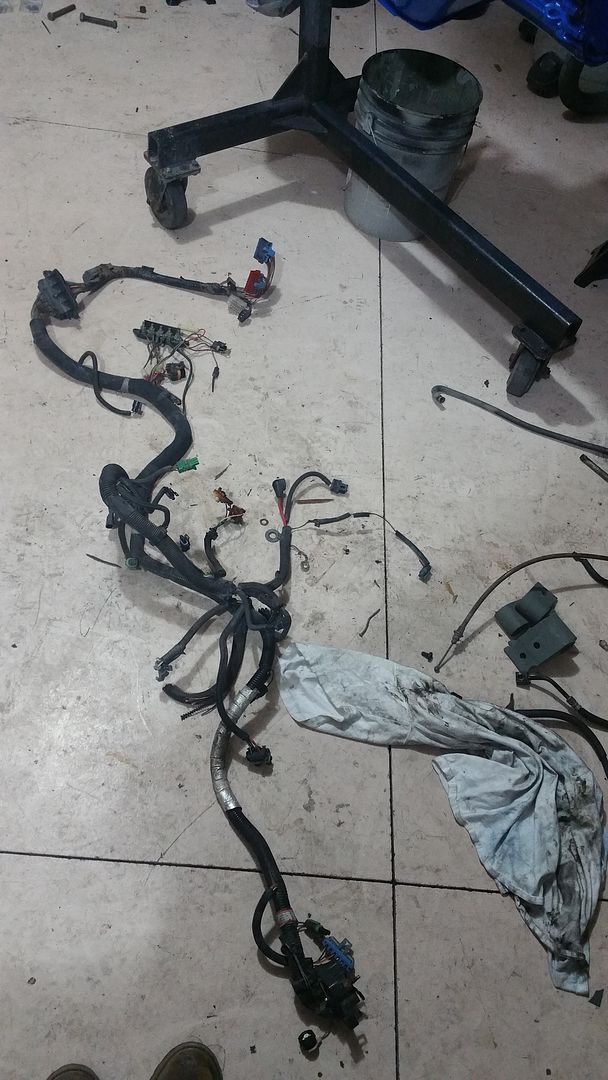

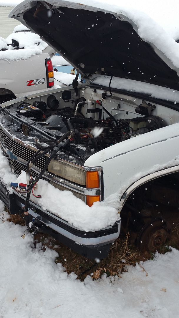

I really didn't get anything done today I went to a junkyard pulled the wiring harness, ecm, and throttle cable out of a 1993 chevy 1500 this junkyard also didn't have a dog they had a pig which was kind of cool at first other than it followed me to the truck and just walked around making pig sounds while i sat inside the engine bay disconnecting the wiring harness for an hour I kind of wanted to kill it for bacon and also it was getting extremely annoying which is probably the main reason i wanted it quite but, bacon did sound good. I also finished cleaning the tie rods up and assembled those and installed them, and I ended up drilling and tapping a hole for the knock sensor, I also got a new distributor because the other one had a Phillips screw seized in and sripped of anything to turn it with and it had a broken wire so 40$ was worth it.
Trying to keep positive on how this is going to be fun redoing this wiring harness, because everything going to go smoothly and im not going to mess any of it up*knock on wood* x100

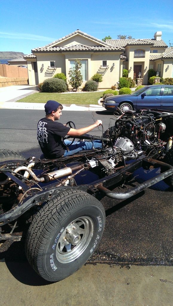

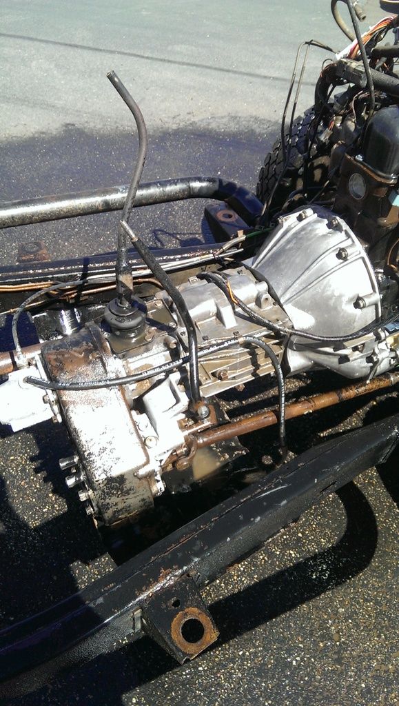

Today I ended up getting the axle installed to the frame with the steering box and the motor and transmission installed along with the distributor and wires. and I soaked the steering shaft in some vinegar which did a good job removing rust so i'll be taking the scotch bright and vinegar to clean the rest of it. I'm also going to be picking up the rear end tomorrow from the shop but all they did was order parts for me and said install it yourself and they keep referring to the parts as shims which will be maddening if that is case because shims won't do me any good for one piece axles i need spacers! But the guy said hes installed one piece axles before on jeeps so i'm hoping it got mistranslated somewhere.

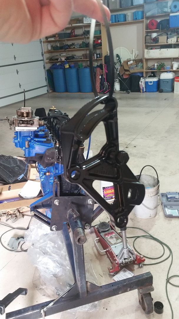

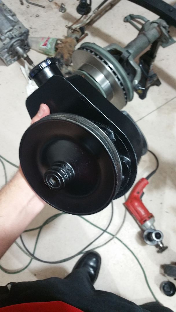

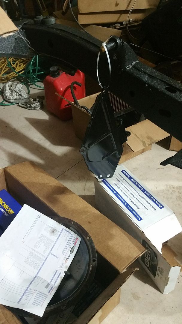

So i didn't get too much done today, just painted the steering shaft and clutch cover, installed the starter, and got part of a brake line started. I did pick up the rear axle and told them to send the shims back so much for the guy saying hes installed several one piece axles on jeep no problem. so instead of working on the jeep I spent a few hours looking for some parts which I finally found after talking to summits tech guys and it so happens that they had mis-categorized the spacers and press rings. they had the spacers labeled as being used for a AMC 35 axle, and the press rings were labeled as a being used for a Dana 20 axle, so I have the right parts on there way along with a new power steering line that was seized into the old gear box and a couple K&N oil filters for my dads cummins and like 4 for my s10 figured might as well get free shipping right? also got a new rubber boot for the steering shaft and a fuel pump block off plate so i could finishing sealing up the block since the paper towel isn't going to be a permanent seal for that hole.

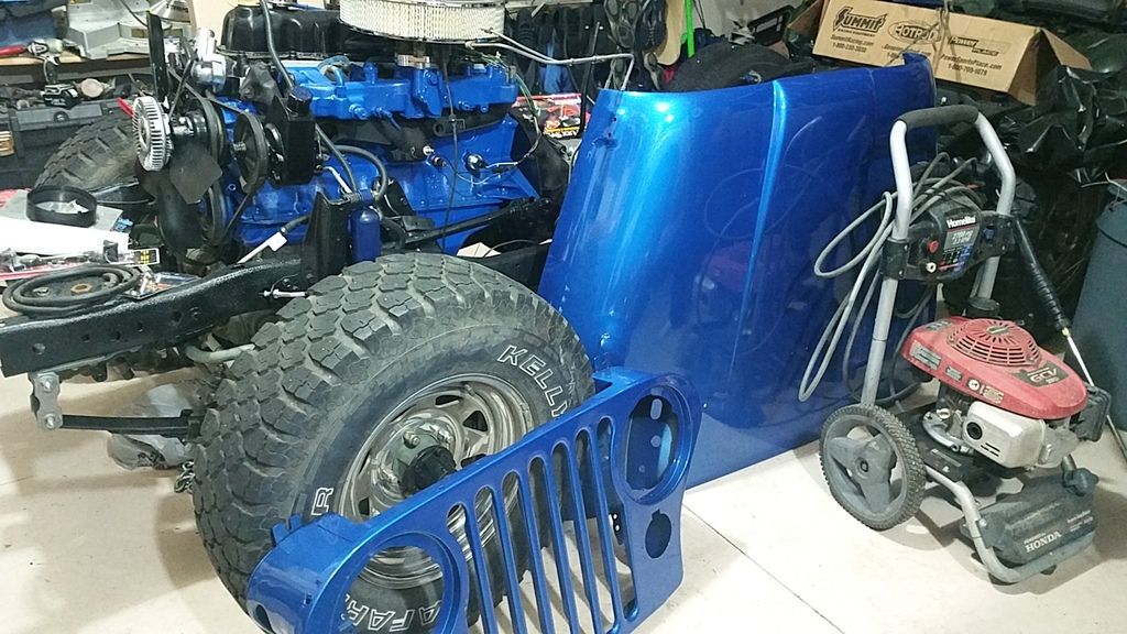

I'm back and I have a week to finish. My dad has been busy getting things painted and I have been at school for software engineering learning C++ and becoming proficient in profanity++. Anyways I'm gonna be down here for a week and i'm going to finish the jeep this week and hopefully get it started so I can be done with it. By the way I have read a few break in procedures for rebuilt motors a few of them say to let it idle at 1500-2000 RPM's for 15 minutes or so to break the cam in, would you guys agree with that?

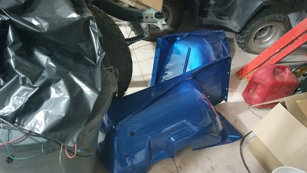

we decided to go with a brand new rust free tub, got it on amazon from eastcoast jeeps for 3400 most of the holes seem to be where they are needed. other than still need to cut one for the gas fill.

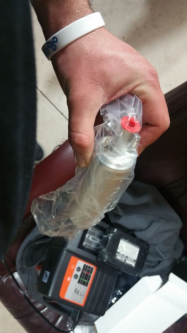

External fuel pump.

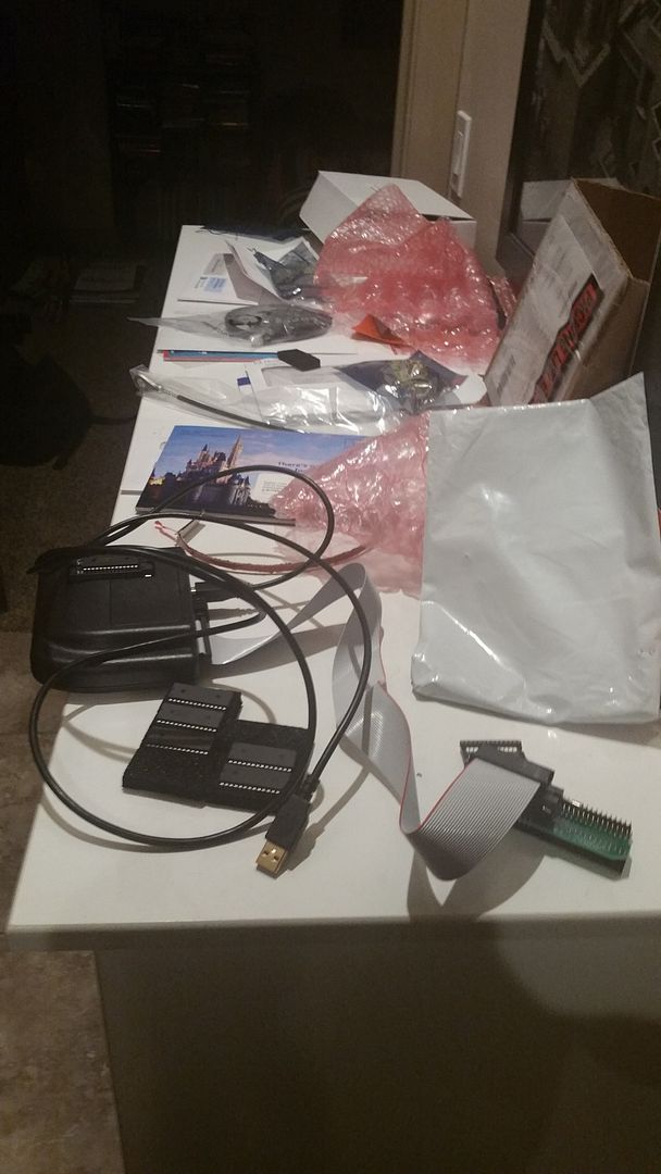

Tuning equipment from moates
My dads state of the art flying brick is a CJ7, mine is a Suburban.
MechroMenace is offline
I see that it is a Repli-tub that is made in the Philippines and will need more than a few holes to be cut. The Repli-tubs have improved over the years but there are still a few minor flaws that you will need to address.
1. Need to cutout the electrical bulkhead firewall square hole larger to fit 1984 electrical wiring harness.
2. Wiper/Washer spray nozzle hole needs to be drilled.
3. Battery tray mounting holes.
4. Heater assembly mounting holes in the firewall. Not so easy but at least they now have the bump out hole in the firewall for the lower flap pivot rod to clear.
5. Charcoal canister mounting bracket will need to be shimmed out as it will not fit over the firewall/floor pan seam.
6. Fresh air grill on the cowl needs additional mounting holes made and countersunk.
7. Roll bar mounting holes need to be drilled.
8. Seat belt mounting holes need to be drilled.
9. Taillight mounting holes.
10. Spare tire swing out bracket mounting holes to be drilled.
11. Possible floor shift plate may need to be enlarged also.
Show some better pictures of the tub if you can. Front, inside floor, rear floor and back end please as I am interested on how they improved them from my 2006 version of the Repli-tub. There is a thread on the subject as well. Can be found here: http://www.jeepforum.com/forum/f8/tu...pines-1480423/
