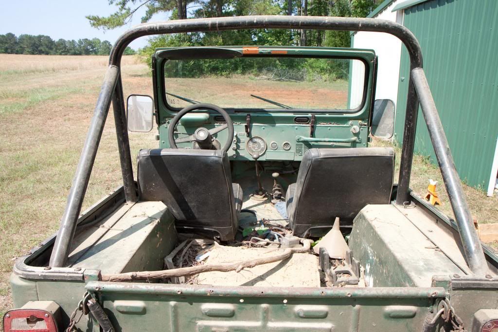

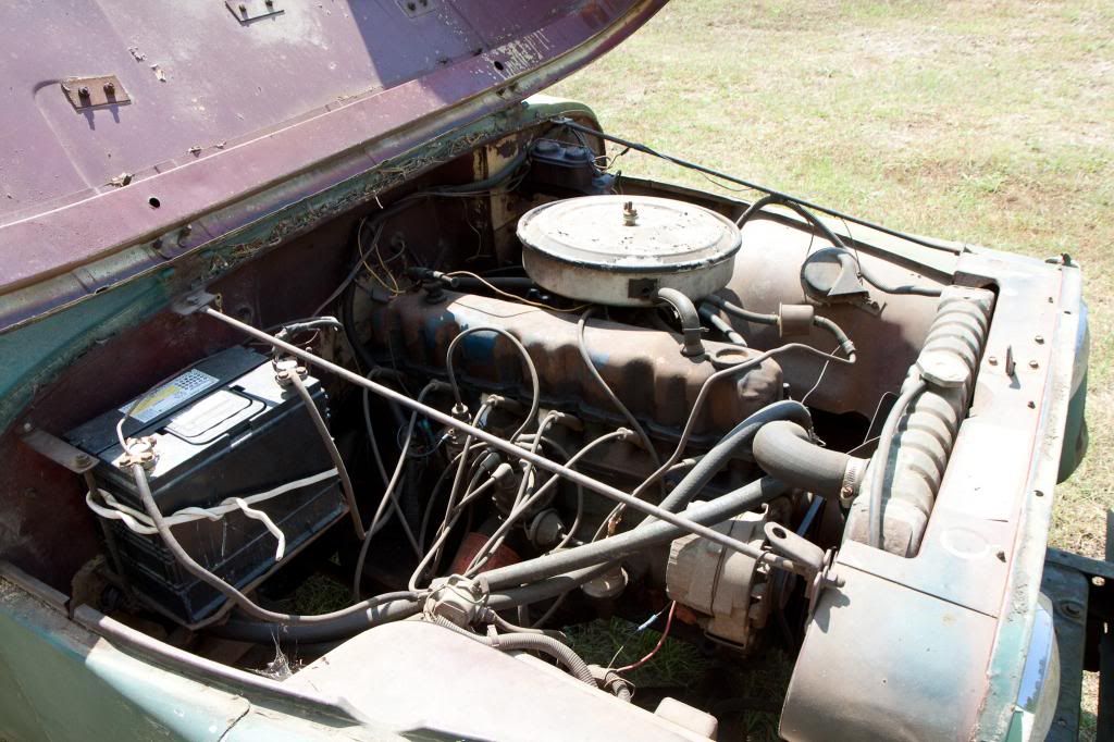

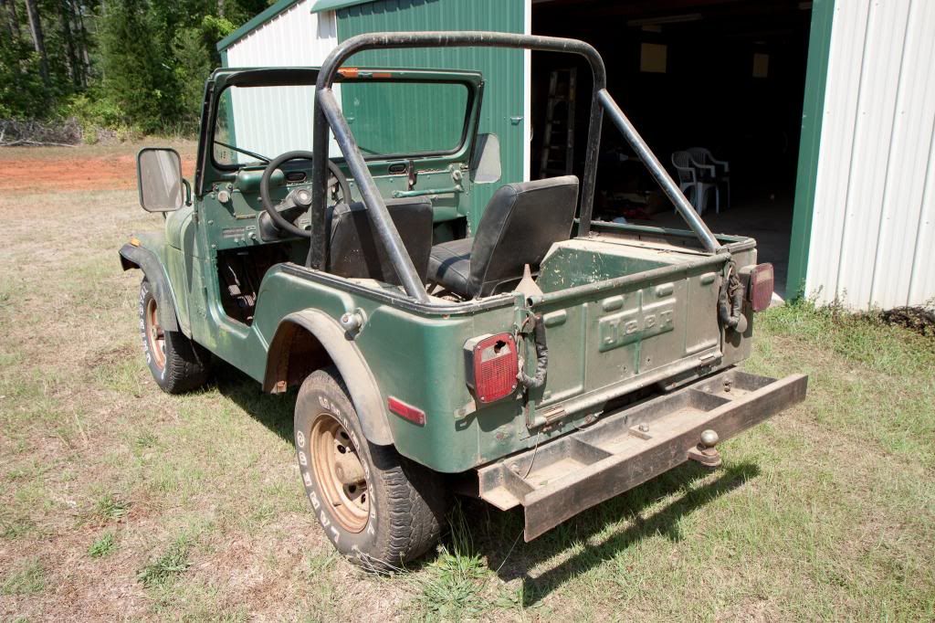

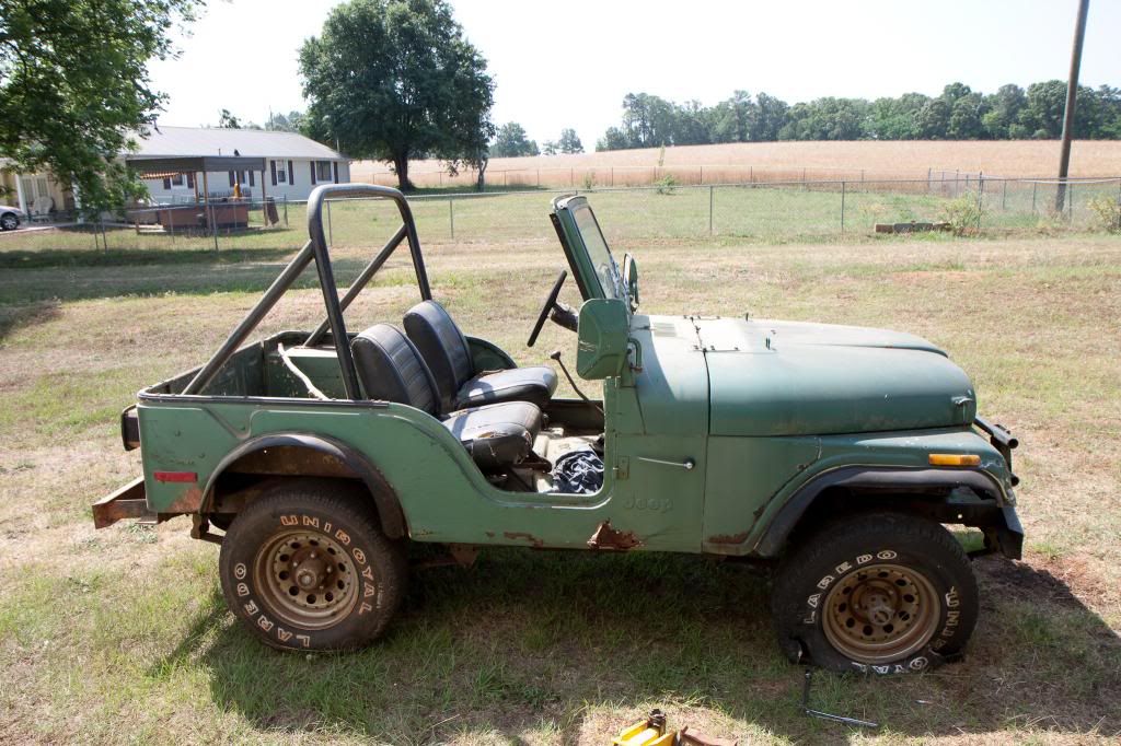

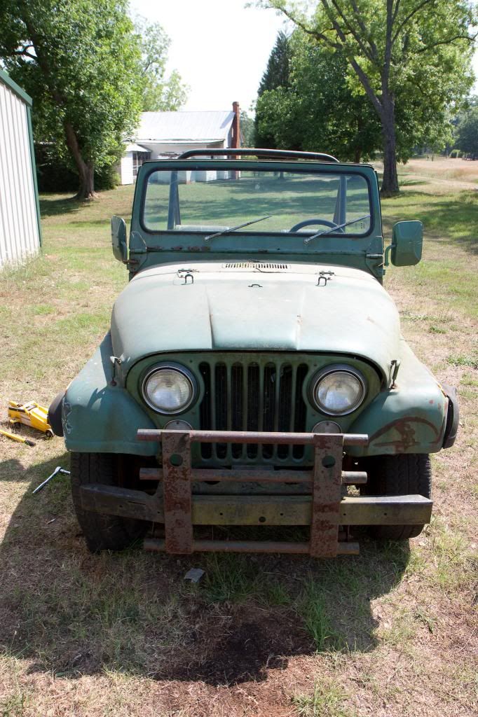

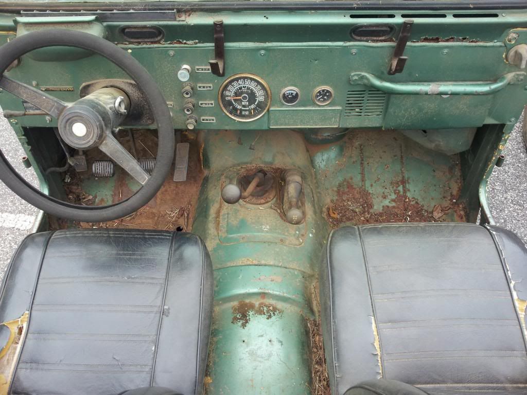

This is what I started with.
So the first things first is the tear down. Pics coming soon...

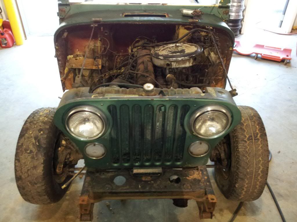

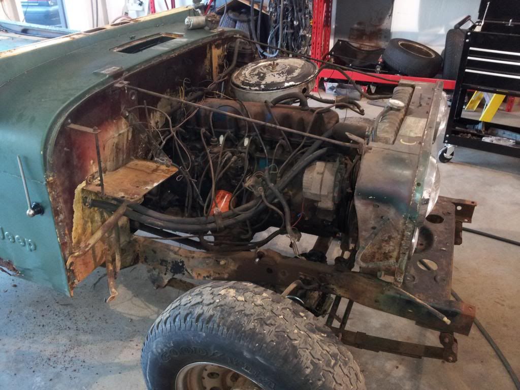

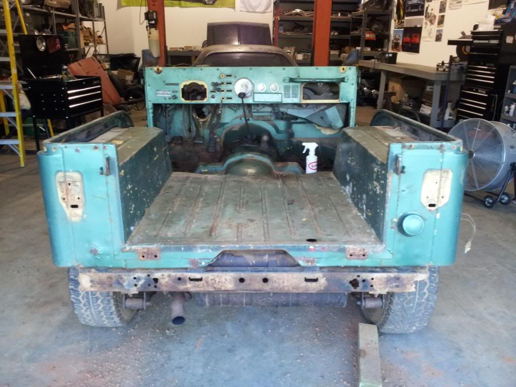

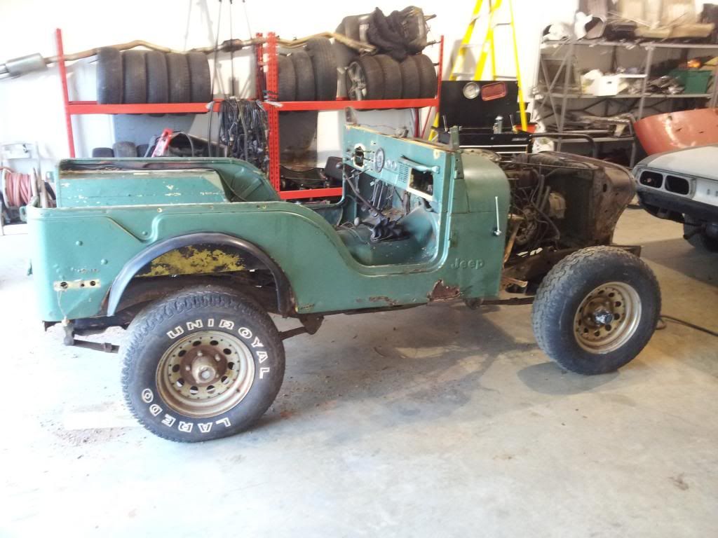

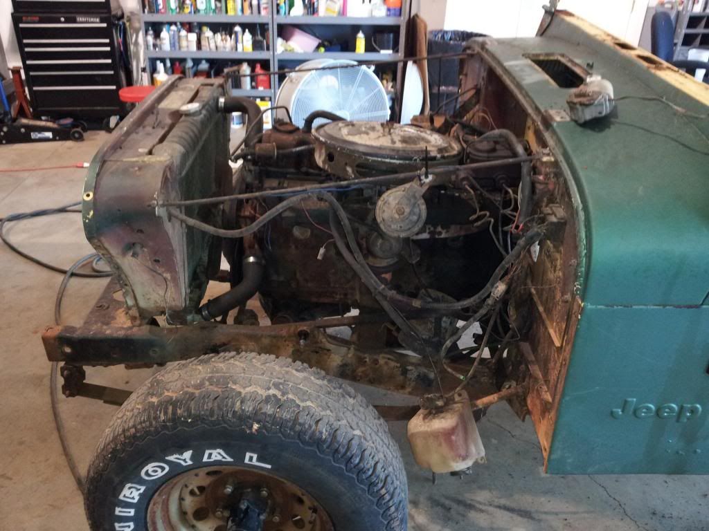

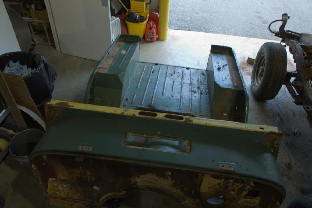

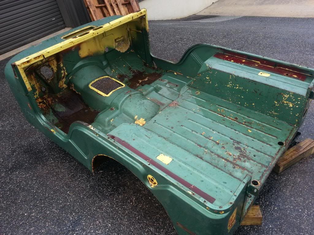

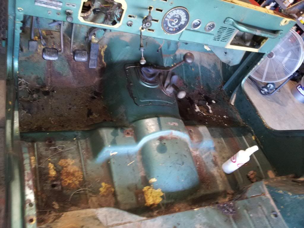

So I pressure washed the interior and cleaned the crap out of it. Then started the tear down. Here are some pics of the beginning of the tear down.

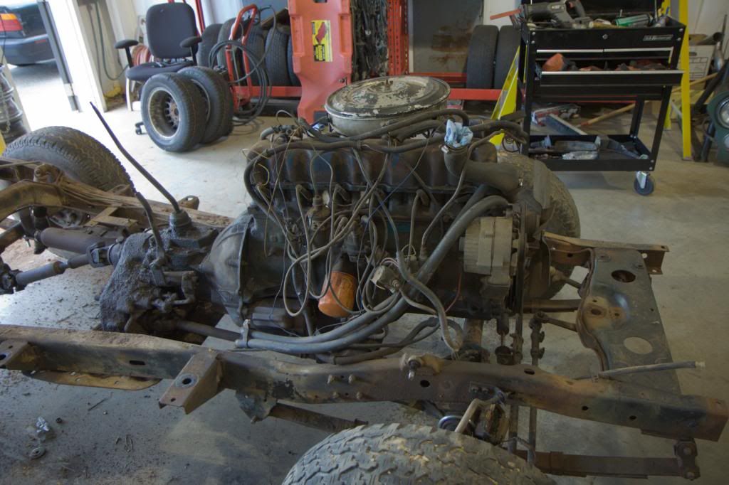

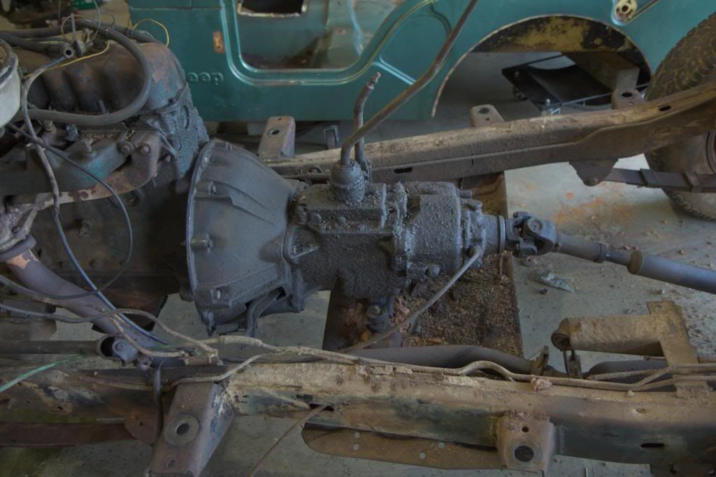

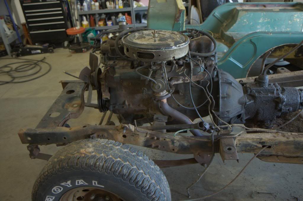

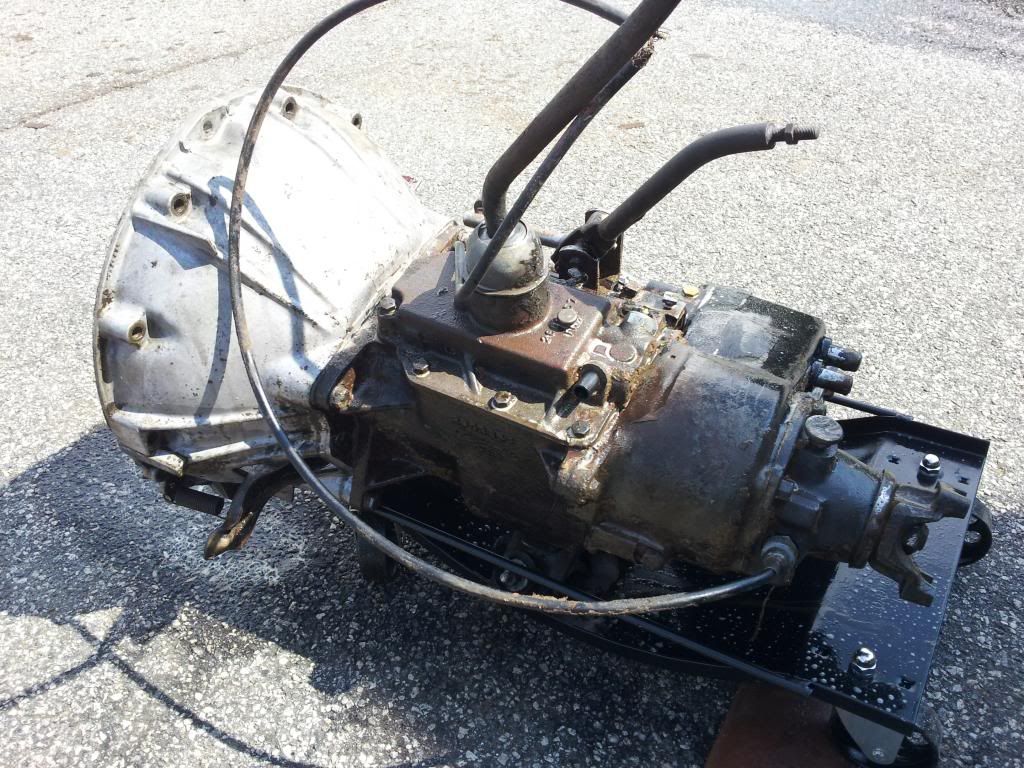

I'm jealous of your tailgate. The shifter for your T-150 is interesting - the bend in it is the opposite of mine (i.e., it looks like it is mounted backwards, or mine is...).

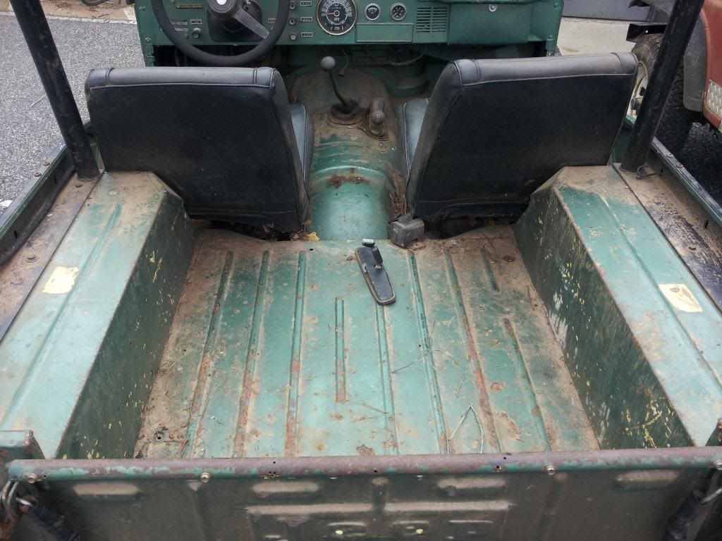

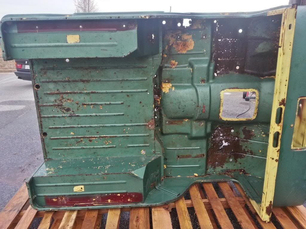

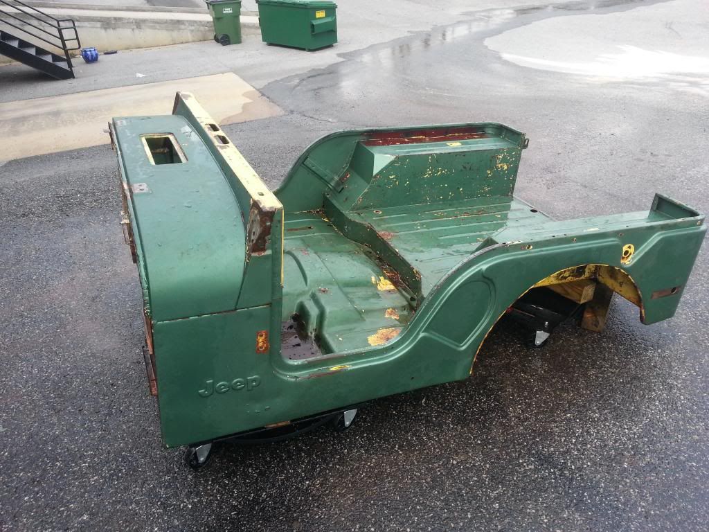

Taking the tub off was not fun, most of the cage nuts spun and had to be cut. I'll be drilling access holes in the tub to use normal nut/washers. This thing is filthy... Also found out it was originally pale yellow, then had a decent red paint job put on it, then a really cheap green paint job.

BlkCJ7Laredo
BlkCJ7Laredo's Avatar
Join Date: Mar 2004
Location: Potsdam
Posts: 1,057
Looks like you're off to a good start! The tub looks very salvageable and the frame looks to be in great condition as well. This should be a beauty when it's done.

CJ5Russ is your transmission a 3 or 4 speed? From the bend of the shift lever it looks like it could be one of more desirable CJ T18 4 speed transmissions. According to the Novak's site these could either be the 4.02 or 6.32 first gear models for the 1976 CJs.
JeepinEng is offline
post #9 of 255 Old 10-19-2013, 10:27 PM Thread Starter
cj5russ
cj5russ's Avatar
1976 CJ5
Posts: 325
It's a 3speed t150. I'm not sure why it looks backwards.

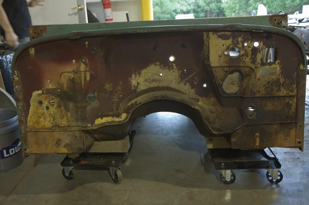

post #11 of 255 Old 10-20-2013, 05:28 PM Thread Starter
cj5russ
cj5russ's Avatar
1976 CJ5
Posts: 325
Unfortunately it was partially painted over in the cheap green paint job i mentioned above... Plus the dash has all kinds of holes drilled randomly i assume for toggles that are not there, the gun rack was also drilled through the dash and it has a nice crease in the 90 bend at the bottom right in the center. I think I'm going to go with a SS dash and paint that to match. (this will also get me a tach hole, clock hole, stereo speakers, and a DIN speaker slot.) I have been looking at companies that will do repro VIN stickers though, anyone know anything about them? (I'm planning on posting another pic update of later tonight)

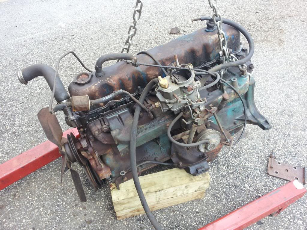

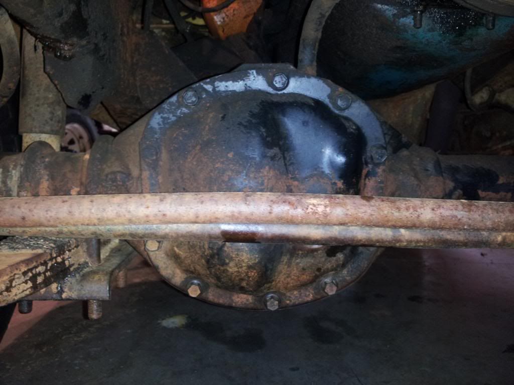

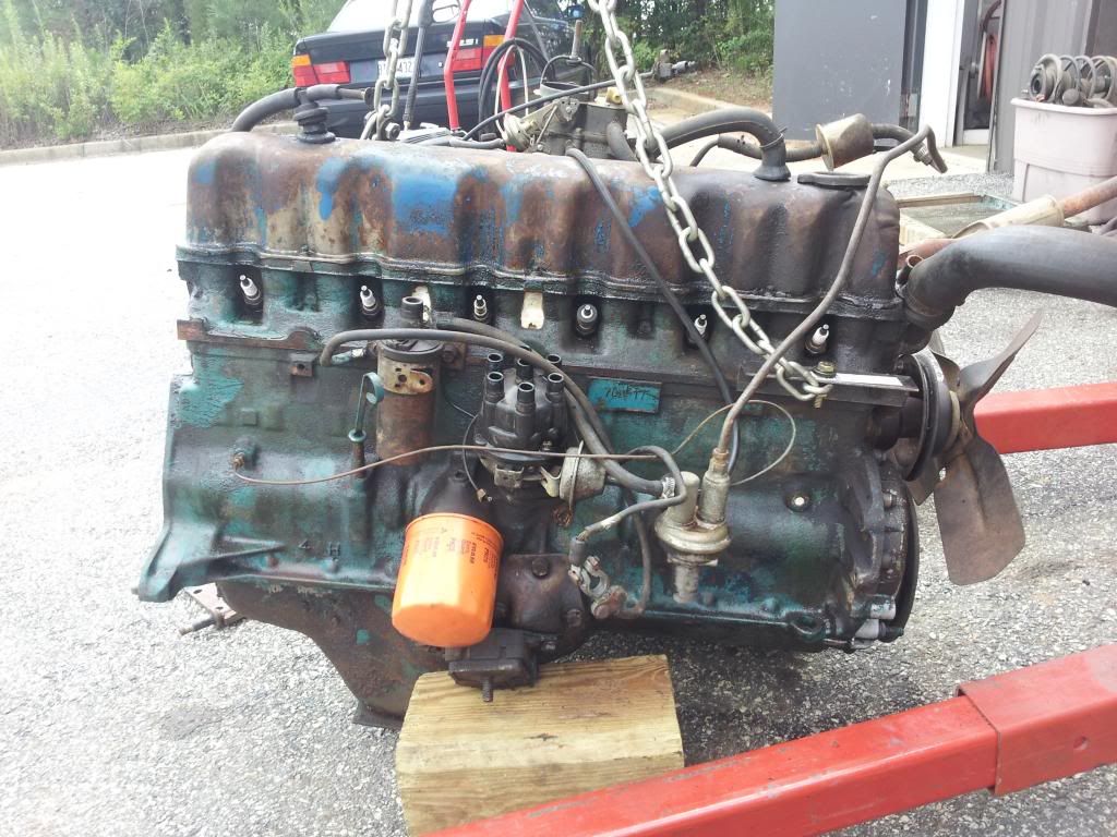

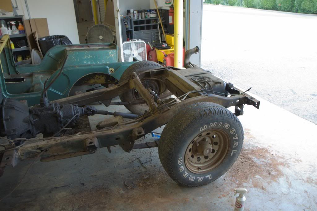

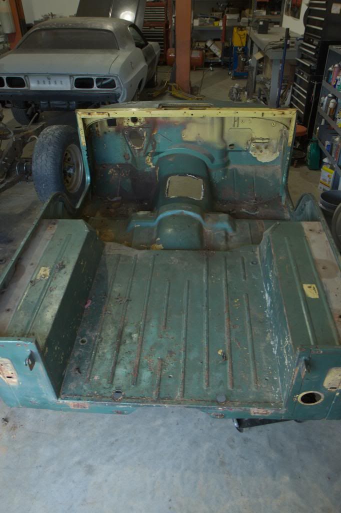

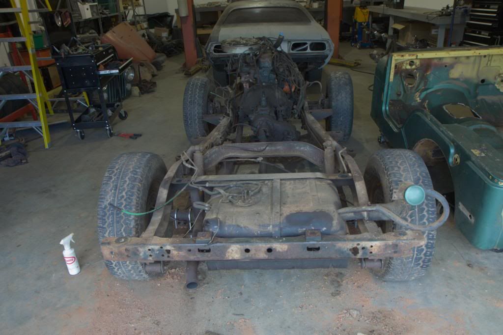

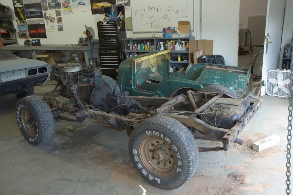

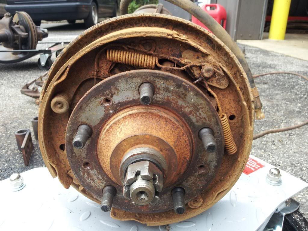

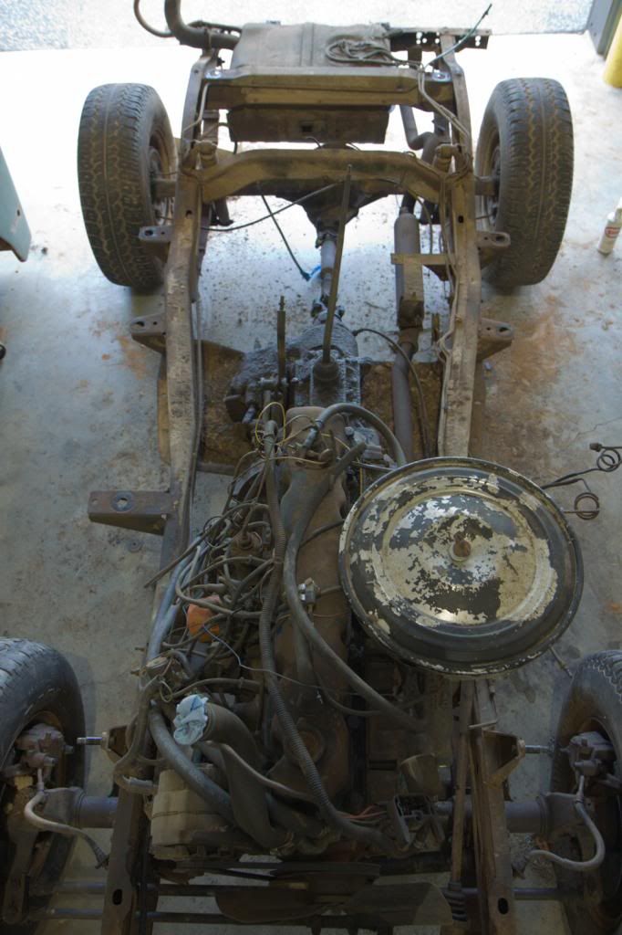

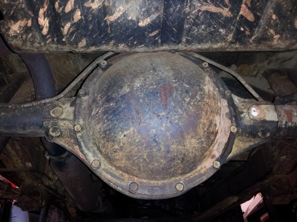

So after I took a lot of things apart, pressure washed the tub, engine, trans and frame, and checked out the brakes... this is what I got. I'm really pleased at the condition of the frame, other than the rear cross member (I'll deal with that later.)
The tub has a lot more Swiss cheese that I was hoping, but That's just time. She'll get patched up.
The engine and trans are about on par for expectations, except, the pivot ball on the bell housing is SHOT, no ball at all (obviously for some time), and the aluminum is worn down horribly. A new bell housing will be on the tab.

post #13 of 255 Old 10-21-2013, 06:59 AM
ScroungerLee
1986 CJ7
Join Date: Sep 2013
Location: Ridgefield
Posts: 523
That's looking good. It looks much more solid than I would have expected after sitting outside for years. Any plans for the engine and drivetrain?

post #14 of 255 Old 10-21-2013, 11:09 AM Thread Starter
cj5russ
cj5russ's Avatar
1976 CJ5
Posts: 325
Going to do a mild build on the drive train, and pretty much leave the engine stock, but give it a gooooooood cleaning. It always ran so well, I'm going to let the engine internals ride.

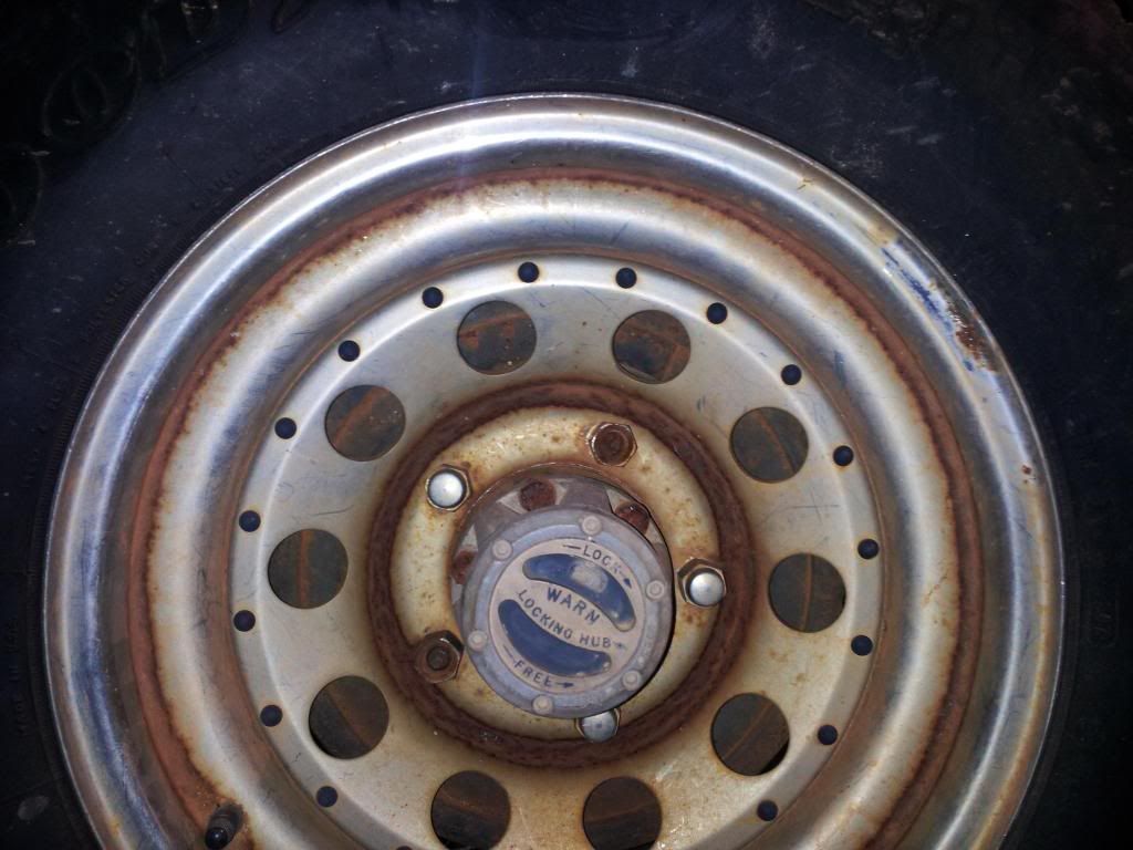

Looking good!
Man, those Cragar Quick Tricks must have been a super popular wheel back in the day...
