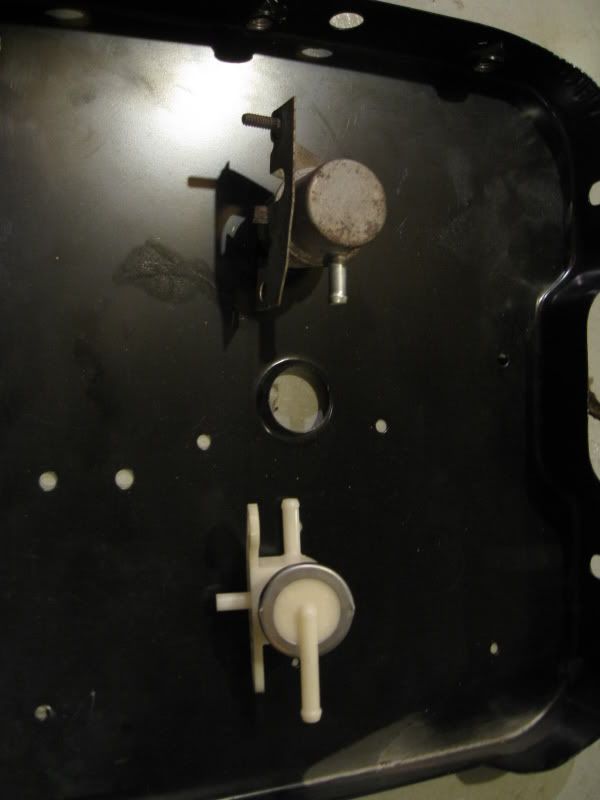

Like I said, great find indeed and I received mine today and they fit and function just like the originals from Jeep. They have the same bolt pattern to to mount on the wheel house support bracket right where the original Rollover Valve was...no drilling another hole to mount it is needed.
I bought 2 @ $5.95 ea. and with shipping the total came to $19.82 to my door. These Rollover Valves are quite rare to find if you find any at all that are OEM compatible. I think Collins Bros. Jeep used to sell them for like $40 or $50 dollars each. Some internet sites sell other type at 4 times the price!
Get them while there hot boys! They are not going to last once the Jeep CJ world finds out about them.
Here's some pics of it along side of the OEM one that is rusted and missing a barbed tube and also of it mounted in the original position.

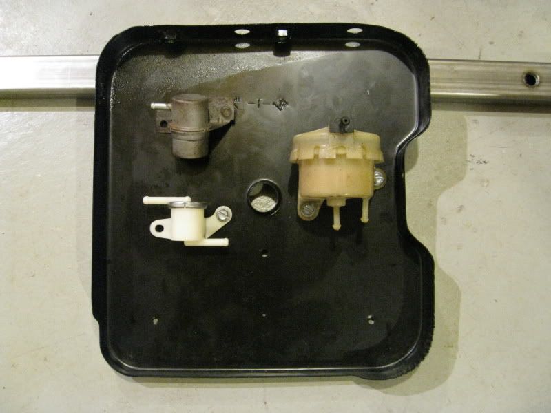

Well if they run out, check out your local Nissan dealer - the black rollover check valve in the lower left of this photo is from a mid-90's Nissan Altima. Only real difference is the way it mounts, which is why the zip tie.
