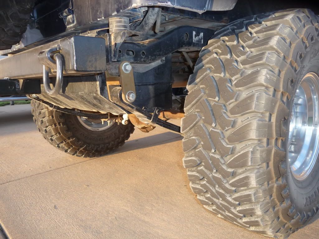

Here are some better pics of the suspension and body lift. I appreciate the advice thus far....
I have contemplated going to 33" tires, however the tires on it are in really good shape and I am starting to lean towards keeping them, however I also realize it may be best to swap them out to best accomplish my goals (lower the overall height by approx 1" and still maintain decent clearance for wheelin.
Take a look and let me know what you all think....And thanks again for the help!!

looks like a 1" LIFT on the body. (1" over stock height mounts)

i'll let others advise on this too- but your ubolts look long and might want to be trimmed to keep from hanging up on obsticles.

edit: disregard the HD bracket comment. it was the shackle i was seeing.

x2 on the 1" Daystar body lift.
