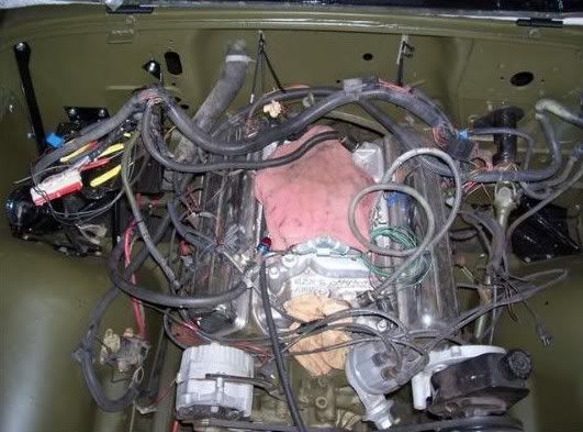

Edit: Rollbar's engine compartment:

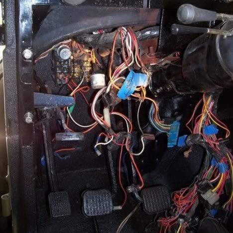

And if that is not convincing, here's more; Rollbar's under dash!: he he!
Same, yes no? He's goina kill me!

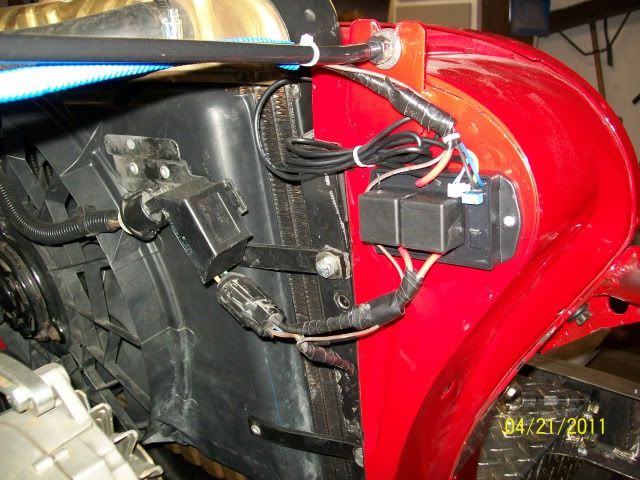

My E-Fan controller came in today so I went to work installing it.Here are some pic's:
This is a Delta Current Control 2SP fan controller for a Taurus fan. It only cost $79 and comes as a sealed unit. $$$ well spent. Yes I can wire in a sw. to completely shut the fan off for fording deep water. For me that water would have to be deeeeeeeep. It automatically changes from low to high speed as needed. It also has a cool down cycle when the motor is shut off.
