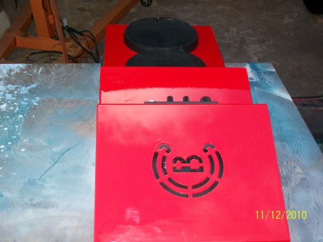

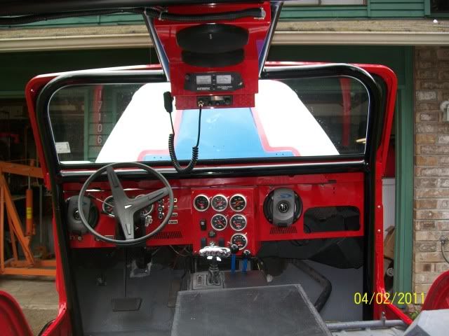

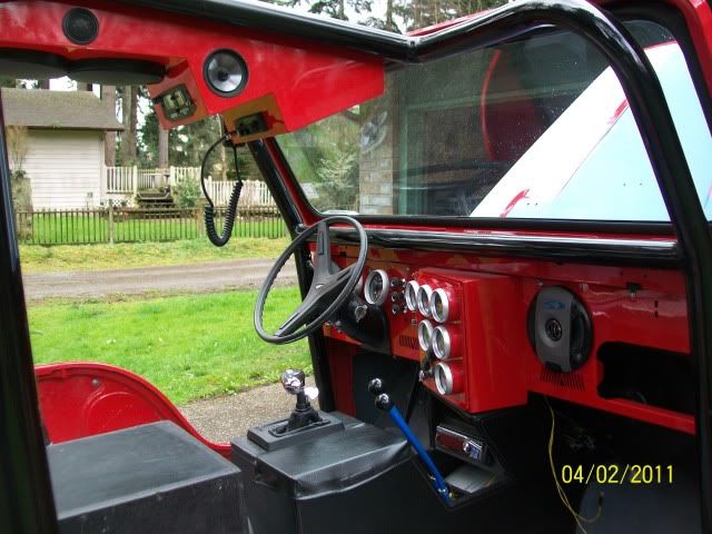

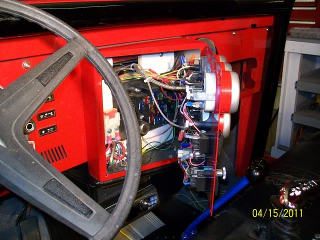

Seeing how you asked, I had Dan at http://sites.google.com/site/doubledfab/jeep-cj-dashs Double D fab make it for me. I also had him make me a custom dash that I designed. He was good to work with but very slow to return e-mails. At times I thought maybe he took long naps. 72 hour naps!
His work was faultless. Good quality and good workmanship. He was good to correspond and we agreed upon everything before the work started. He would draft up a draft and send it for my approval after each change.

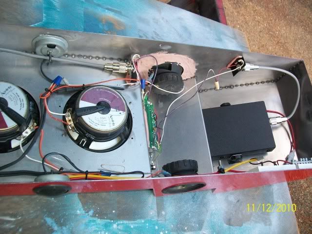

I am using it for my CB and Sterio speakers. I also mounted my SWR meter in it so I can keep track of my CB output signal.
I still have one more mod to make for it. I am going to put some overhead lighting in it. I have it but just have'nt got around to putting it in.
By the way, in the pic below I should tell you because it is not evident that in the consul that my tranny shifter in on is also a cooler. The box below the shifter is a built in cooler. I built the box out of plywood and insulated the inside of it then put three layers of fiberglass in it to waterproof it. I also put a drain out the bottom that drains out through the floor of the jeep to the ground. To access it I pull up the upholstered lid that is held down by Velcro.

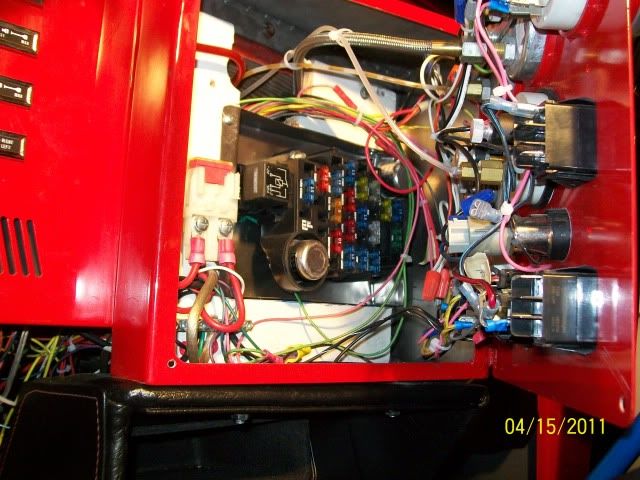

One other thing--on my dash I had my gauge panel extended out and at a angle to make reading the 2 5/8" Auto Meter gauges easier.That panel is on a piano hinge on the edge so it can open to my fuse block which is behind it. I put the fuse block in there so I could access it from the drivers seat and have light to work by if I should need to change a fuse at night. Besides it is weather proof there.

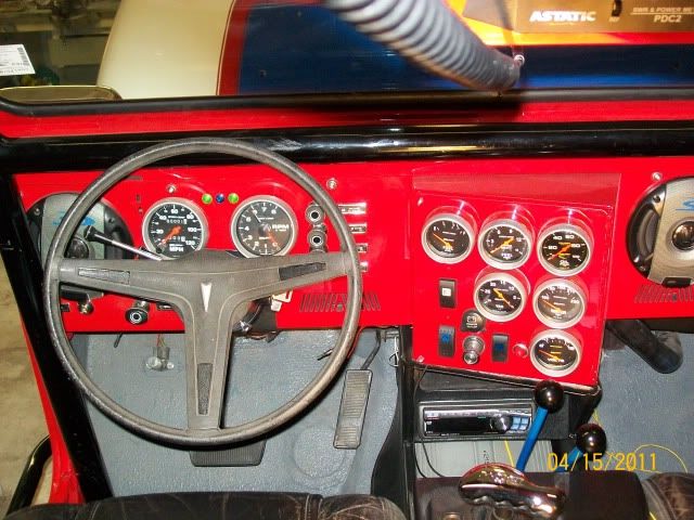

What's that steering wheel from?-a 72 Pontiac? I'm sure it's functional in that you can see the gauges through it. I'm just not sure from an appearance standpoint, that it matches the quality of the other dash components. Unless, its there for nostalgic reasons?
Water ski crazy:
You are right about the steering wheel. And it is coming off as soon as I get my mahogany wood steering wheel. One thing at a time!

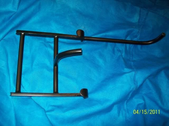

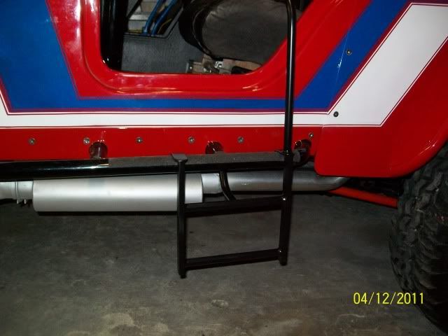

What does one do when their body is no longer a nimble as it once was due to 2 complete hip replacements, and 2 total knee replacements and his jeep is up there in nose bleed territory? I believe that the answer is to build a ladder. And that is just what I have done. Today while I am waiting on other materials to arrive I decided to take matters in hand. A ladder is what I spent my time on today.
It is not permanent. Once in the jeep I can grab the handle and pull it up inside. Then when i arrive I can put it in place to get my body safely to the ground. Here's 2 pic's:
Here are some pic's that give a little more detail

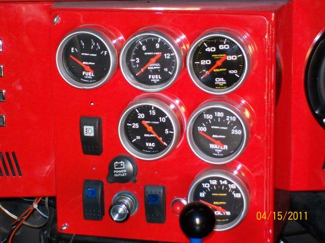

Hey Larry I have gauge envy! How about a close up of your 6 gauge cluster?
Your wish is my command:

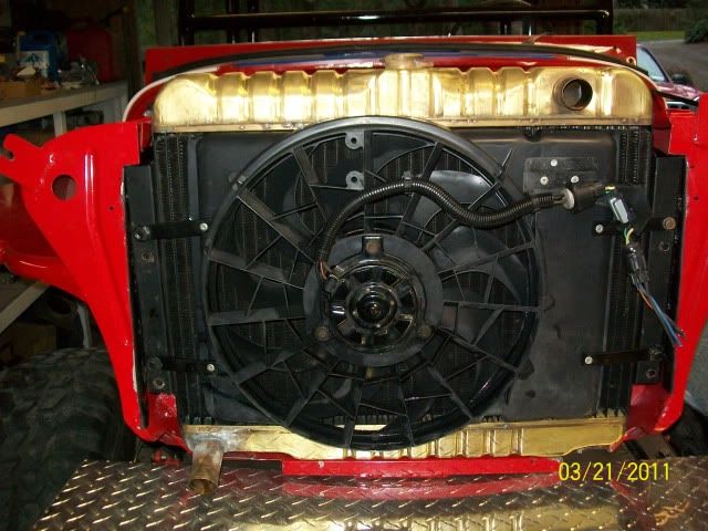

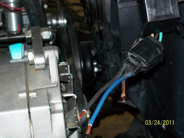

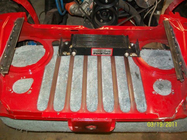

One of my latest projects was the installation of a Taurus 2 speed fan:
I had to make room in the radiator shell. Here I had to start making room for the fan by moving the radiator up and forward. It all started with a little tin smithing.
Here you can see my transmission oil cooler. I also had to weld in new rails to bolt the rad. to.
I have a Delta Current Control 2SP Two speed fan controller on order from Delta Current Control.
When It comes in I will give more info on it.

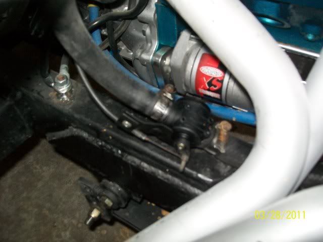

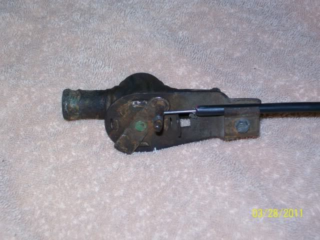

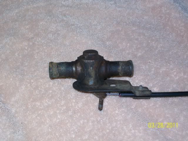

While I was into this area I decided to do one more mod. On the early CJ's the temp control is done by closing off the supply of air that goes through the heater core. I decided to put a Murfey valve in the heater core hot water supply hose so I can shut off the hot water before it can go to the heater core. I used the temp. control cable to operate the valve. The valve I used is off of a early 70's Ford pu. They are still available at the parts store. I bought a new one for mine. I will give you a couple pic's of this valve.
Here is the new one installed. If you look close you can see the control cable attached.
Well !!!! I have been busy, I 'm tired. Will leave it there for now.
