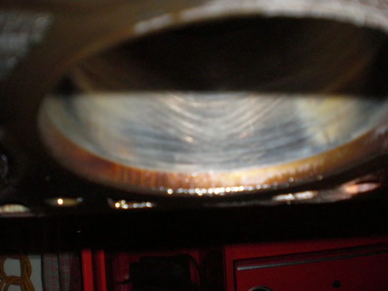

I am in the middle of doing a 4.0 swap into mt 81 cj5. I have the 4.0 on a motor stand and had plans of rebuilding it. I have it all tore down and was looking in the cylinders. I can still see the factory cross hatching on the cylinder walls. all the rod bearing dont have any play in them. should I rebuild it anyway just to be safe? the donor cherokee had 160,000 miles and ran fine. I dont want to do the stroker yet im just getting the 4.0 in and ready to go for the summer. Maybe take my time and build a stroker while I can still run the jeep. any thoughts? advice?

I'd think that if you can still see the crosshatch, the cylinders would have very minimal wear at all. A bottlebrush hone, new rings, and new bearings would be just fine.

the cross hatch is why I said just rings and bearings too. I just said the rest to C.M.A lol
that's pretty good to have cross hatches with 160k miles. makes me wonder if the motor has been redone. is there a .30 or .40 or anything ,stamped in the top of the pistons?

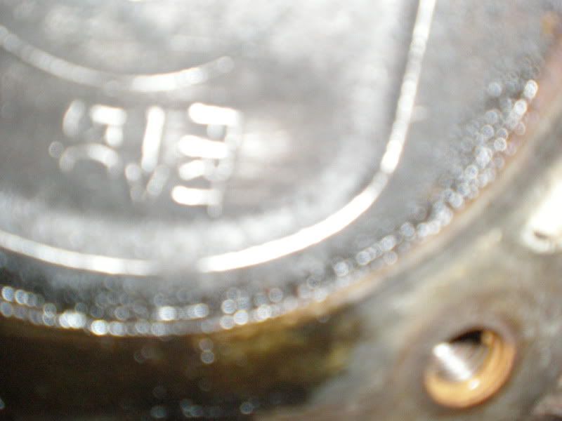

no they just say FRT with an arrow then 50 meaning that side of the piston goes forward but what is the 50? im gonna try and load some pictures so you can see

it could be the block has already been bored out .050" inch. that's kind of an odd oversize but they could do it.
you need to know the size of the bore to be able to get the right size rings. You also need to know if the bearings are oversize. if they are they will be stamped .010 or .020 etc.

Yep, thats a recent rebuild of 50 over. I'd clean it and make sure everything goes back just as it was. Paint it and go. You should be good.

That cross hatching looks pretty deep.. maybe done by hand with one of those power drill dealies.
