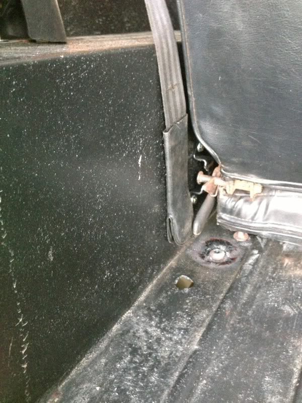

Here is a picture of mine that I just installed last week. I measured 12" from the rear of the tub and up 2" and drilled a 7/16" hole through to the inner wheel well. I also include a link to the write-up I had researched prior to doing the family roll-bar swap.
Link: Changing a CJ rollbar to a YJ Family Style Rollbar
Perfect, thanks!
Did you add any reinforcement? That fender sheet metal is pretty thin. I think the regular seat belt hole have a very big washer/nut spot welded on. I think I will put a piece of angle on the outside that catches under the floor and weld a nut to it.

I didn't use anything to reinforce but that's a good idea. I did use grade 8 hardware including the washers.
