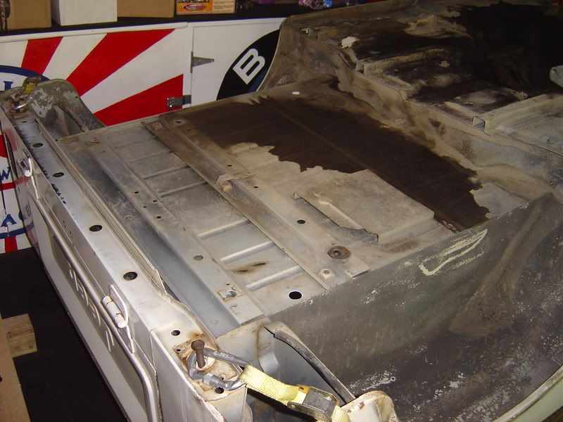

I'm getting ready to put my tub back on the frame. Of course, when I took it off, I had to cut off the bolts on the rear body mounts (the ones that mount on the rear bumper). In previouse discussions, it was suggested that I just weld a new nut onto a piece of sheet metal and insert it into the channel.
My question is this. I need to cut an opening in this channel to remove the old bolt (and treat the rust). Where should I cut the openings? Should I:

If the tub's off, flip it and just peal back the boxing that makes up the rear channel rail
Why not just drill out the broken bolt and retap the existing nut (plate)?
We are talking about the mount location shown where the tie down is connected?
Not sure if the 79 and 84 tubs are the same but if you can't tap the existing, I'd work the repair from the inside.

Yea, that's the setup. I had to cut them off because the captive nut inside broke loose (cage rusted away).
So when looking at your photo, I would cut from the right, from the inside portion of the tub?

I'd pop open the welds with a cut-off or sawzall and peel it back like this:
