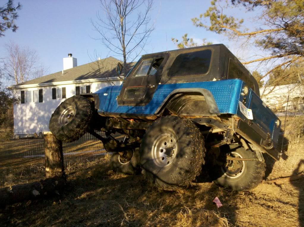

thanks, I am looking for some guidance for my new build, heres what I have
I have a pair of dodge dana 60's some CJ's XJ (read that they are weak), YJ, and wagneer springs and a yj frame
I am looking to build something similar to this
[IMG][/IMG]
thanks

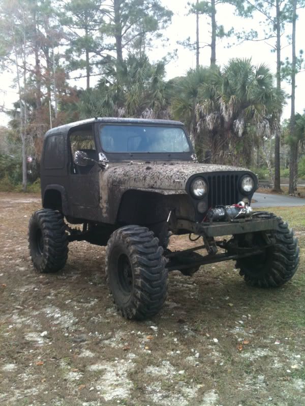

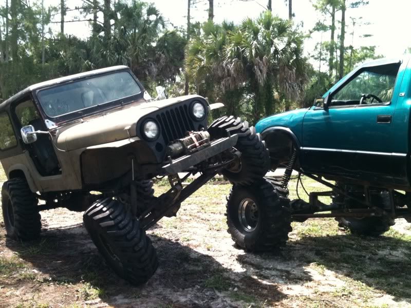

dhubing
Location: Naples, FL
Posts: 185
Originally Posted by IronMaiden View Post
Others will disagree but IMO: Hardcore and leaf springs don't belong in the same sentence.
A linked suspension with coils, coilovers or air shocks are hardcore and offer way more flex and articulation.
If I were doing 1 tons again, that is the only way to go.
Sub 100" wheelbase on 37" tires.
On a 39.5" bogger.
On a 46" bajaclaw
dhubing is offline

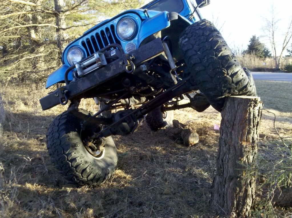

dhubing, i like your jeep, are those stock jeep springs?
petey156 is offline
post #14 of 15 Old 11-17-2011, 07:09 PM
dhubing
Posts: 185
Thanks. They are 3.5" BDS springs (SOA). It's taller than the usual CJ on 37s, but down here in Fla it has to be...

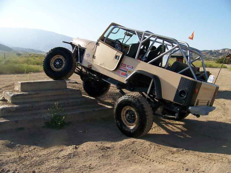

Not really hardcore per se:
But here are some pics:
It had 73-87 Chevy 1/2 ton superlift 4" lift springs. Tons with 39.5 Iroks.
The springs were some what stiff and the flex left something to be desired, likely due to the shackles but it worked alright for what it was.
