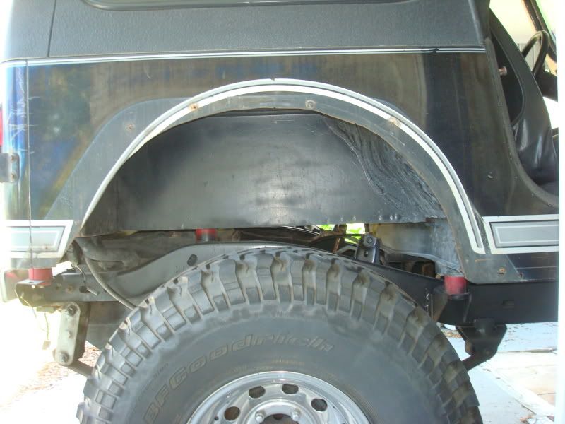

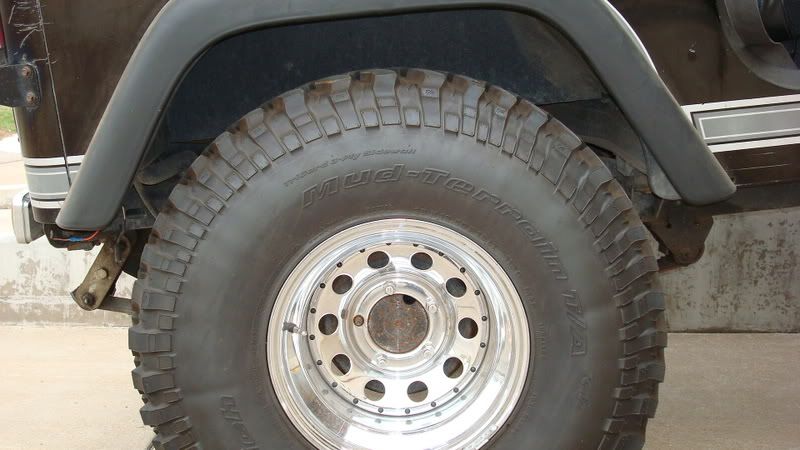

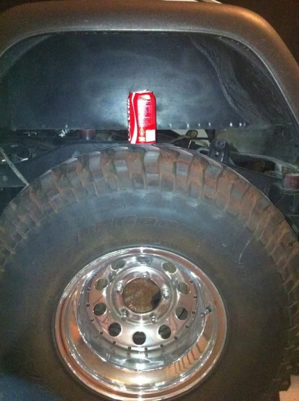

With 35's u will end up hitting in the rear. Here is mine with a 1" bl and tj flairs with old 35's
U can see where I cut for the flairs
Give u an idea on the Hightower. Red one is stock with 31's

Here is one flexing to show y I did the tj flares

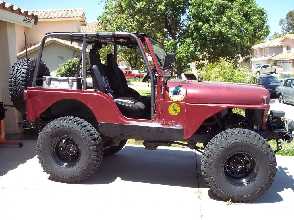

35's on 4" lift springs
I only had to trim due to contact at severe articulation.
[IMG][/IMG]

Nice cage

I have the RE 4.5" lift with 1" BL. Your problem with 35s will be the back of the tub, not height. I cut mine like John did and installed Rugged Ridge flares.

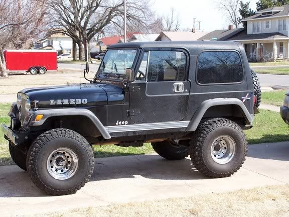

Here is my cj7 with a 4.5 RE lift and 33's
Here it is again on 35's and 4.5 RE lift
35's rubbed so I put on TJ flares and 4.5 RE lift
Hope this helps you.

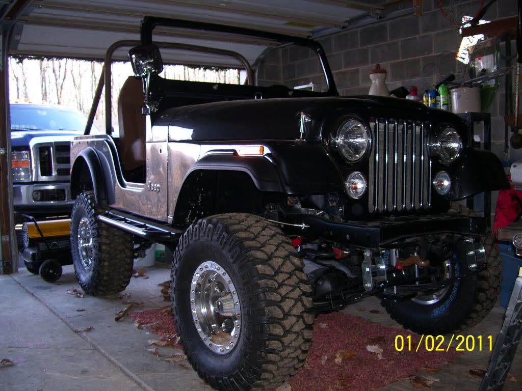

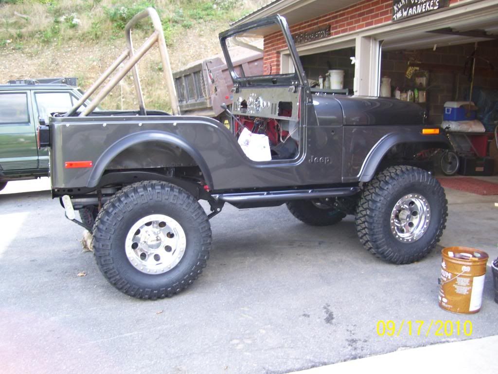

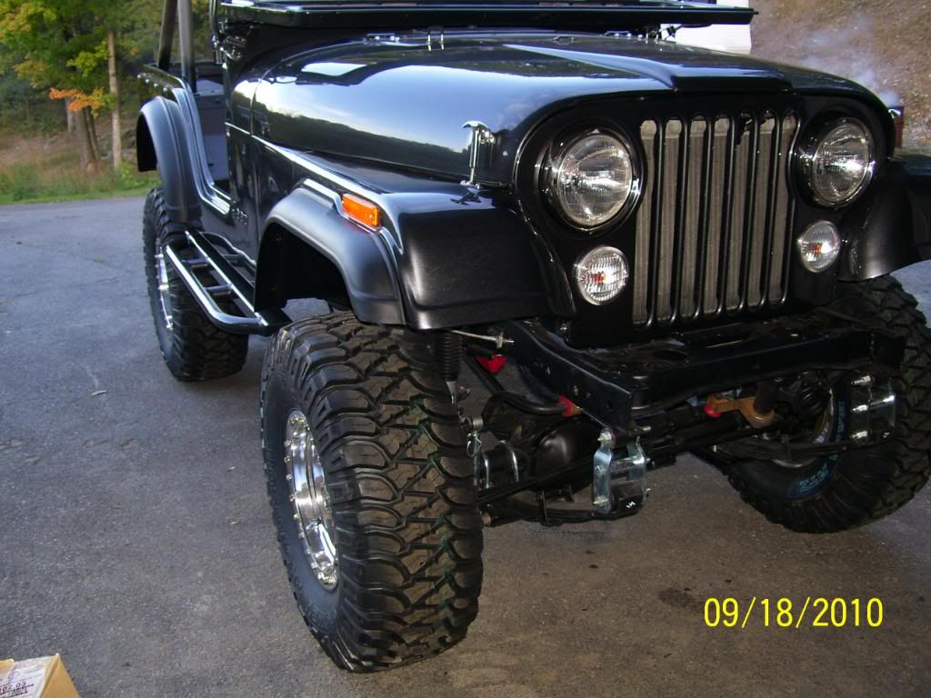

Here is my CJ5 with a 4.5 RE and 33" x 10.5

Aero that rig is really super clean. It seems like everyone is doing the one inch body lift and 35's..except kponytail. How's the 33's feel on your 5 kponytail?
