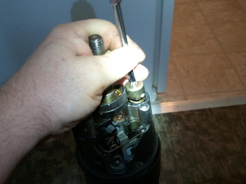

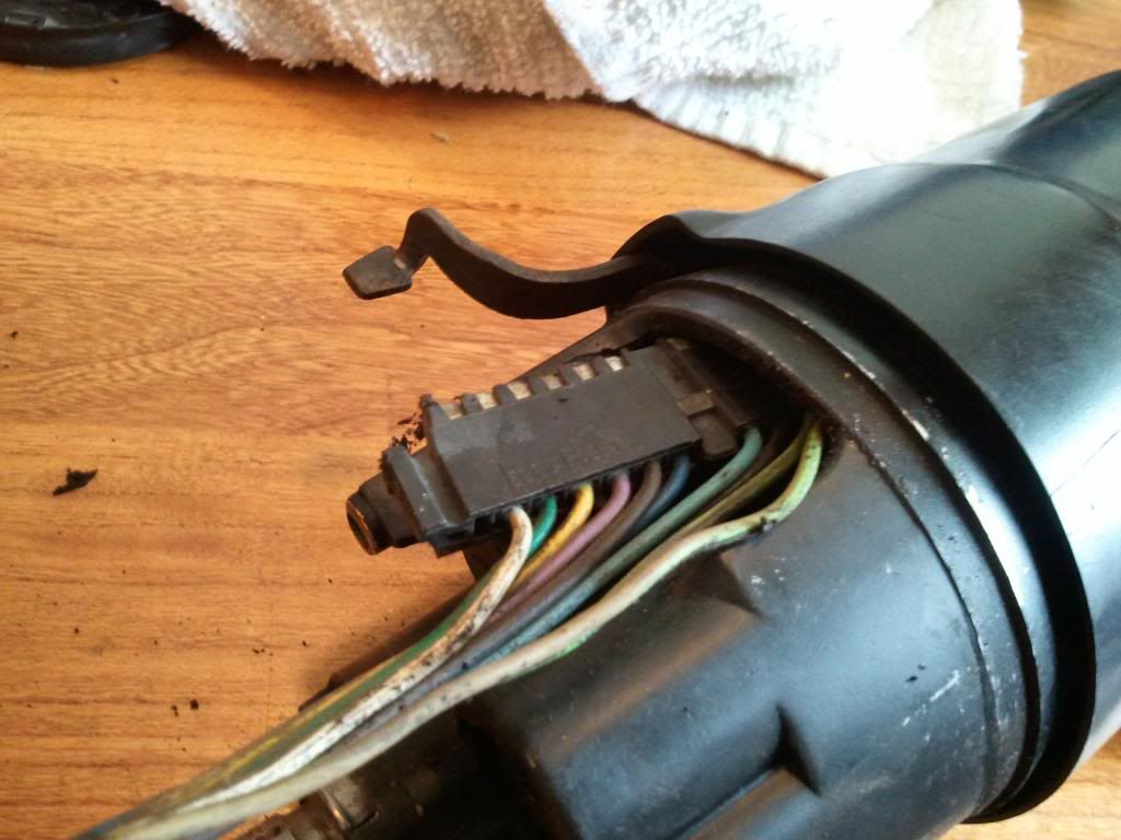

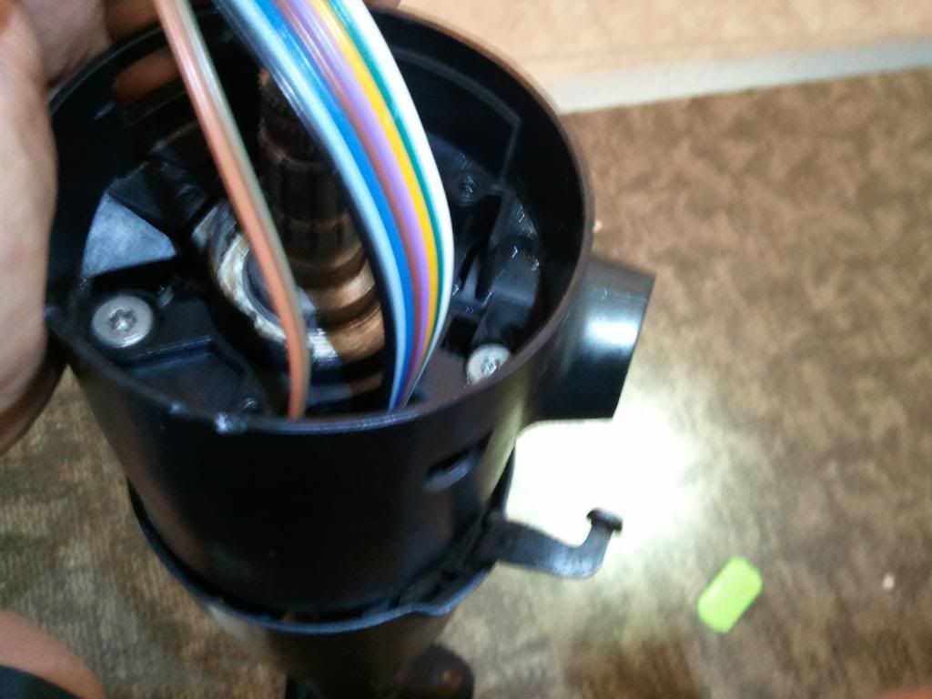

Steering Column rebuild a 1 hour job in 5 hours
My jeep had a tilt column in it when I got it so I decided I wanted to keep the tilt column especially after installing new seats that sit a bit higher than my old seats and also I had a choice, lose weight or tilt wheel. I haven't lost a pound. So I scoured the country for a used tilt wheel. I found one out of a 1984 CJ in a junkyard 5,000 miles away in New Jersey on car-parts.com for 100 bucks. Shipping to Alaska doubled the cost. Uggghhhhh. Anyway, the column in my jeep squeaks and wobbles, and with a 10,000+ mile road trip coming up this summer I couldn't bear listening to it squeak and squeak, and squeak,,,,,. So a week later the column arrived and decided to swap the bearings since it wasn't in any better shape than my current one. I wanted to swap the very top little bearings but couldn't remove the races but since all the bearings were there I decided to simply use some white lithium grease and replace only the lower bearing which was a piece of cake.
Taking this steering column apart is like trying to figure out one of those chinese locking puzzles, the engineers who designed these things have one hell of a imagination.

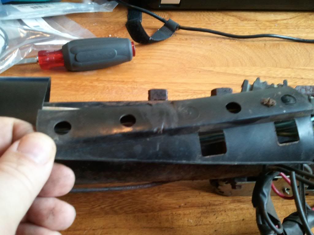

Since I was going to replace the turn signal switch too I had to remove the wiring. The bracket is held on by 4 1/2 inch bolts.
This bracket only goes on one way, if you get it turned around during reassembly the holes don't quite line up.
Next this plastic wire loom guide just slides off.
There are three black phillips screws that hold the turn signal switch in place. Remove those screws and then remove the turn signal arm screw and slide out the arm. The turn signal arm screw has a different thread pitch than the the three screws holding the switch. Gently pull the turn signal wires up through the column, If I were absolutely positive that my replacement switch was perfect I would simply cut the wires and throw it away.
Once the turn signal switch is out of the way you'll have to remove the key lock which is simple, turn the switch to run take a thin screw driver and press on a thin black tab on the lock. If you have a new one you'll see the little tab you have press in and then wiggle the lock out, I didn't think to take a picture of that. After the lock is out you'll remove three star head bolts that were located under the turn signal switch. Once these are removed unscrew the hazard switch and slide the housing off the column.
To remove this stuff.
You have to remove the ignition switch. Removing the switch frees up the switch rod.
I also removed the tilt spring. There is a cap with a small square hole in the top. I pressed down firmly with a phillips screw driver and turned counter clockwise and the cap popped out.
The upper bearing kit I puchased came with a two new upper bearings, that I couldn't use since I couldn't get to them, and it also came with a new spring, bearing race and ignition key stuff. I intended on taking the column completely apart but gave up after it became apparent that I couldn't remove the tilt rods, there is one on each side, they have fine threads in them and if somebody has a puller with fine threads then they can probably get them out, since the housing is plastic I decided not to chance it. So I decided to "pack" the bearings with a good bit of lithium grease. With the housing off it was pretty easy to get access to the bottom bearings to lube. The strangest I found in this was during reassembly I could not figure out how the inner race and bearing spring preload piece went together.

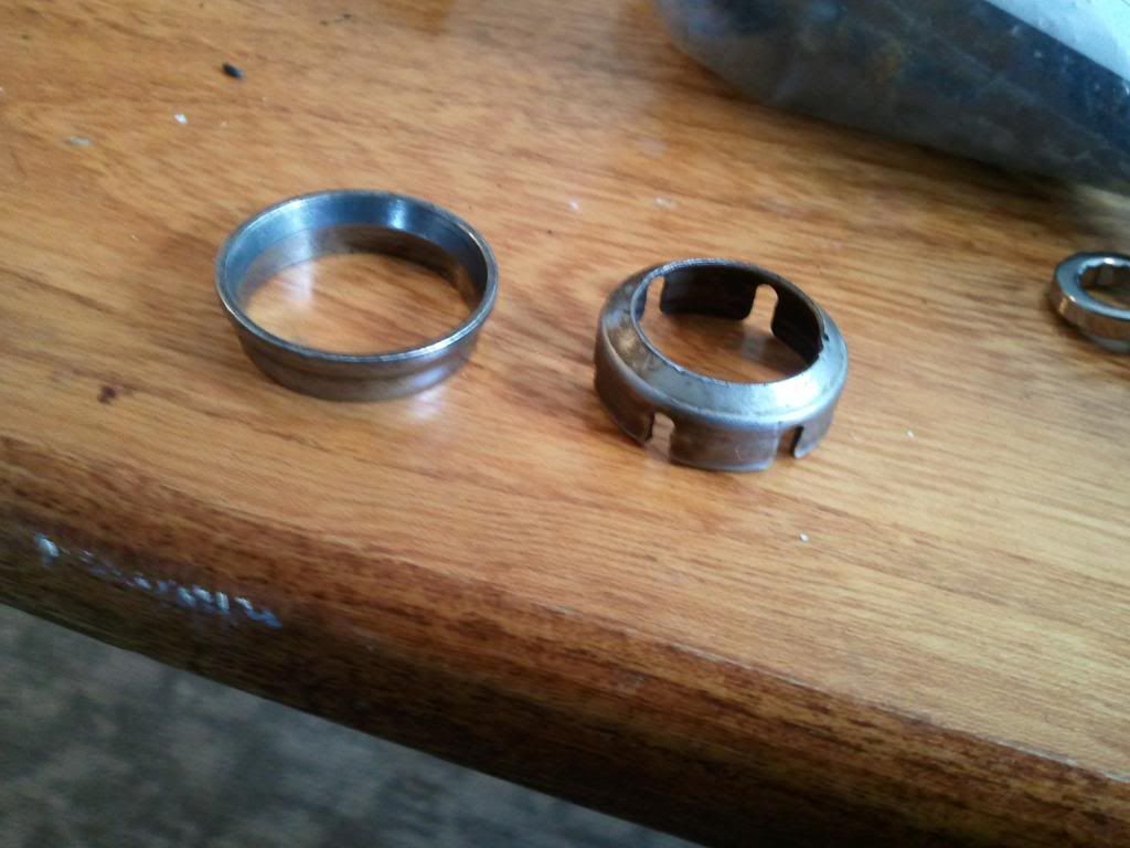

These two pieces had me stumped. I knew the thinner one was the inside race for the bearing but the castle looking one was a stumper. Finally I figured it out. The castle looking one barely fits inside the inner race, however in this picture I clamped down a little too far, no fear it'll come out.
This is how it looked when I finally got it put together.
Reassembly wasn't that bad actually. I confident I could do again in a couple of hours. I didn't show any pics of replacing the lower bearing that is on the end of the column but it didn't take 15 mins to figure it out. I also didn't show how to remove the steering wheel either. After putting it all back together there is no play or wobble or noise. It's tight as a drum and turns smoothly. Maybe after I take out my old column I do a complete disassembly and rebuild of it with more pics. Well now that that took up my whole day it's time to eat supper.

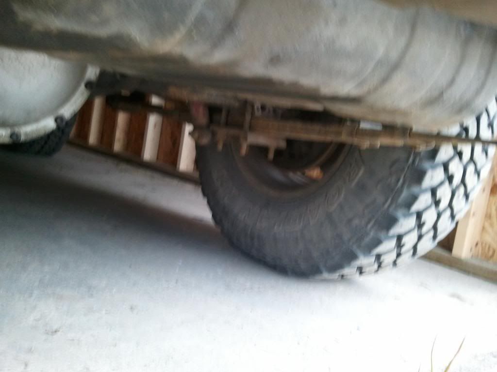

Leaf springs, stereo/electronics, and other stuff installed
It's the middle of April and I have about one more month before I can start my trek around the great north! My plan is to leave Homer around the 24th of May make my way up to the Anchorage area and camp for a couple of days and do some gold panning. Never have panned for gold, but the box says I can "pan an ounce of gold a day." If that's true ya'll won't hear from my fat a$$ ever again! lol. Anyway, then it's off to Nancy Lake, north of Anchorage, then to Deadhorse Ak way above the arctic circle! Then it's back down to Whitehorse Yukon, and eventually to Yellowstone park. In July I should be back in Phoenix and maybe if time permits fit in a trip to the east coast to visit family before heading back to Alaska, I'm estimating about 12,000 mile plus trip this summer. This past weekend I finally got a good bit of work done on the Jeep. First and foremost was installing new leaf springs and shocks. I went with the Rugged Ridge 2.5" springs and Skyjacker Hydro 7000 shocks.

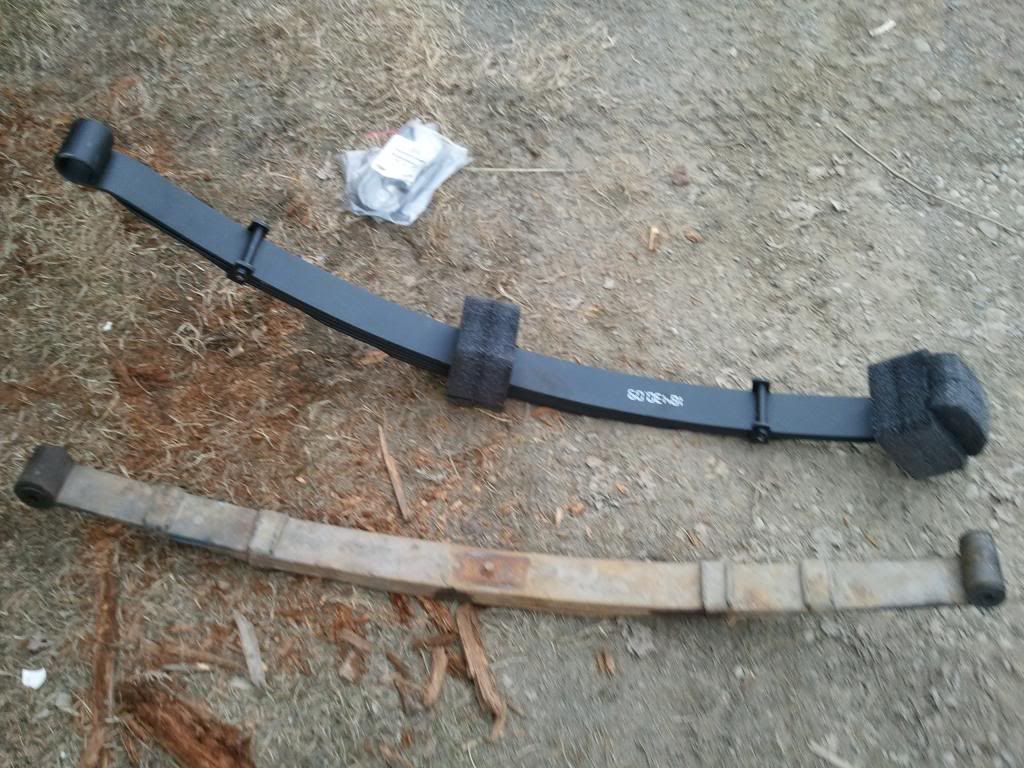

These are a couple of pics of my jeep before the leaf springs. You can see how flat they are, hardly, if any curve to them at all. The jeep rode like a wagon, pot holes and bumps were beginning to wear me down.

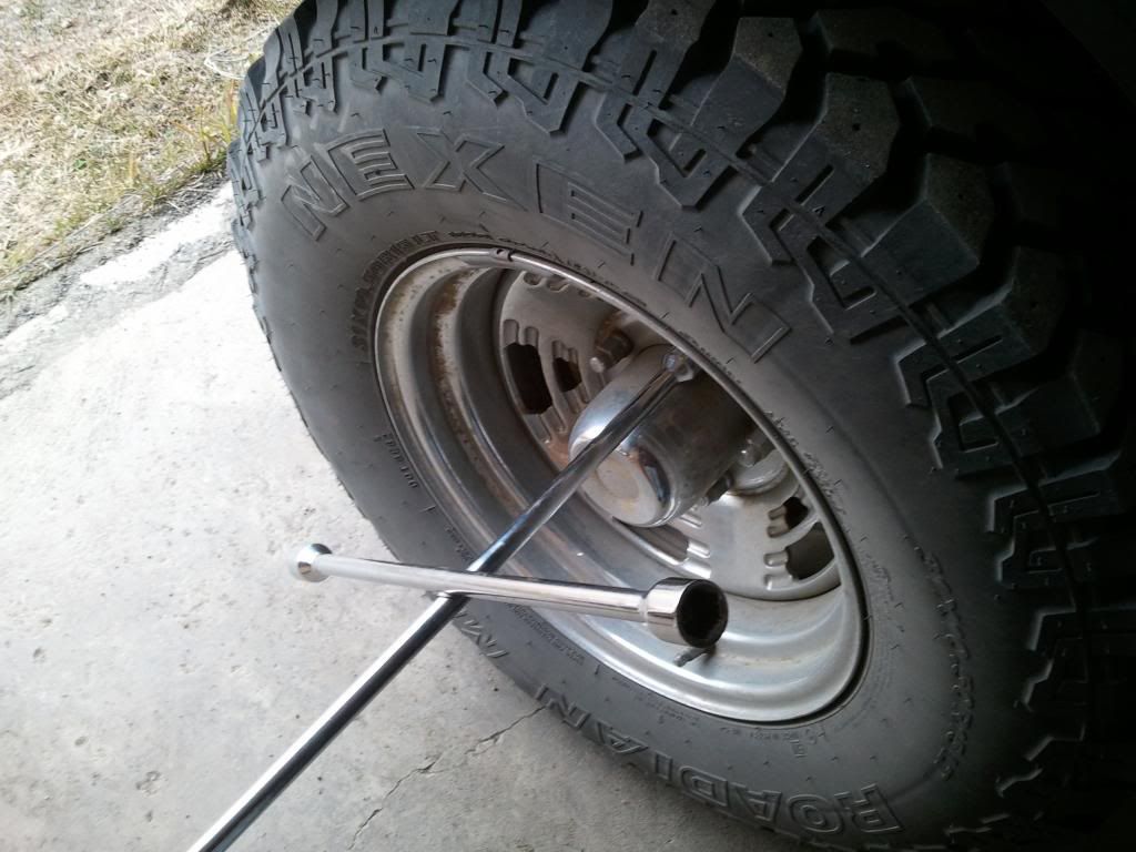

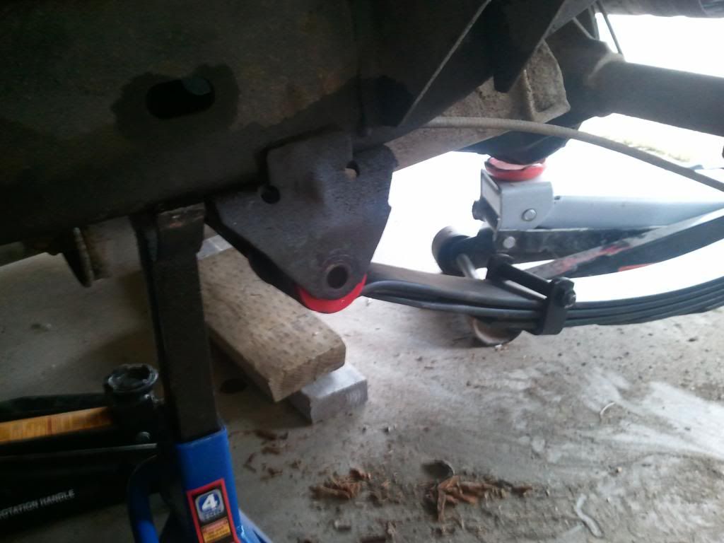

First thing I did was loosen the the lugnuts and remove the rear wheel. After jacking up the jeep and putting one side on a stand I pulled off the shocks.
I opted to work on one wheel at a time. Most people probably jack the rear up put jack stands on both sides and work on both at once. I didn't for two reasons, one was because the storage room I worked in didn't allow me to wiggle around both sides of the jeep, plus I hate crawling under stuff even on stands.

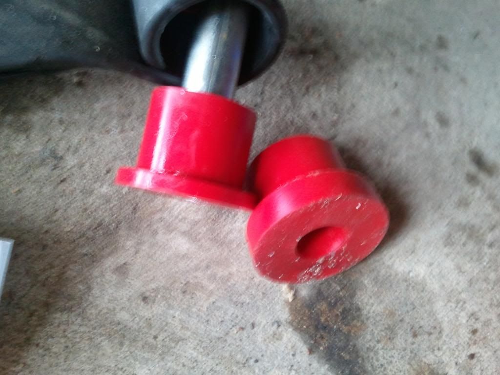

I never really worked on suspensions, other than replacing shocks but this is really not hard mentally, however it turned out to be an all day job. The first shackle bolt I tried to remove was blocked by my muffler and that took a half hour to figure out how to jack the muffler up enough to slide the bolt past. Secondly, the little 2 ton jack I had would barely reach the frame and so I had to put the jeep back together drive to a rental company and rent a 4 ton jack, a big "pro" model. Here is a helpful tip, make sure you have two jacks, and make sure one of them has the ability to reach up to the frame to lift the jeep a few more inches. That headache alone set me back an hour and a half.
These springs did not come with directions, I bought them off Quadratec and in lieu of directions I got a very nice windshield sticker and a handy glove box organizer. When I unbolted the left rear spring I simply drug it from the rear and kept it in the same position that it was installed in. There is a bigger eye on one end of the spring. I laid the new spring next to it, big eye to big eye.
The springs come with all the bushings needed. However there is a width difference in the bigger bushings, the thinner bushings go on the rear springs. The thicker bushings go on the front springs. The springs btw are numbered 18340.09 (rear) 18340.08 (front). I wish they had wrote the words rear and front on the springs but oh well, it's not hard to figure out.

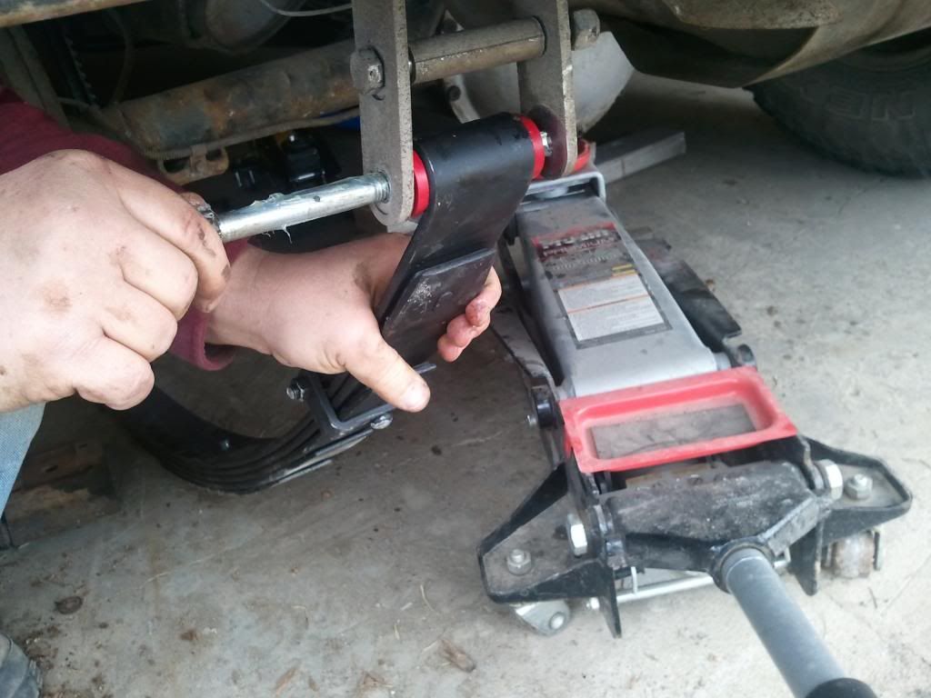

On the rear shackle I loosened not only the bolt holding the leaf spring on but the two bolts above it.
I used a rubber mallet to line the holes up and then inserted the bolts, still keeping everything loose.
After hanging the springs I put the new U-bolts over the axles and put the shock mount up to the bottom of the springs and started the nuts. I used the small useless jack to raise the leaf springs up while simultaneously lowering the axles so that the knob sticking out the top the spring would guide it's way into the hole on the bottom of the axle.
when the axle and shock mount came together I simply tightened the ubolt nuts. I don't have a torque wrench so I tightened the hell outta them, I'll check 'em in a few weeks to make sure they're still tight.
