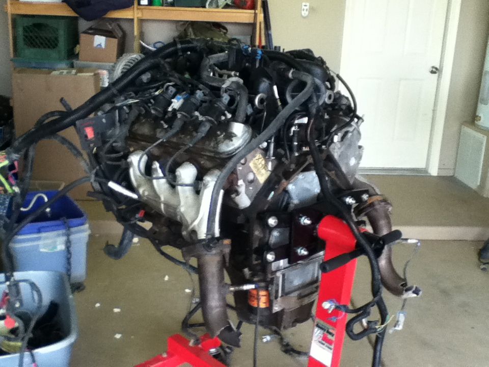

I got my engine a couple of weeks ago. It's a 2002 Flex Fuel 5.3. I didn't realize it when I bought it that I had a flex fuel engine. I found it on car-parts.com and got the complete engine everything under the hood for 650.00 bucks. That's alternator, starter, fuse box, wiring harness, ac compressor was locked up. power steering pump, and pcm. 88,000 miles was in a roll over.
I got it home in the truck and borrowed a engine hoist. I bought an engine stand from harbor freight for 50 bucks, the engine weighs about 500 lbs. It looks massive though.

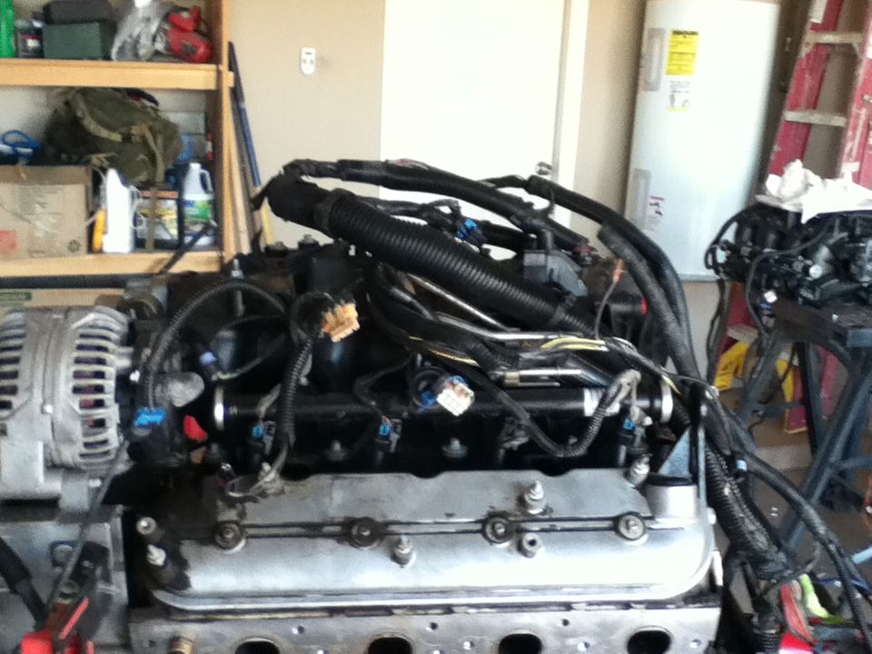

This is with the harness laying to the back of the engine.
I even got the front O2 sensors but the truck manifold are too wide for the jeep frame. I've measured it twice, it's just a hair of 25 inches wide. The manifolds would dump right on top of the frame rails.
First thing after putting engine on engine stand was take pics, and start removing. The coolest thing on the front is that the alternator and power steering pump all sit on one single bracket, held on by a half dozen bolts.
