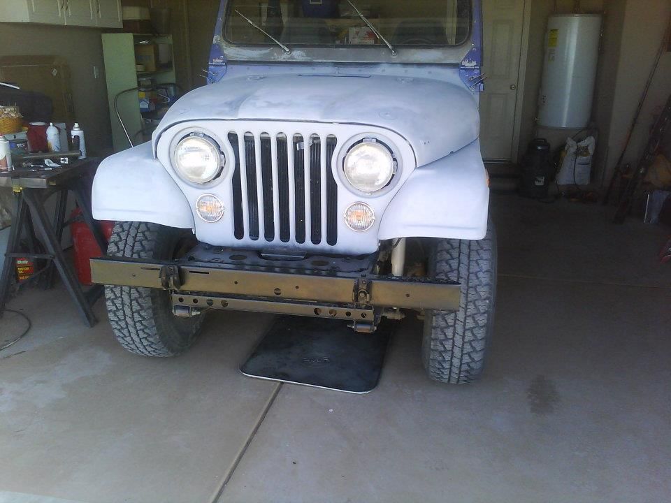

Another good parts day.

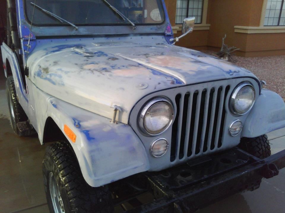

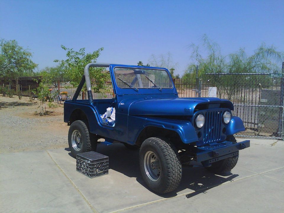

Today is going to be another good parts day. I will be getting fuel lines, flywheel inspection cover, and something else I don't remember what. Saturday I traded my soft top for a fiberglass hardtop I found on Craigs. I'll take a pic of later and post. Now I need to find doors. Way quieter even without doors than the softtop was. Anyway here are some pics I found of when I first started working on the body of my jeep.
I'm not a body man at all, I did some electrical work on a buddys jeep and he painted my jeep in trade. One thing that has me stumped is the amount of bondo on the jeep. It seems the entire body is covered in bondo. It does not have a bit of rust as it's spent its life in Az. Does anyone know what the whole thing has a layer of bondo on it?

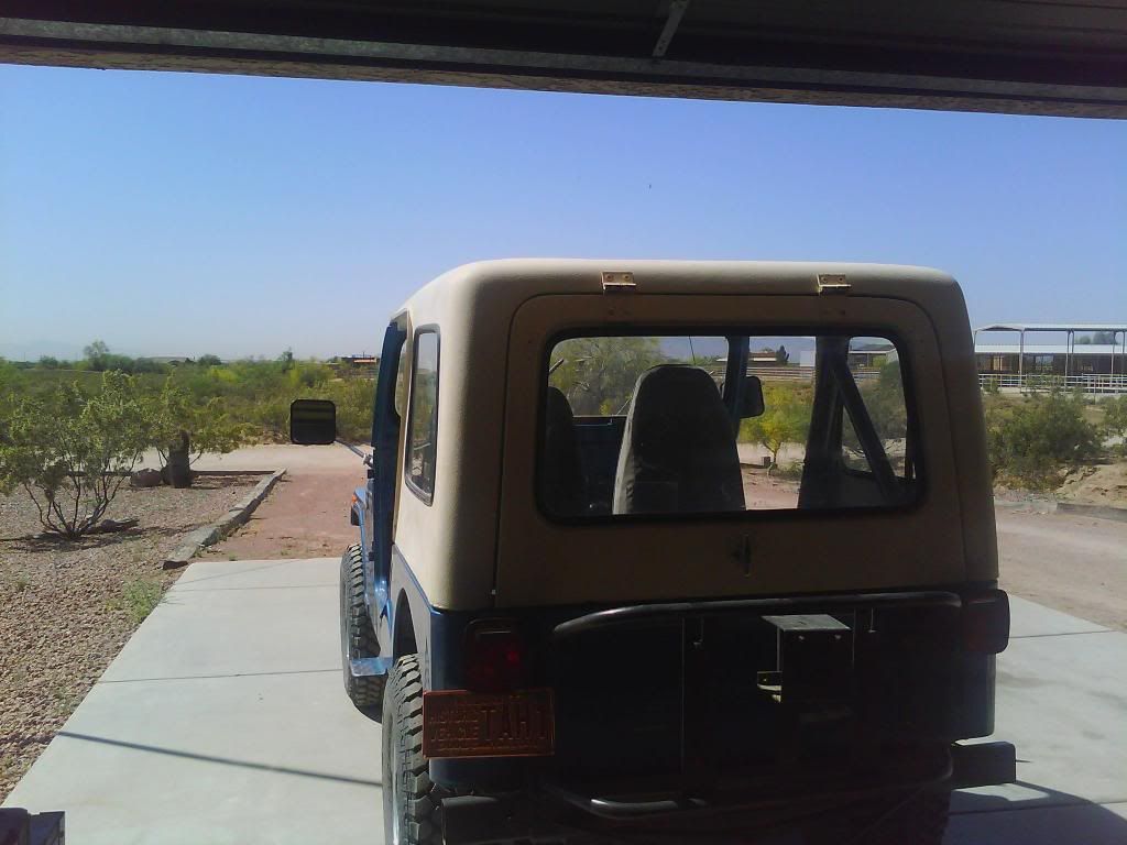

I found an ad on Craigslist in Phoenix last week, hardtop for trade for softop. So I responded and went to look at the hardtop, as it turns out the guy with the hardtop is the same guy I bought softtop off of last year. So I went ahead and made the trade. Now I have my 4.10 axles on Craigs for trade for something taller. I think it would be easier to just unbolt the axles and swap them, rather than rebuild the insides. My axles are good, no leaks, they've never been abused. I change the oil in them every spring and the oil that comes out is as golden as when I poured it in. If anybody want to trade axles let me know, I'd come to you if you're within a couple hundred miles. Here are some pics of the hard top.

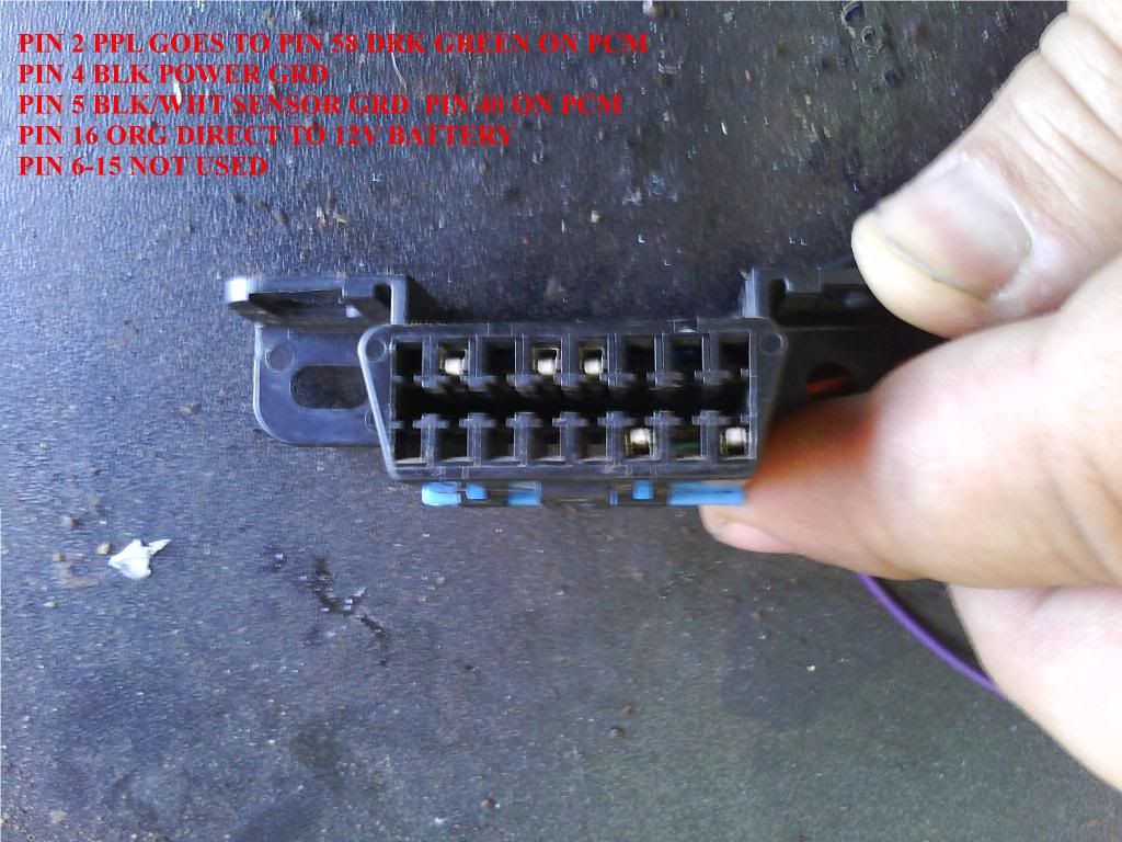

I started working on my engine harness about two months before I actually bought the engine. About the only things electrically I need to finish are the OBD and Check engine light, so today I decided to reacquaint myself with the soldering iron and wires.
LT1Swap has a list of stuff you can buy from Mouser and All Electronics, I bought enough parts to build a dozen OBD II ports, then I actually got the OBD II port out of the donor vehicle.
This is the Green wire from Pin 50 on the Blue PCM connector.
This is the receiving end of the OBD II port, you can see there are 16 possible connectors, we'll only use 4. Starting at the top left is port 1 -unused. Port 2 has a purple wire, it connects to the green wire coming from pin 50 on the PCM. Port 4 and 5 are grounds. Port 4 is Power Ground, Port 5 is Sensor Grd. From what I can find out Port 5 can connect to ground ckt 451, you'll see a few 451 ckts on your pinout sheets. I connected port 5 of the obd ii to wire 40 on the pcm. port 4 I will simply ground to chassis. If I'm wrong I'll reverse the ports. No harm no foul. You'll notice number 14 has a wire, it had a green wire, I cut it out. Port 16 is orange and that goes to constant 12v.
I cut out the green wire it wasn't needed.
This is the ground wire at Pin 40 that I soldered Port 5 to.
Serial Port wire which is green on port 50 of the PCM solders to the purple wire coming out of port 2 of the OBD connector.
I spliced the constant 12v orange wire off the OBD II connector to my orange constant wires going to my fuse box.
I bought this little amber light for my check engine light. The check engine light needs two wires, the brown ground wire from the PCM and a 12v switched source.
Since Pink wires are switched 12v wires, I dug up a extra Pink wire and soldered it to a connector and slid it onto the terminal of the light.
You can see in the picture that lamp is labeled + and -. So I attached the pink wire to the + side and the PCM negative to the - side. I put the lamp away after connecting these two wires. I'll drill a hole in the dash later run these wires through the firewall and connect them to their appropriate wires. I'll splice the pink wire to 12v switched wire, and brn ground wire will attach to the pcm ground. All in all pretty simple. I'm putting my OBD II under the hood next to my fuse block and my check engine light will be in the cab. I hope this was helpful to somebody.

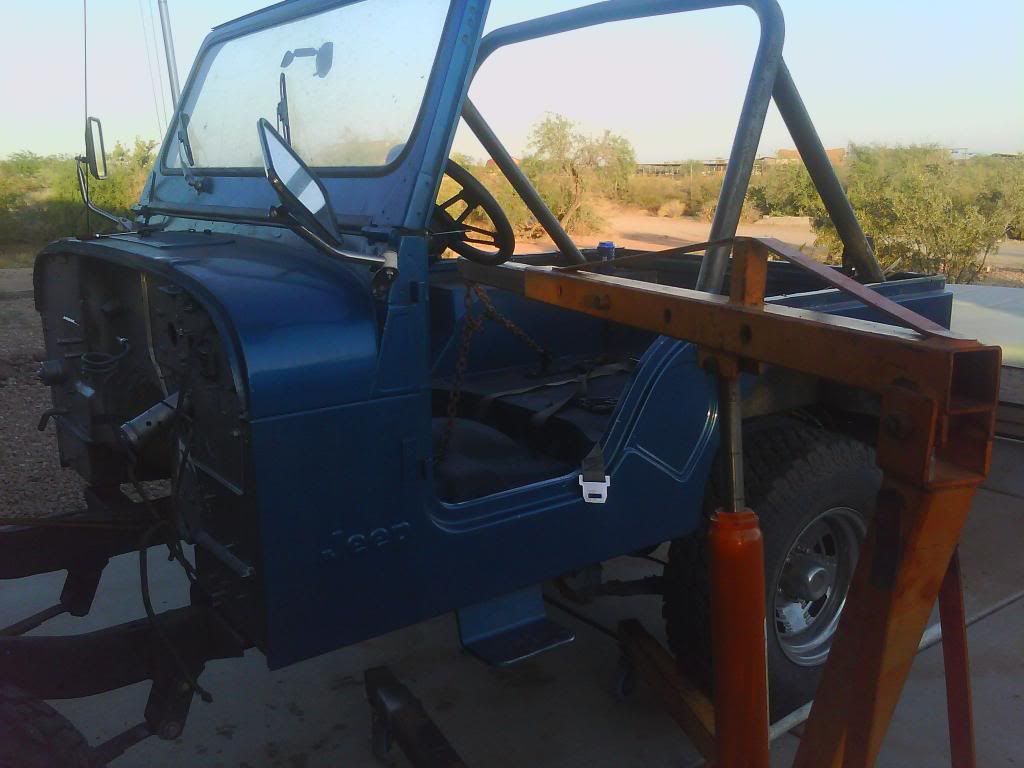

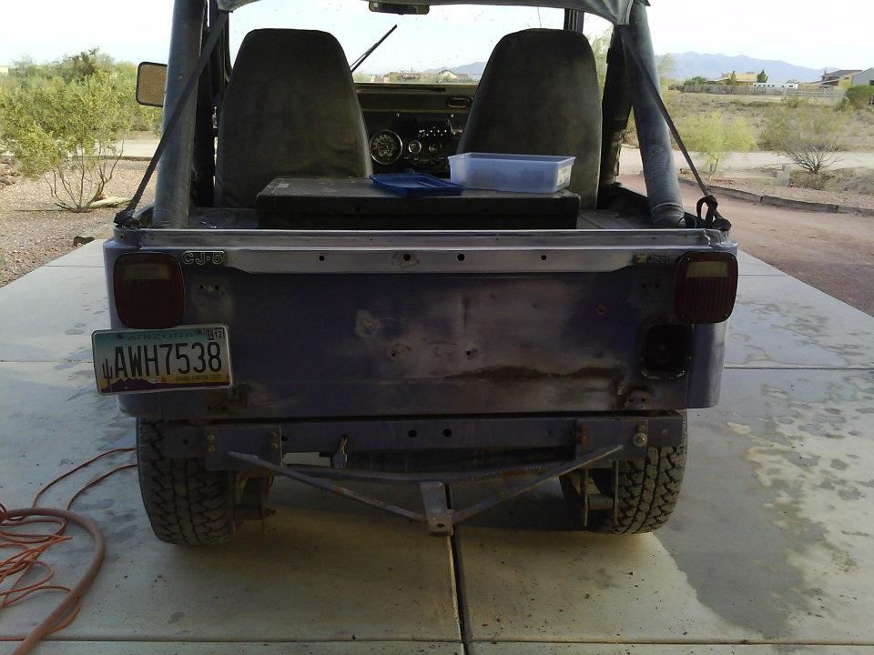

Today is the day to start disassembly.

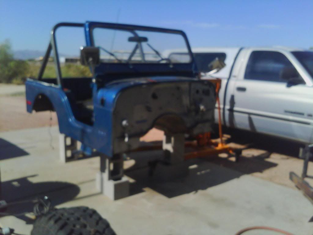

There are only so many times I can take things apart and recheck torque values, or change bolts to a better bolt. So the motor is as ready as it's ever gonna get. Today I started dissassembly of the jeep. Wouldn't you know it though as soon as I took the hood off and removed the battery, my phone rang and I had to run an emergency errand. Battery back in, but hood still in garage I took off on errand. So here are some disassembly pics.

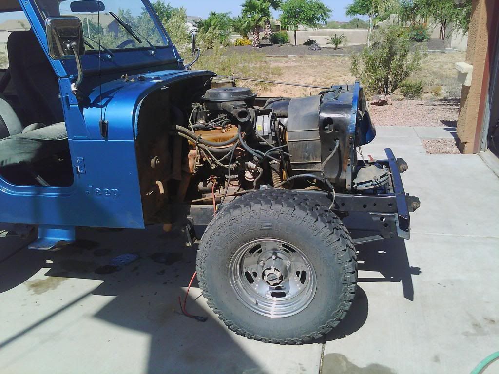

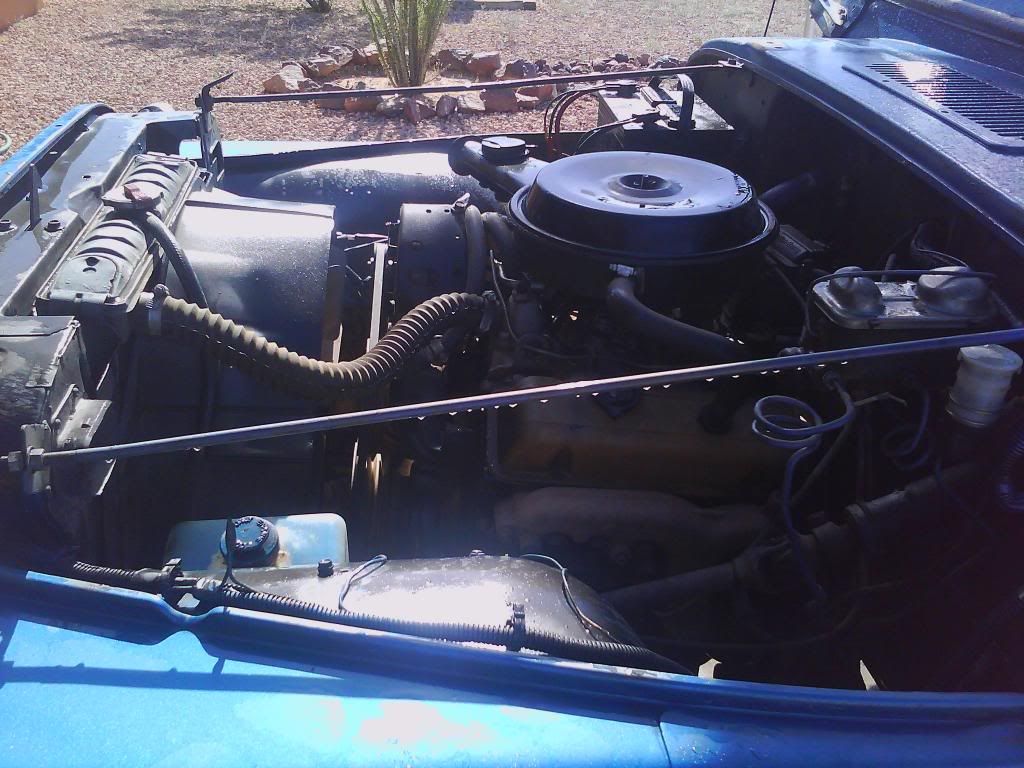

The current engine is a from a 1979 Monte Carlo, it's a small V6 with a Rochester dualjet carburetor (which sucks offroading, because needles won't stay in there seats). It produces a whopping 84 hp. I get about 18 mpg at 55mph. This engine has all the emission stuff and passes every year with flying colors.
The fenders are held on by about 6 bolts and 2 nuts. Three bolts on the firewall two nuts. on the firewall to two braces, on the passenger I had to also remove the battery tray. There are three bolts that attach the fender to the front grill. The top bolt I had to cut off with a hack saw, it was stripped.
The front grill is held on by only one bolt on the bottom center.
After removing the body panels, I washed them, removed left over bolts and screws from days gone by, and put them up.
My radiator was held on to the grill by 4 bolts, now the radiator is sitting by the trash can the grill is with the fenders.
After getting body panels off I started taking off the steering gear box. These bolts were tighter than my ex wife! My gawd, lesson learned though I should have loosened all the bolts and then removed from fram just so something would hold the gear box steady.
I pressure washed and cleaned up the bracket pieces really good. I then primered them and getting them ready to paint black. The steering shaft got a new knuckle to mate to my new power steering gear box.
All in all this took me all morning. I should have the old motor out tomorrow.

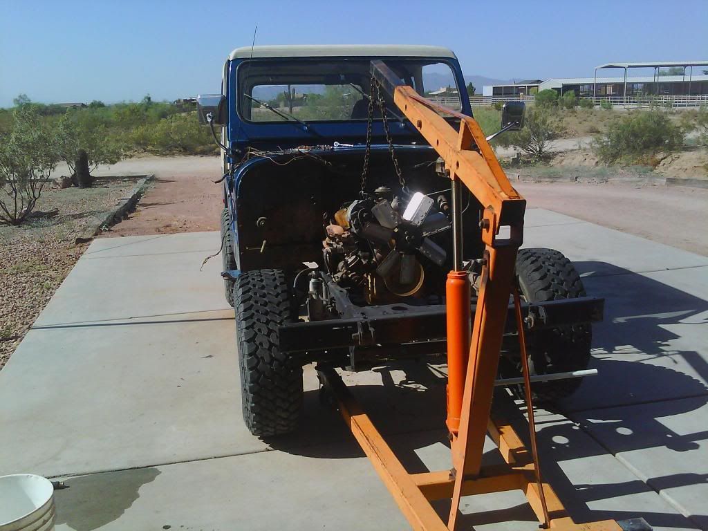

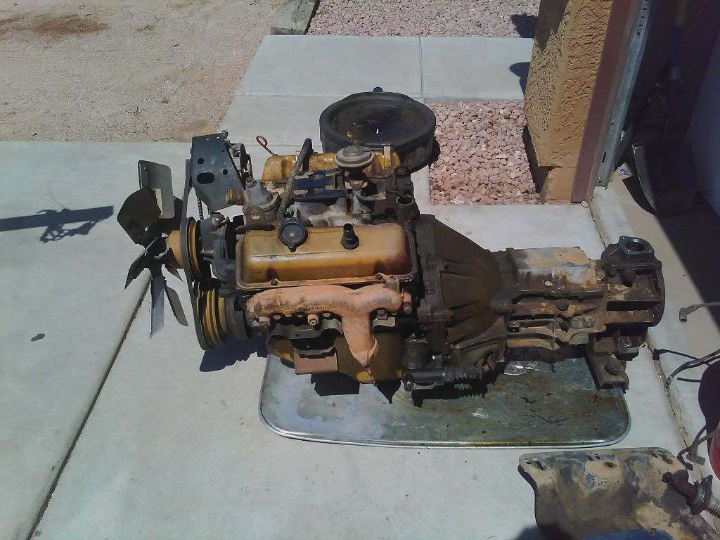

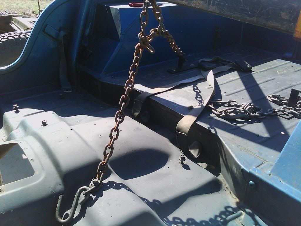

This morning I removed the old v6 from the jeep. It was pretty simple and took me about an hour and a half.
I removed everything connecting the engine to the frame or body of the jeep. Wires, speedo cable, clutch line, and driveshafts and shifters. I moved the hoist
up to the engine hooked the chains added some tension, then unbolted the motor mount bolts, and she slid right out like butter.

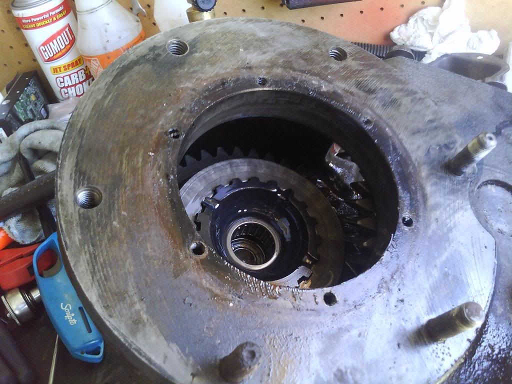

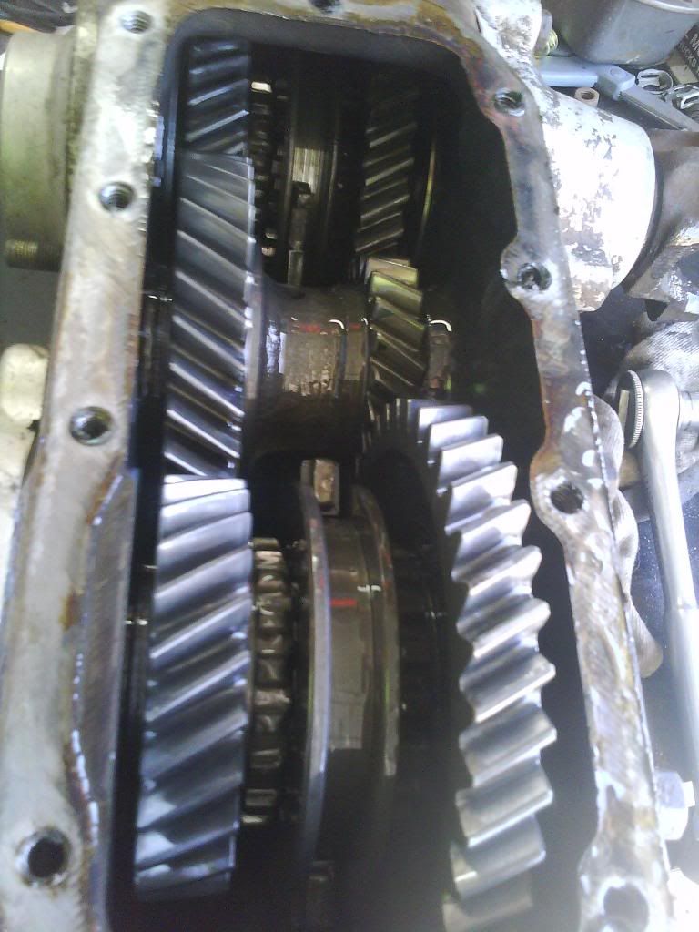

I moved the whole assembly, engine, tranny, and transfer case to my work bench, unbolted the transfer case on my bench and then moved the engine and tranny outside.
Here's the old powertrain. Hopefully I can trade it somebody with skills to build me a roof rack, it'd be a fair trade.
The transfer case is covered in dirt and grime so off to the pressure washer.
The bottom cover was on tight! It's never been off as the original sealant is still on there, holy **** was this on tight.
Once the cover was off I was so happy to see all my gears looking as good as new! woohooo!
I bought the Advance Adapter kit to mate this to the sm465, I went this route instead of Novak because I didn't want to tear my tranny apart
to install a new main shaft, with the AA kit I only need to change out the input shaft. So remove the hex head bolts and then the bearing cover.
Removing this cover was the biggest PITA I have ever seen. It's only held on with these little bolts, and some sticky *** sealant!
I beat and pounded and used a torch on it. I even hammered a razor blade between this cover and the xfer case body. Finally after about an hour or more of
doing this it started to seperate. I used a couple of progressively larger screwdrivers and a hammer to work it loose.
There is no need to remove rear yokes, or anything else to get the input shaft off. So here it sits until I can get a pair of snap ring pliers and the use of a press to

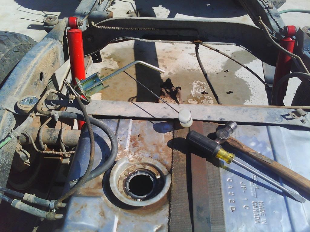

First thing I did was wash all the dirt out of the frame, incredible how much dirt rides around in the frame. Luckily for me, I live in about 6% humidity, so no rust. I pulled out my stock sending unit.

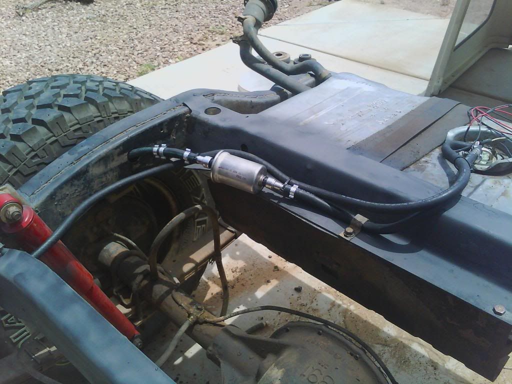

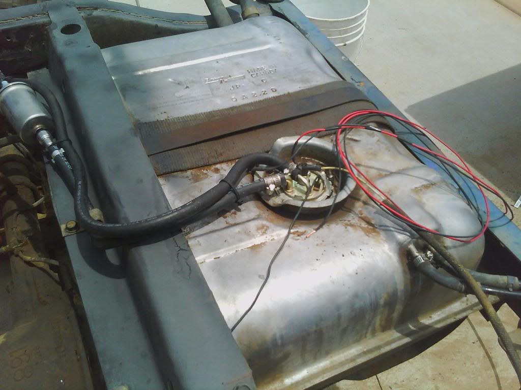

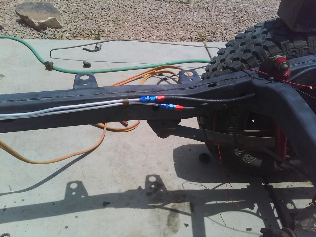

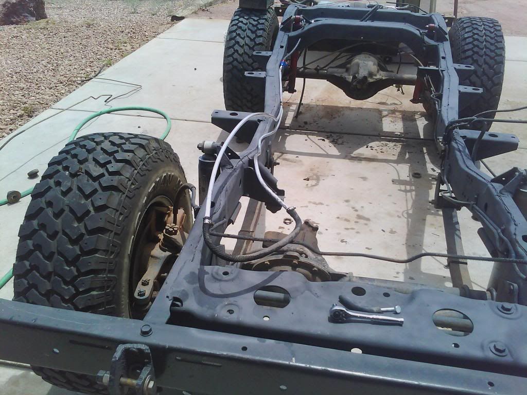

It was a tight fit installing the new in tank fuel pump but finally I got it to go in. The supply side I was able to route through the frame and around the shock mount. I am going to have to put a sleeve or grommit on the frame openings so there is minimal rubbing on the hose.
It took me about an hour and a half to make my fuel lines.

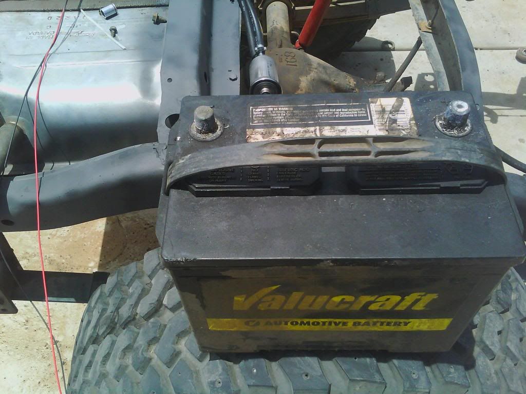

I'm not the fastest worker bee after I finished making my lines I tested the pump and ground by using my old battery to turn on the pump. Initially I used a short peice of rubber hose a couple of hose clamps and bolt to block off the supply line. After about 2 secs the bolt was blown out of the rubber hose and fuel shot about 10 feet into the garage! None of my lines leaked. Next I looped the supply and return line and ran the pump for a few seconds, all was good.

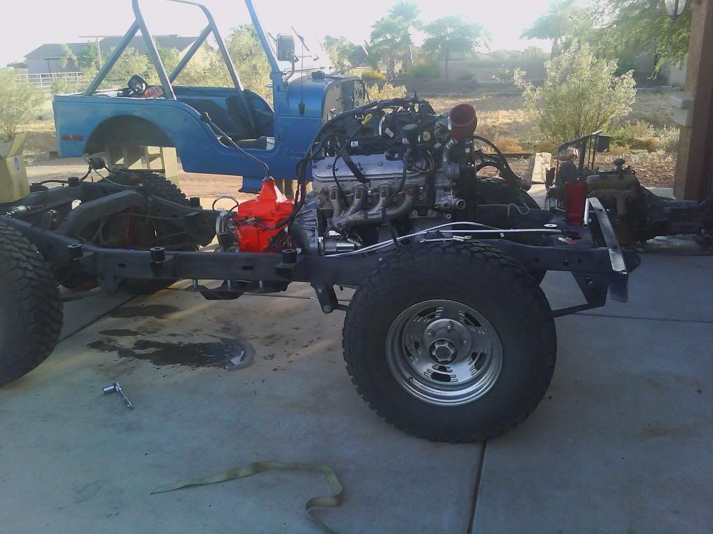

After running my fuel lines, I installed my Novak motor mounts added 1 1/2 inch spacers to my skid plate and installed and brought the engine over and set it in.
After mounting the engine I see there is a problem with the skid plate, the transmission sits a the rear of the plate. I have two options I guess, move the engine forward or move the skid plate rearward about 4 inches. I'm going with moving the skid plate. Also I see that my adapter to skid plate mount is about 4 inches too high. So I'm drilling holes through some 4 in square stock to make up the difference.
From what I can tell this is going to be a really close fit. My biggest doubt is whether or not I'm going to be able to use my stock shifter floor cover. With the transmission sitting as far back as it is on the skid plate I imagine that those 4 inches will translate to the tranny sitting too far back for the cover. I can only guestimate with the body off. However where the engine and bell housing come together it looks right as those peices come together just before the front tub mounts. So I'll update as I go along.

I took some pics of the fuel lines I made. Two days ago all I had to do was make two 8 inch flexible hoses to connect the fuel rail to the flaired 3/8 aluminum fuel line I made. For what ever reason the high pressure side and then the low pressure side weeped fuel. No other connection I made had a leak. At first I thought it was the flairs I was making but after the third attempt of reflairing I realized the leak was actually from the steel braided hose and 3/8 npt connector. Eventually I coated the threads with Yamabond 5 and the leak stopped. I allowed the yamabond to cure for about 3 hours before trying the fuel pump again.
Yesterday I also attempted to start the engine. That didn't go over too well at all. First of all I used an old battery and simply tried using jumper cables to no avail, the fuel pump came on and stuff on the intake clicked but the engine just slowly turned over. So today I bought a new battery and some toggle switches and a push button starter. I'll wire it all in tomorrow, put some more grounds from block to frame closer to the starter recheck my fuse block connections and give it another whirl. Today was a wasted day as I was in Tucson all day and didn't get a chance to work on the jeep. On the good news side. I was able to sell my jeep hardtop for 400 bucks and a new Flex-a-lite dual fan setup with controller box. That was definitely a good score. I am also about to unload my v6 engine to a coworker in exchange for steel cargo basket. Another score.
